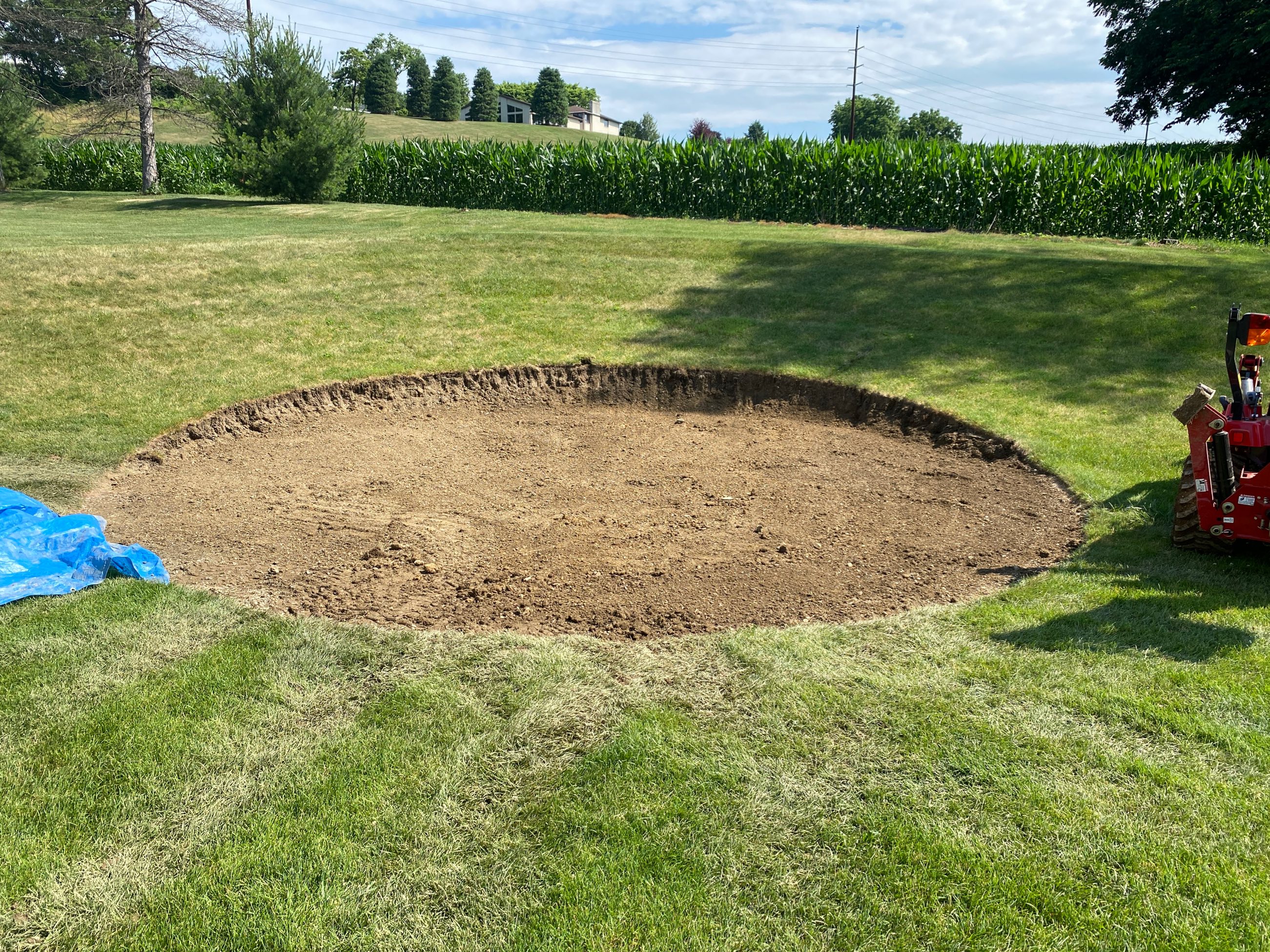

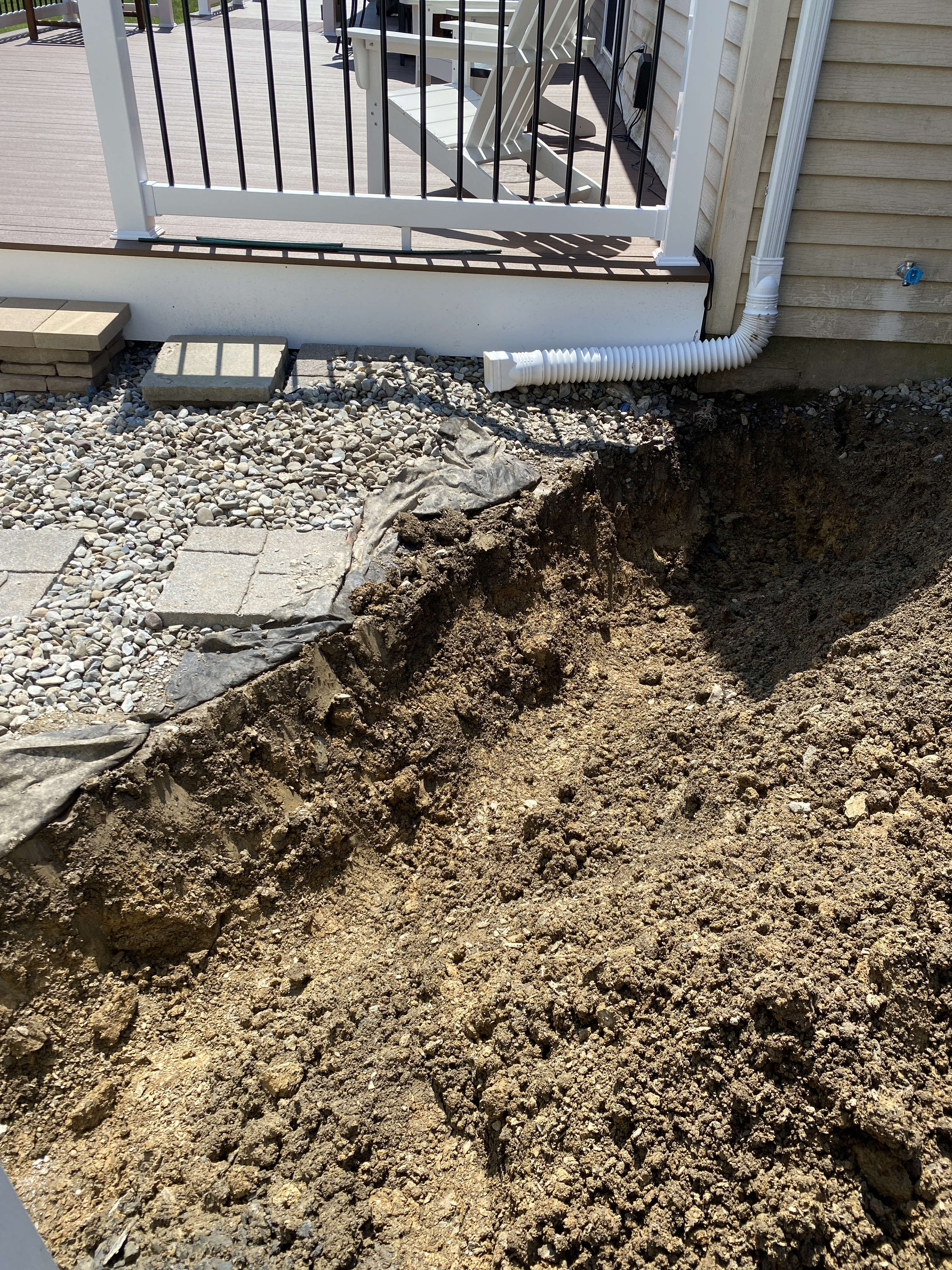

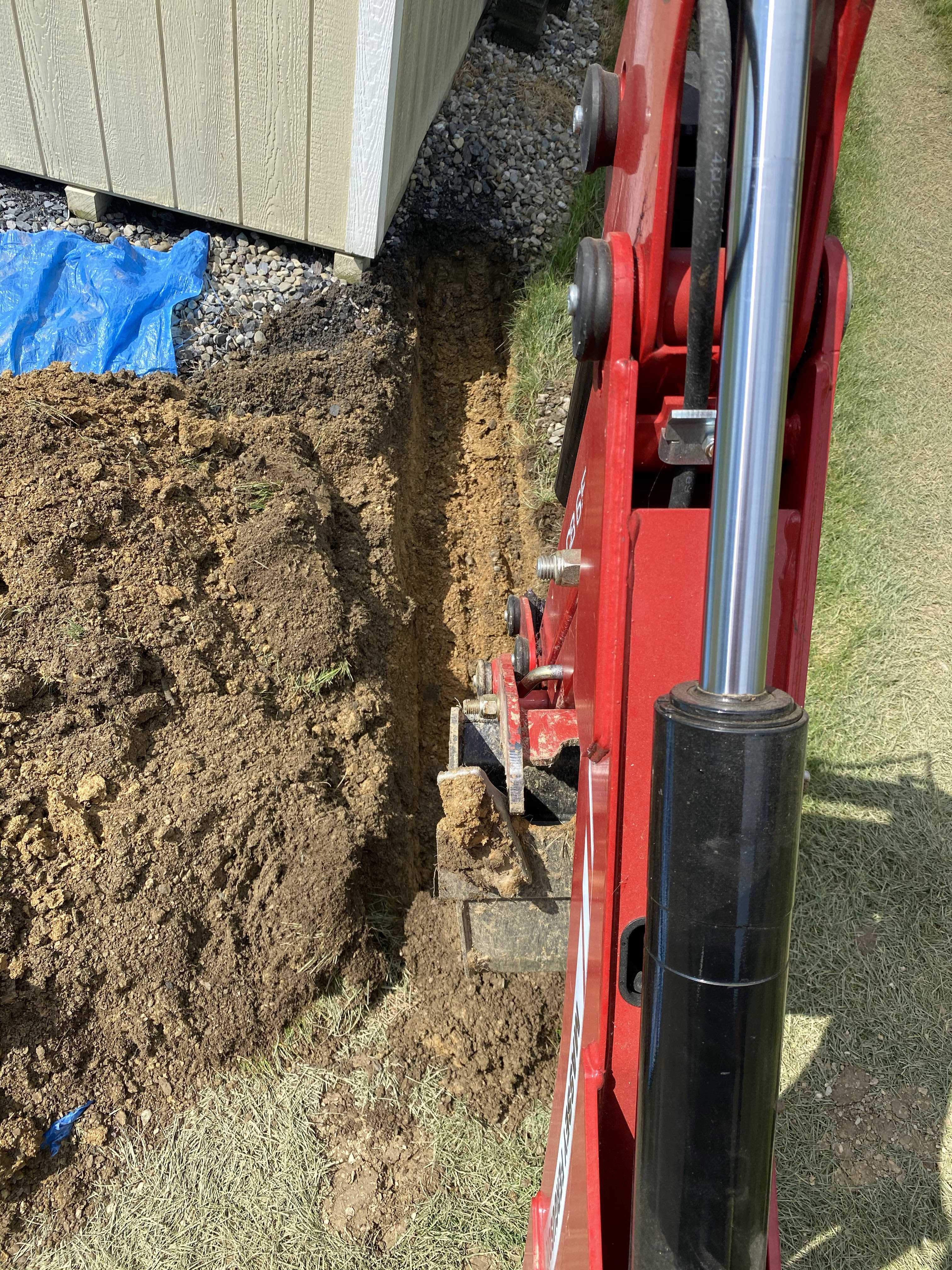

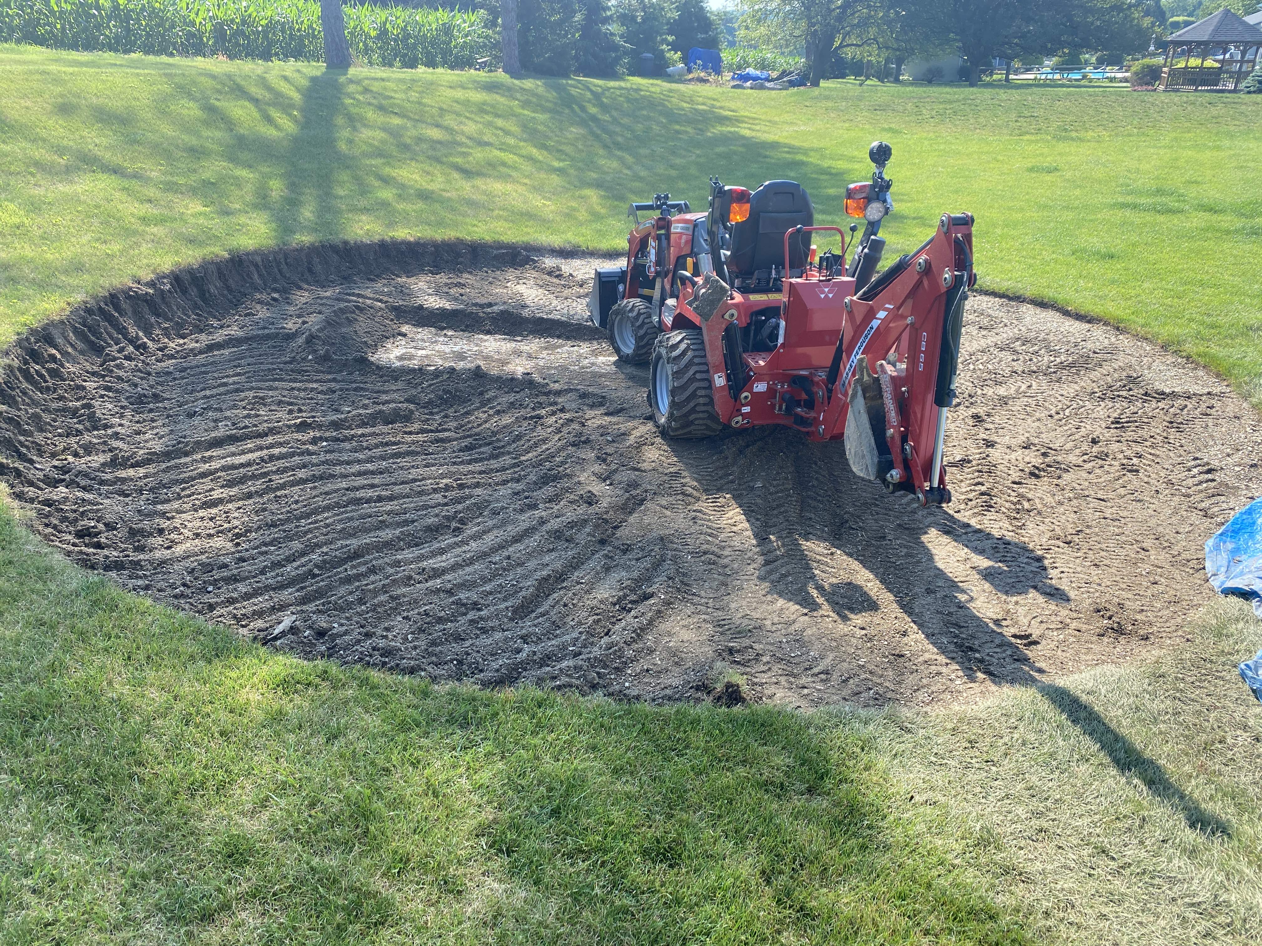

Another pool job today, excavate and level, along with trenching for electrical.
61539604823__332F54F8-7CE3-44B7-87F1-D50C048BF20A.JPGIMG_0388.JPG61539199846__41B5916F-478A-40A2-8959-9295FA56D826.JPGIMG_0385.JPG

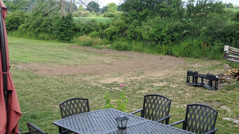

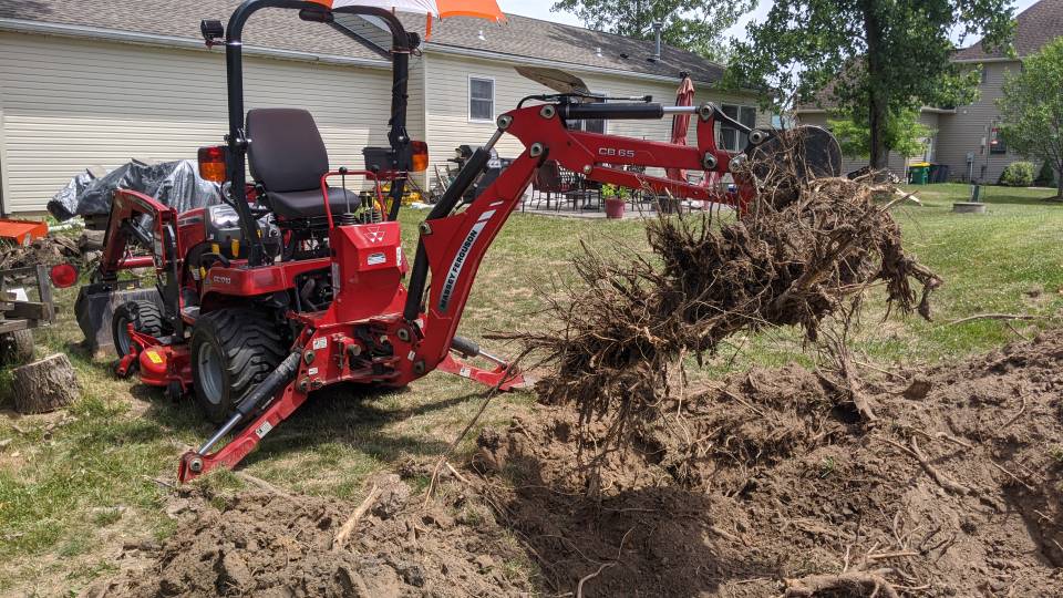

Spent some time stumping today. 3 stumps all 18" or less. The soil here is absolutely dry as can be so getting into it was hard but it broke up/powdered easily. Tossed on the tiller and then the box blade to re-grade the area. Raked it out with my landscape rake by hand... I'll probably work it up and plant seed when it cools and we get some rain. It's going to be over 90 degrees for the next several days and there no moisture 2ft deep in the ground so no use wasting time trying to get grass to take.View attachment 662275IMG_20200705_134548.jpg
   / What have you done with/to your GC Series 2300, 2400, 1700 Tractor TODAY #440
Here's what the final product looking like. There were 4 stumps removed from the newly groomed areaIMG_20200706_083016.jpg
