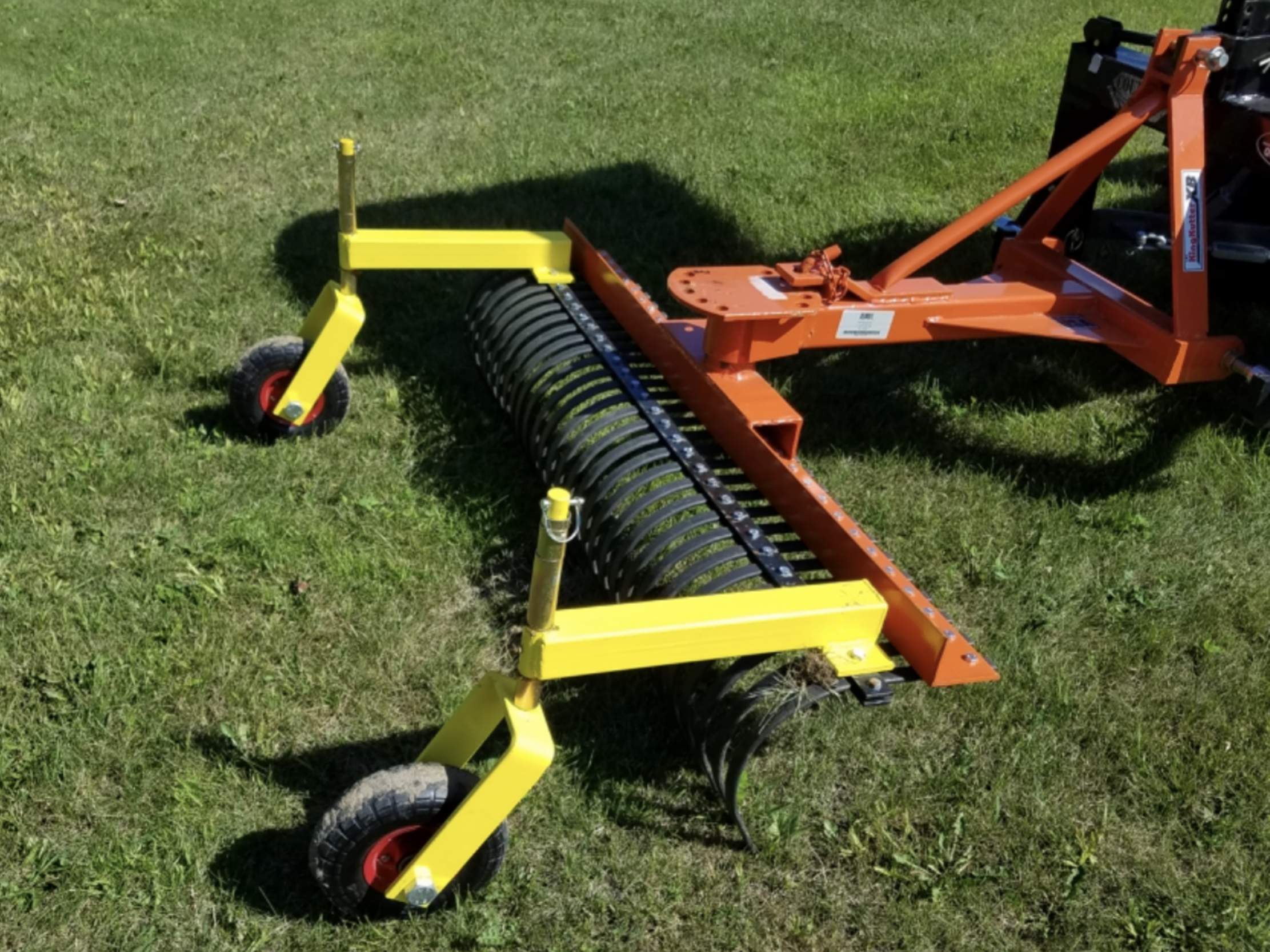

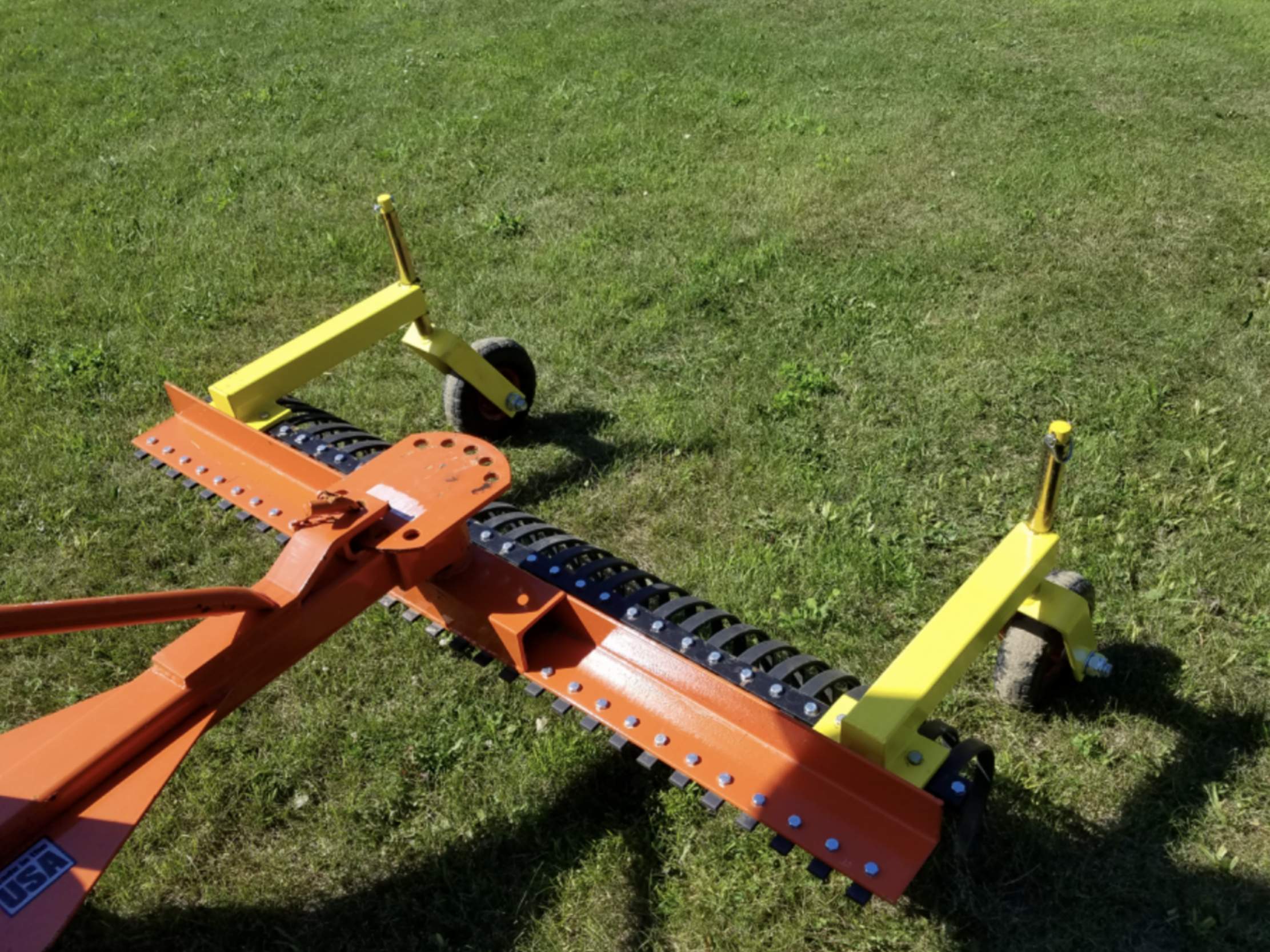

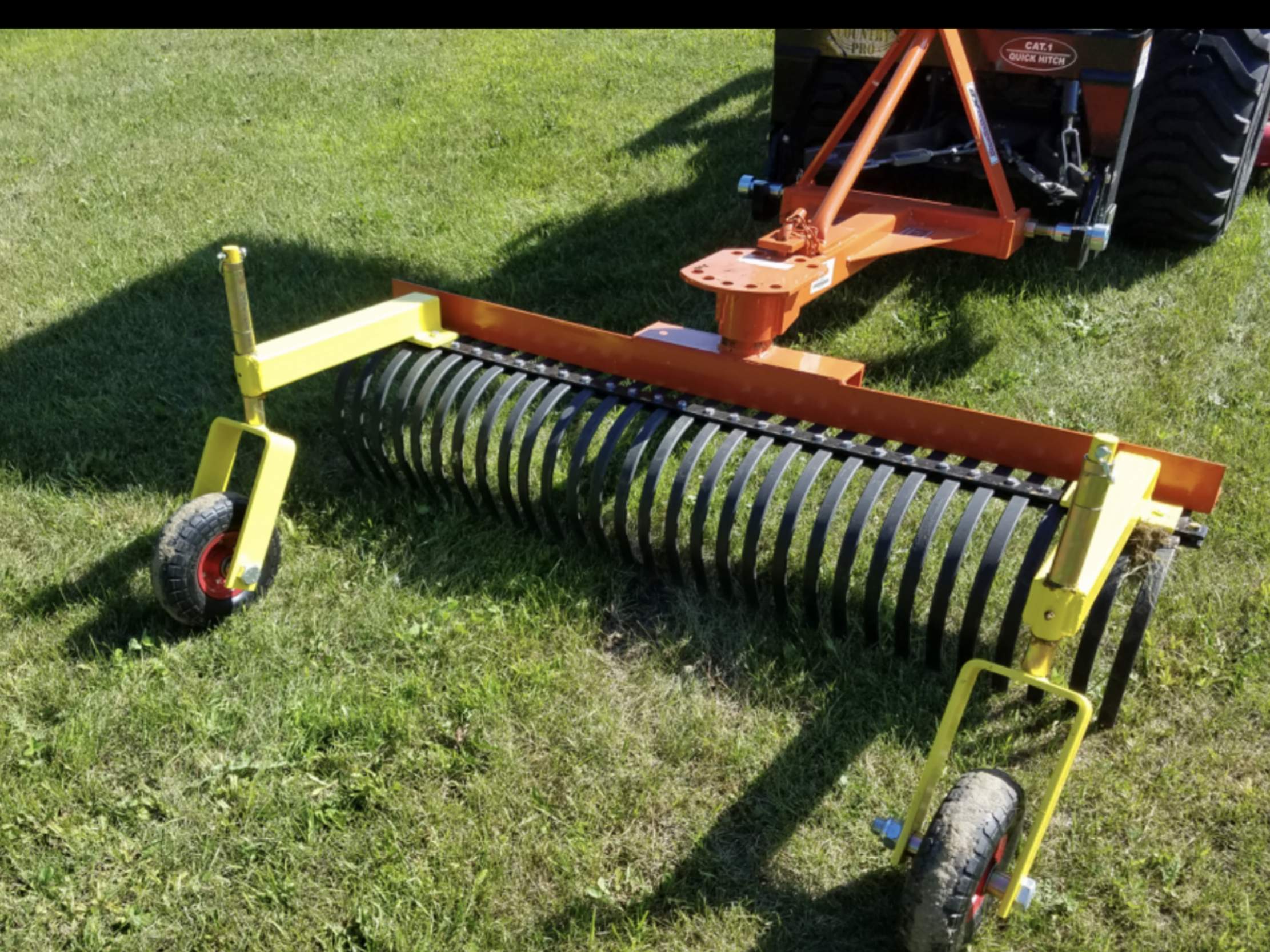

I went out today and played around with the bushings for adjusting the wheel height, right now when I put the 3 point down it just barely scrapes the gravel on driveway and in the lawn it pulls a lot nicer, before putting the wheels on it was such a headache trying to get the tines set just right being the 3 point does not adjust the best but now I can just drop the rake down and go and not worry if they are going to dig in, I still need to make some final adjustments to the 3 point itself to get it just right then I will be set. I think it was worth the 204.00 dollars and also they seem to be pretty heavy duty.

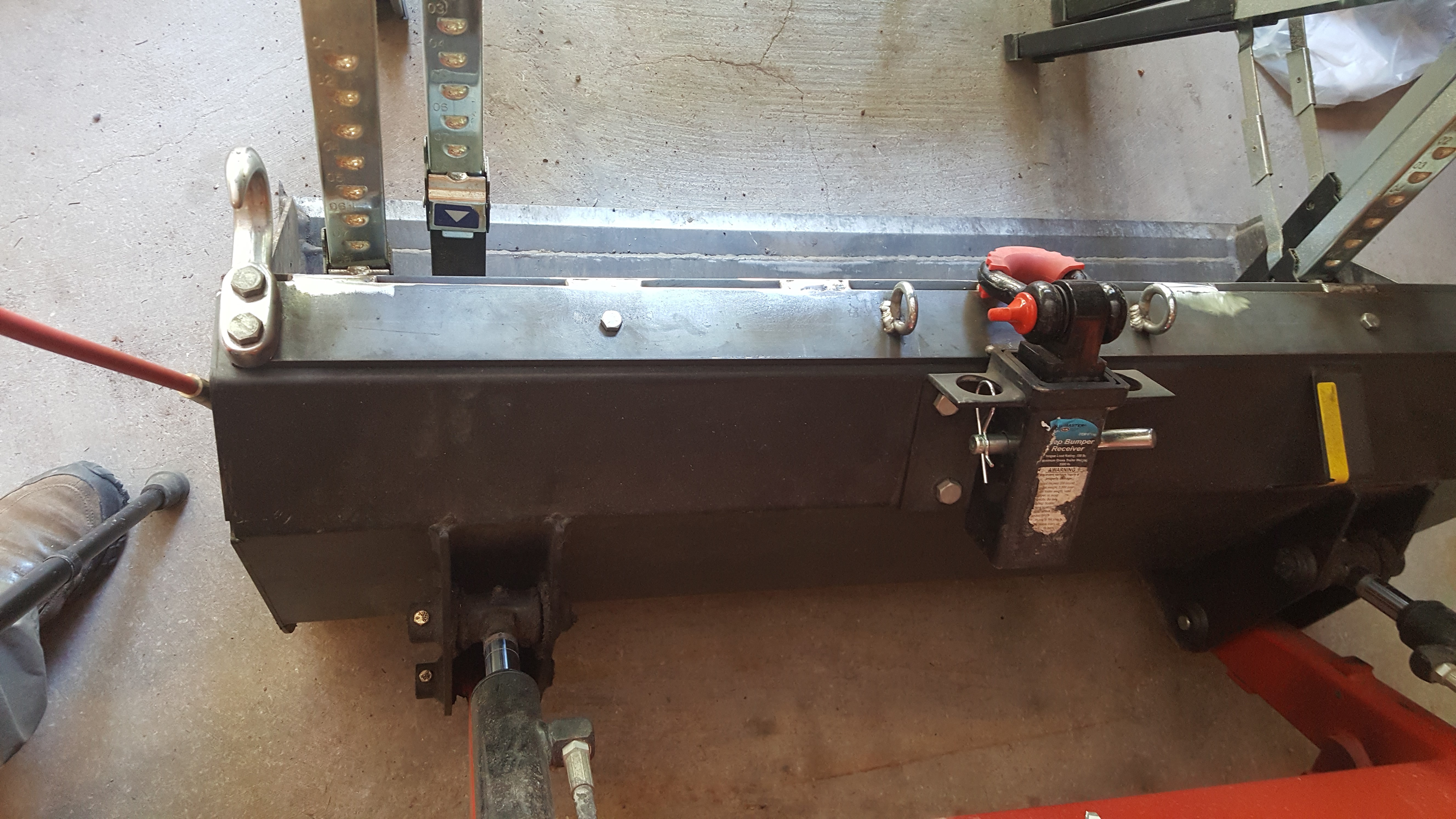

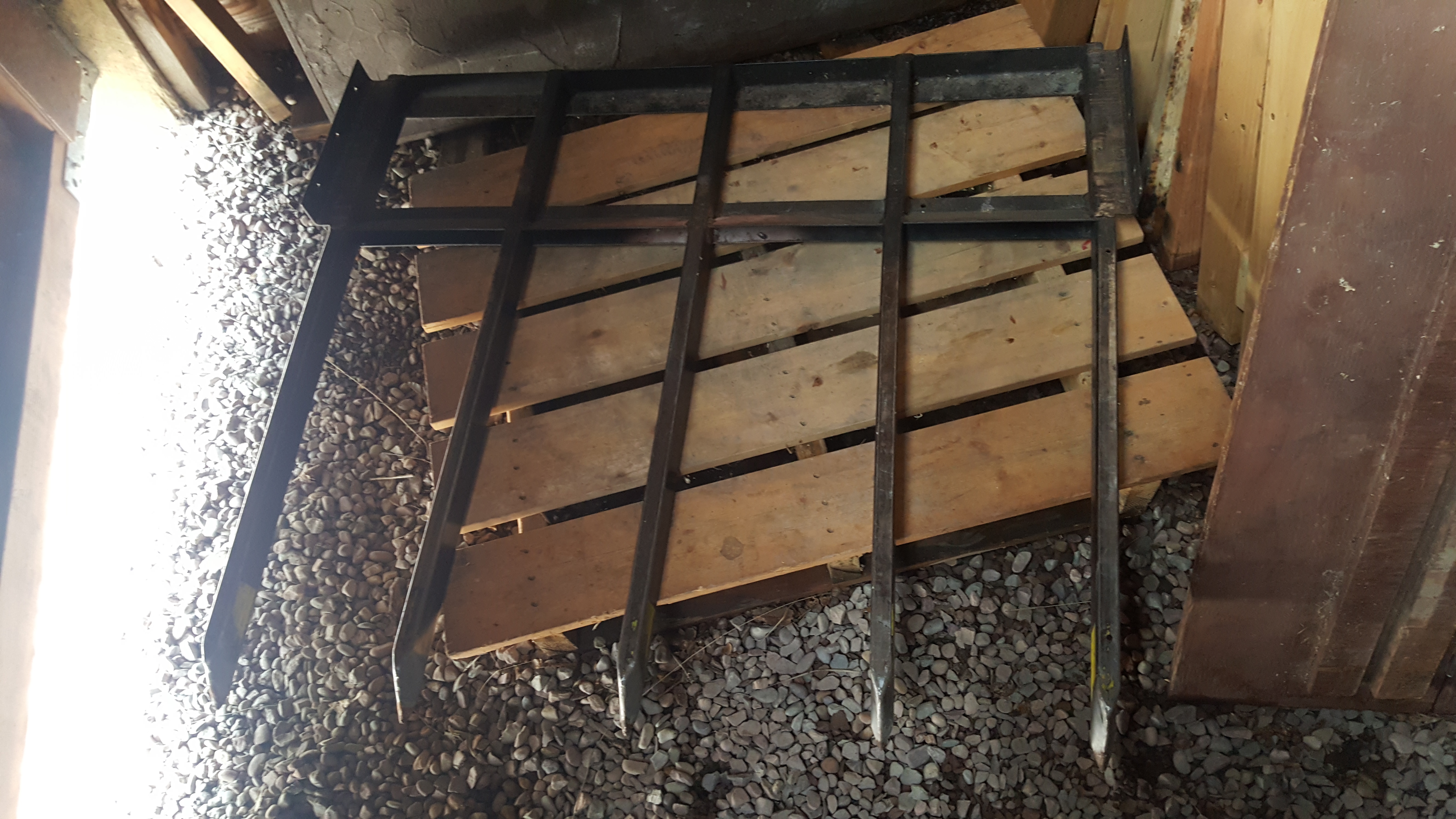

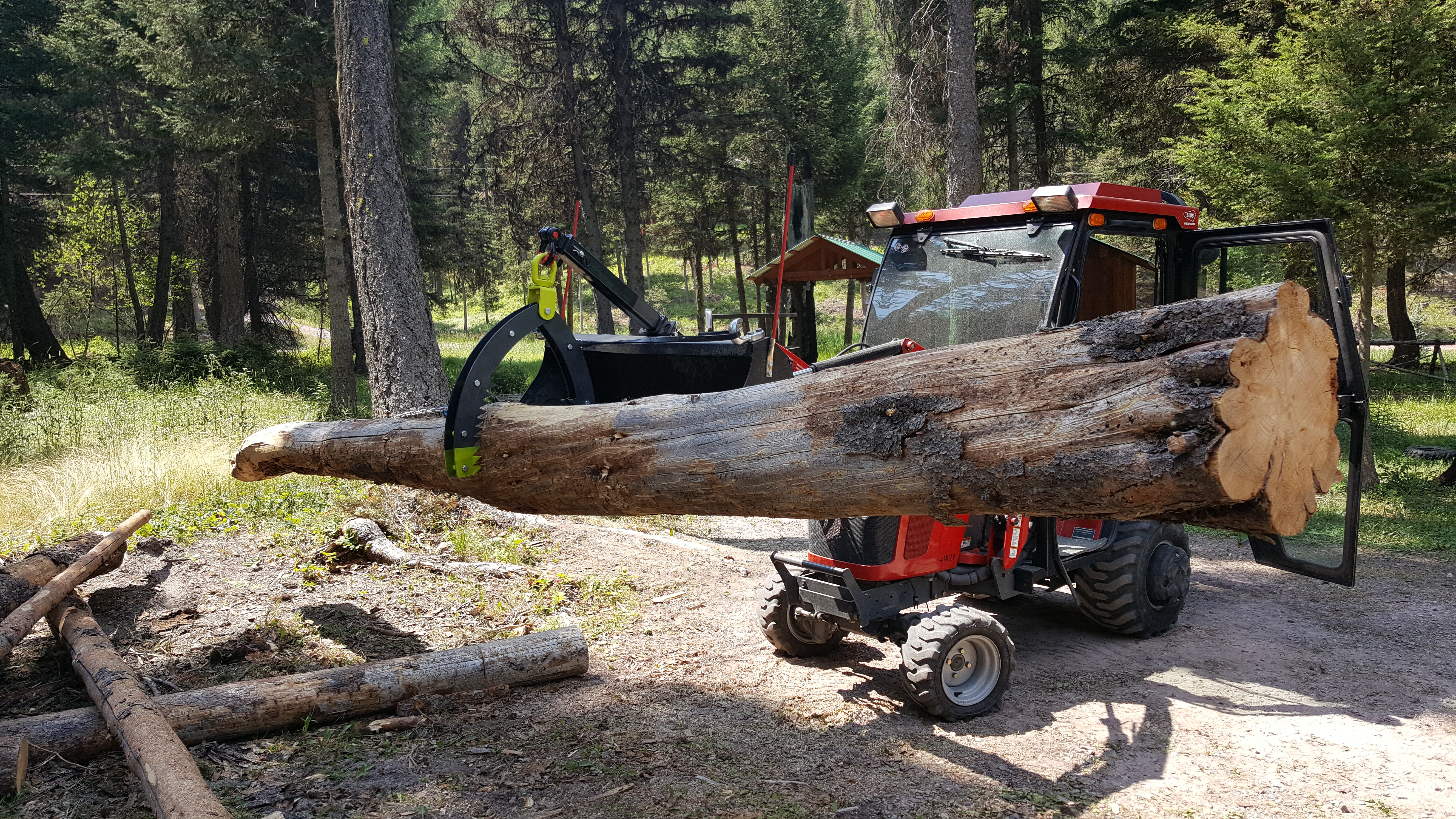

The last few days I finally got around to realigning the ends of my brush forks, and reinforcement of the top of the FEL bucket.
My brush forks were needing a tune up as it was difficult to pick up a pile of tree branches, 1 of the 5 forks was about 2" higher at the end of the forks, and 2 of the 5 forks was about 1" lower at the ends, as they got misaligned over about 8 years due to operator error, as tree roots are so close to the surface.
I cut the forks near the bucket, notched the 2 forks that were low and lined up the ends of the forks and welded them in that position, and now they are like new again...

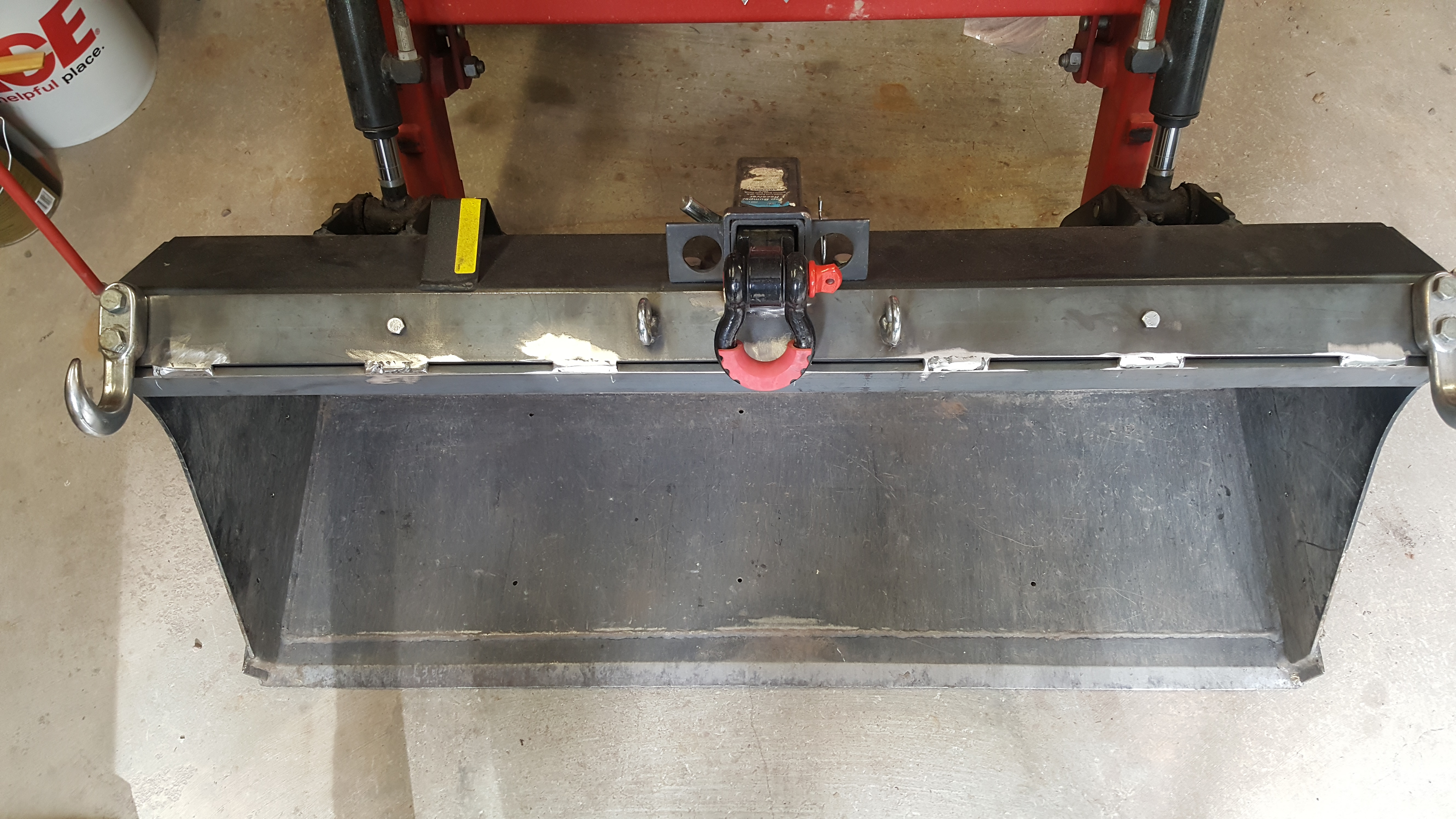

The next day I reinforced the top of the FEL bucket with 2.5" x 3/8" flat bar, and 1.5" x 3/8" flat bar because I was concerned the bucket would slightly flex when I picked up 18' logs to be cut up for firewood, this month having a logging truck delivery of firewood logs.
Pics are of brush forks, 18' log being moved with FEL, top of FEL bucket being reinforced, & bucket reinforcement completed waiting for some black paint.
KC
View attachment 663121 View attachment 663122 View attachment 663123 View attachment 663124
Very nice. I'm confused by your receiver hitch tube, so is it welded on an angle or to the backside of the bucket?

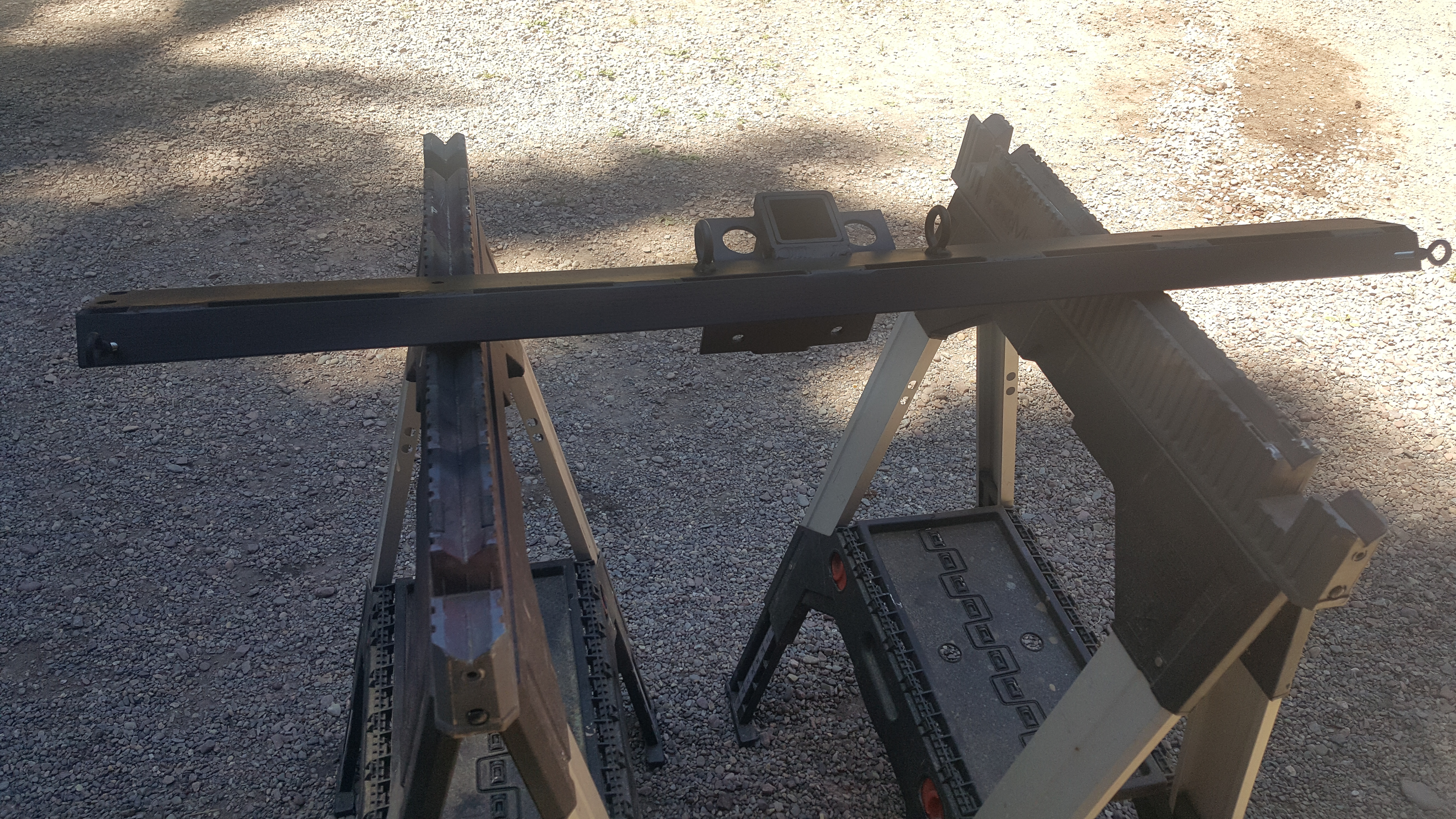

The HF receiver hitch is thru bolted to the bucket with four 1/2" bolts, and when I added the 2 pieces of 3/8" flat bar to reinforce the top of the bucket I just welded the edge of the flat bar to the bottom (front) of the receiver hitch.
The complete assembly can be removed from the bucket if necessary, see pic below on the saw horses for painting.
Hope this clears things up somewhat,
KC

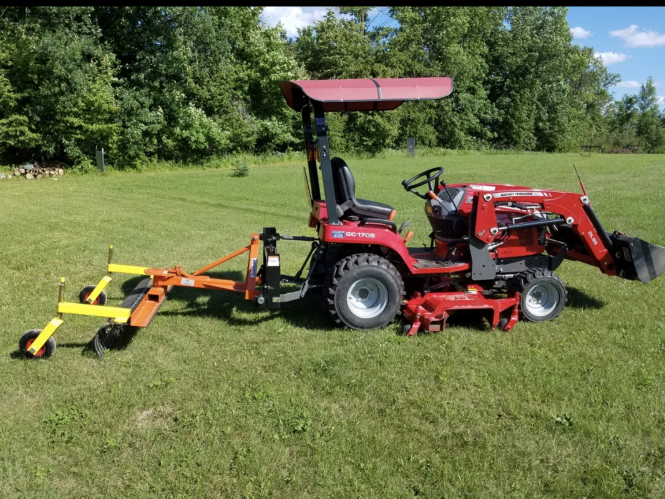

Some pics of land rake with wheels on. Now I am on the hunt for a 48 inch tiller.

Should add that I need to shorten the top link so the rake tines do not bit in so much, I had it short and it worked fine when I dragged it across the yard but then I extended it out to see what would happen and it put the tines in more of a aggressive angle. I am dragging it across my yard to knock down the little dirt mounds to make it smother, The area is a little bit bigger then a acre where I have this issue rest of yard is ok.
KC
View attachment 663358 View attachment 663359
Ah ok, yeh that's pretty smart!
