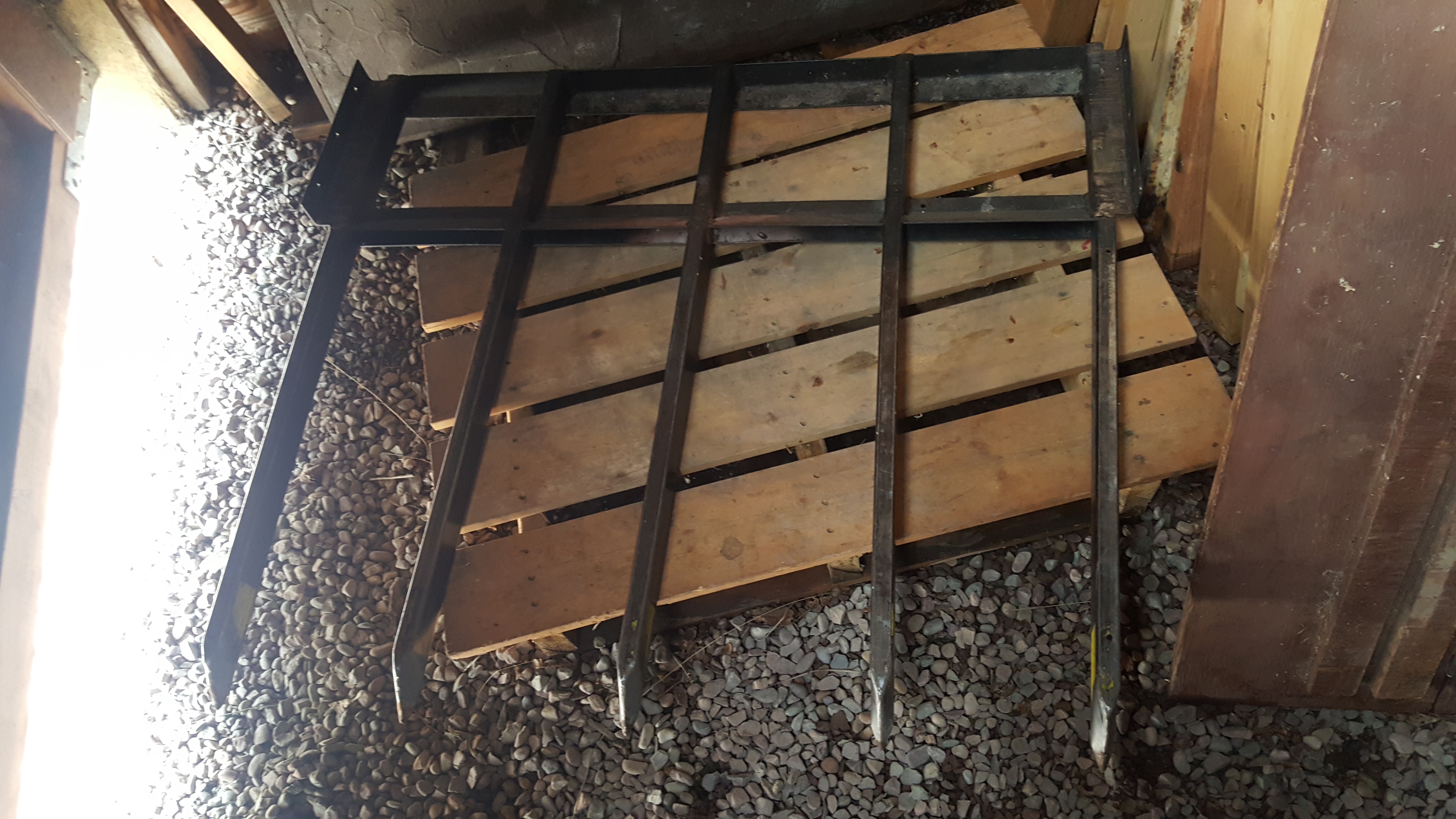

The last few days I finally got around to realigning the ends of my brush forks, and reinforcement of the top of the FEL bucket.
My brush forks were needing a tune up as it was difficult to pick up a pile of tree branches, 1 of the 5 forks was about 2" higher at the end of the forks, and 2 of the 5 forks was about 1" lower at the ends, as they got misaligned over about 8 years due to operator error, as tree roots are so close to the surface.
I cut the forks near the bucket, notched the 2 forks that were low and lined up the ends of the forks and welded them in that position, and now they are like new again...

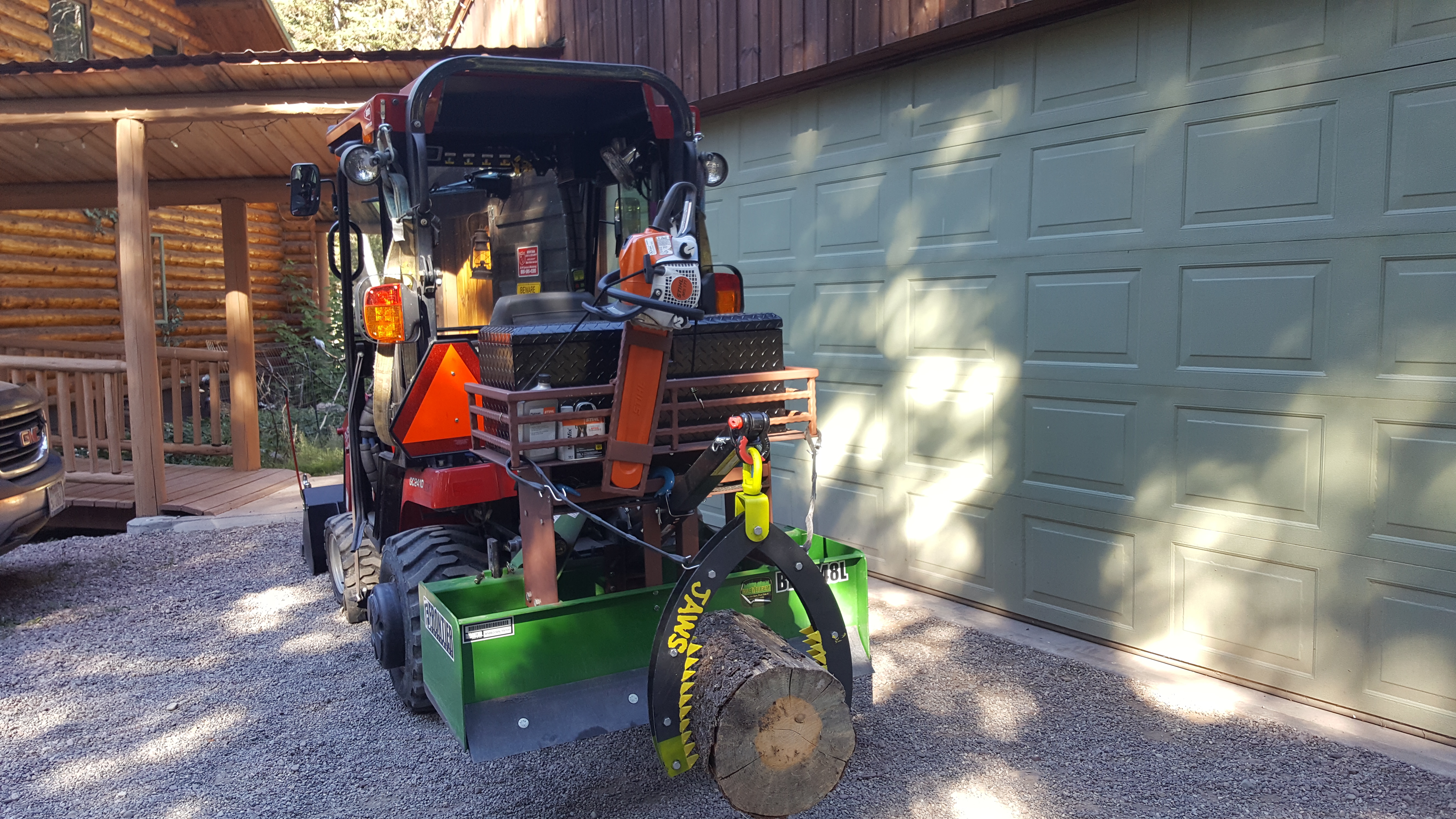

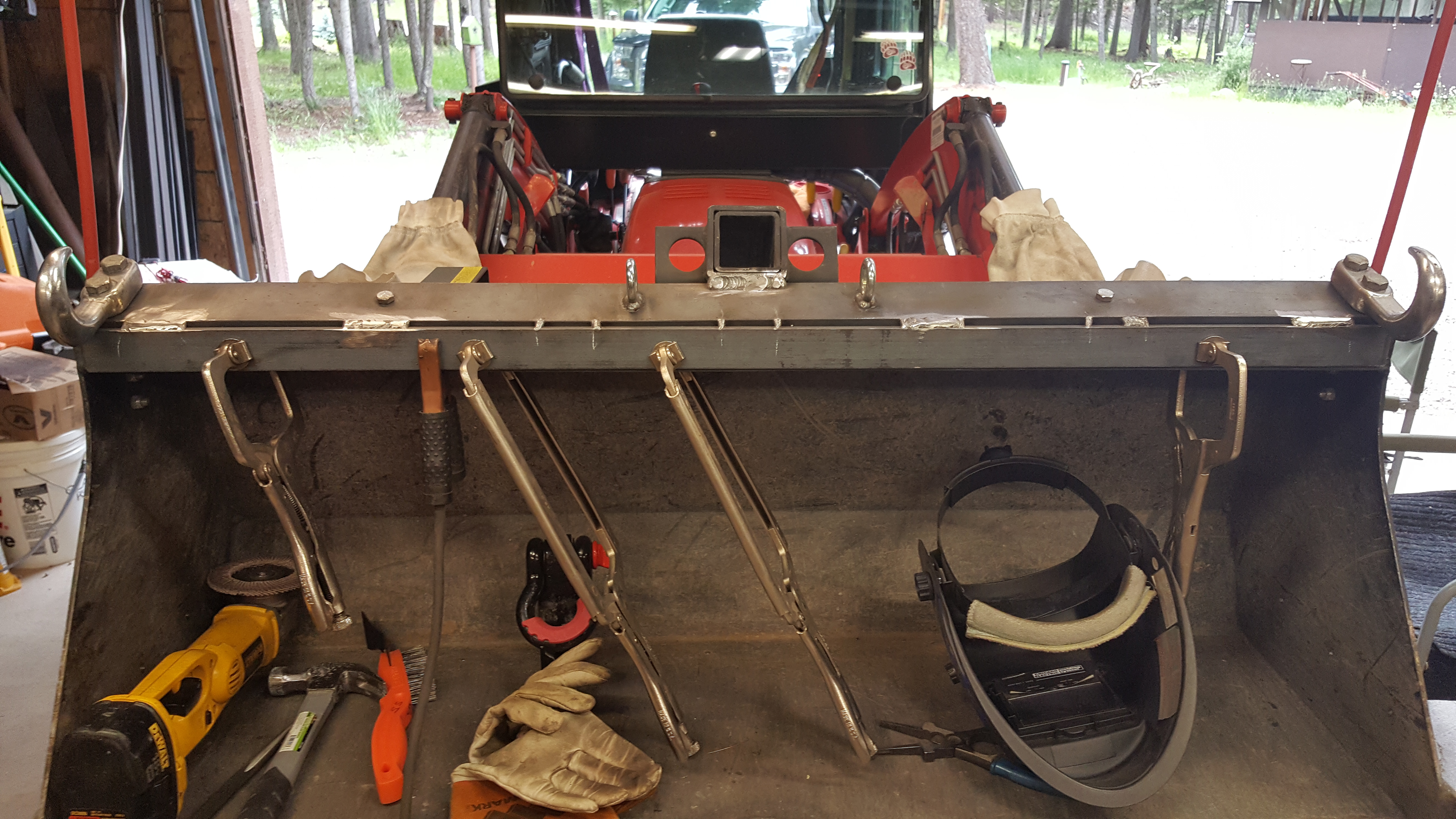

The next day I reinforced the top of the FEL bucket with 2.5" x 3/8" flat bar, and 1.5" x 3/8" flat bar because I was concerned the bucket would slightly flex when I picked up 18' logs to be cut up for firewood, this month having a logging truck delivery of firewood logs.
Pics are of brush forks, 18' log being moved with FEL, top of FEL bucket being reinforced, & bucket reinforcement completed waiting for some black paint.

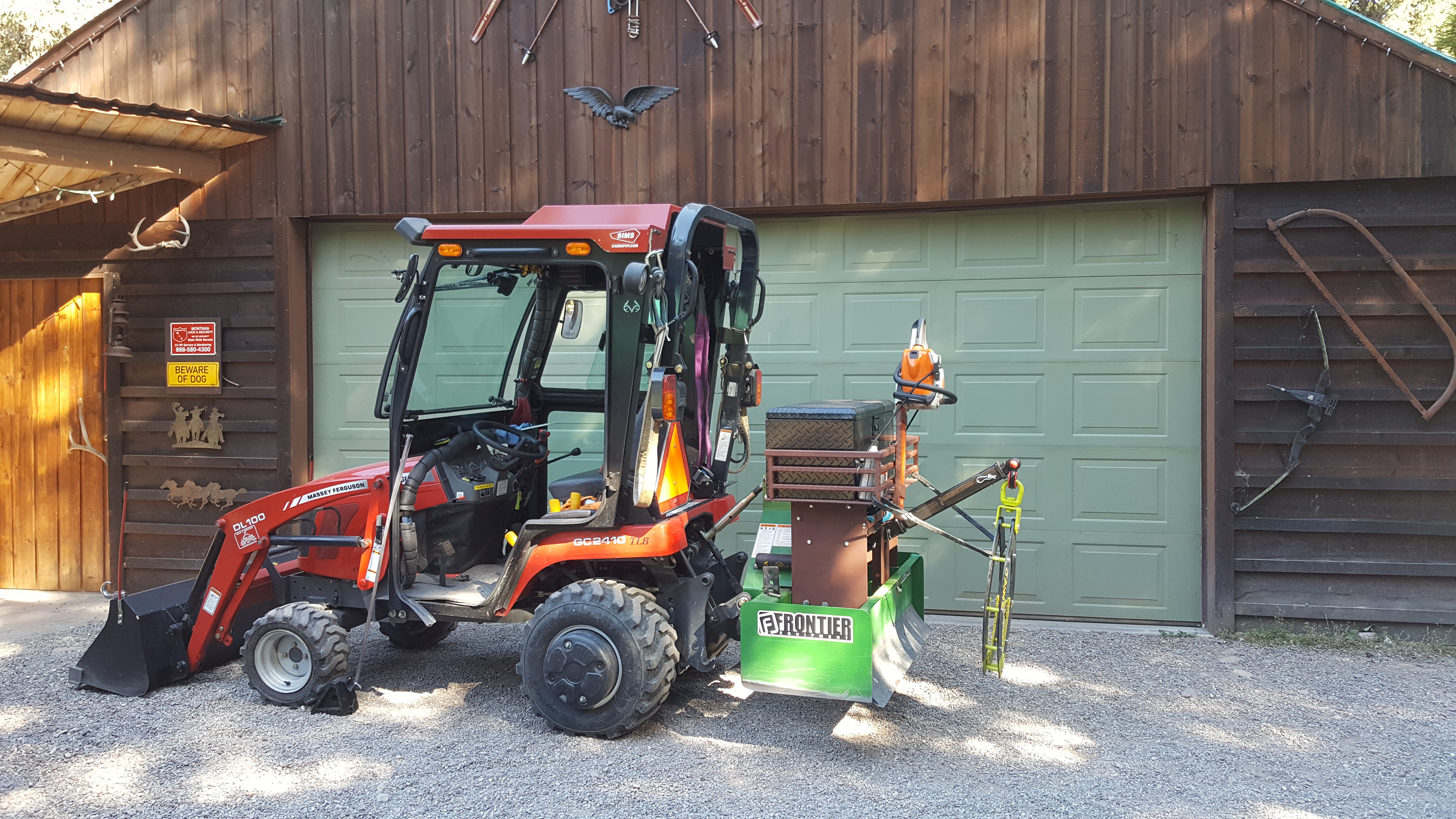

Nice mod MF. That tree seems like it'd tip the tractor forward with out any hoe but you do have the rear weights.

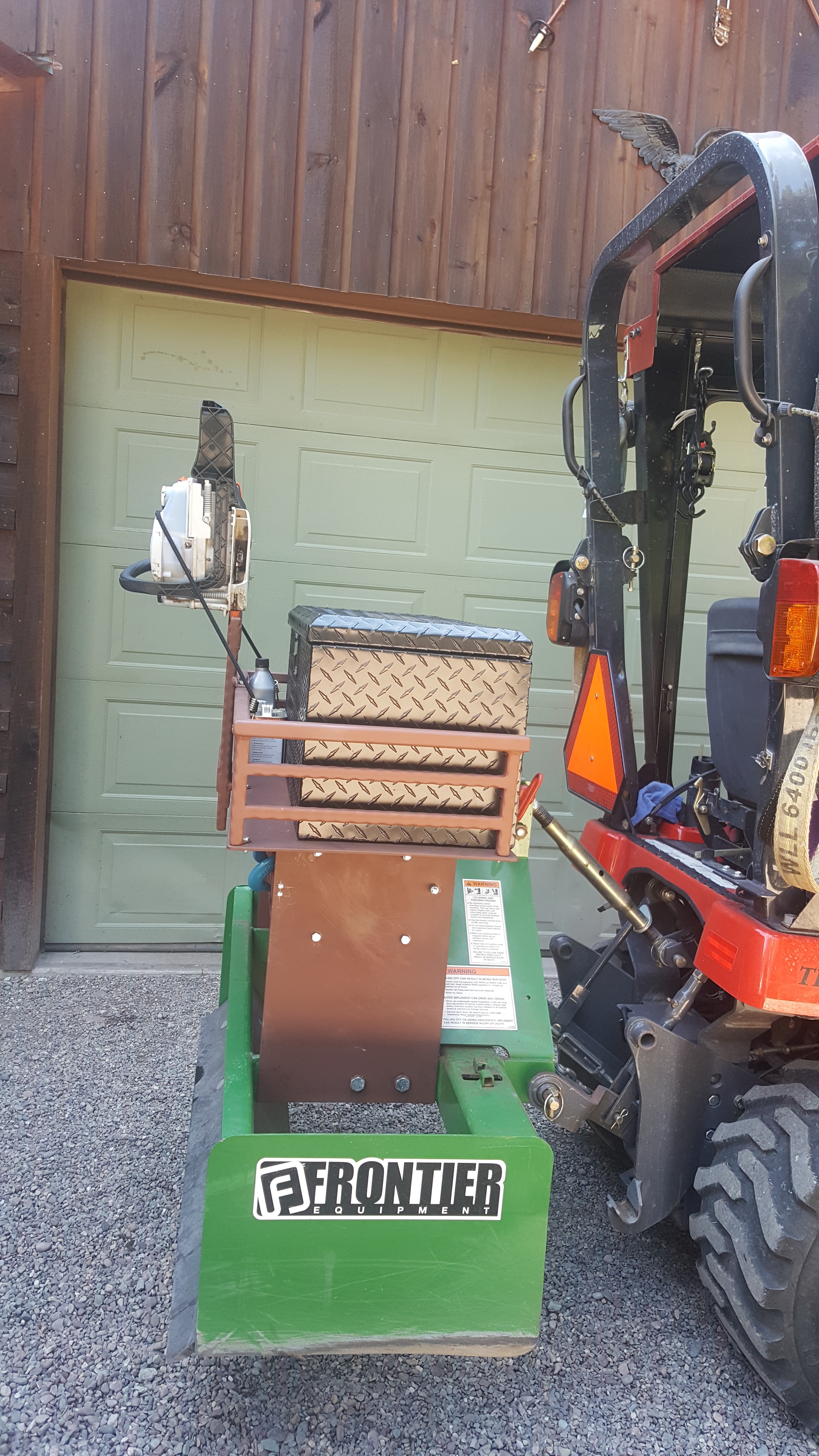

Thanks, also I do have a 4' box blade installed in the pic, hard to see with the door of the cab opened and the green grass because the box blade is "John Deere Green".
Last year I also add some extra weight to the box blade with a 1/4" plate platform/ATV storage box/chain saw holder which really improves smoothing out the road mix gravel on the driveway.
With the aluminum storage box, it's nice not to return to the garage to get items I need to clean up the property.
KC

Thanks, I did notice the rear end somewhat light picking up the 18' logs even with loaded back tires/wheel rim weights/and the 4' box blade install, so after cutting up all of the logs I added some extra weight to the top of the box blade (see post #465 above).
I have another load of logs coming this month, so I believe the tractors rear end if not going to be on the light side this year.
KC
KC
KC
Yes mine was very light when I moved the 4-20 footers. If i didnt have it in 4x4 it wouldn't move forward because the rear tires didn't have much traction. i dont have mine loaded, was thinking of getting wheel weights like yours.
