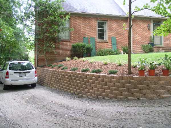

Hi DMF, What is the approximate cost per block. I looked at blocks like yours locally and they are $7.00 each. The units in this wall are from Lowes and cost $2.00 ea. This is about as high as you can stack them because of their weight. I need to build a wall about the size of yours next. 6k for the blocks along is a killer.
   / What I did on my summer vacation
#30
shaley - First of all, nice wall! I don't have the exact numbers here with me but I had 9 pallets of materials. 8 pallets contained just blocks and that was 60/pallet or 480 blocks. The 9th pallet contained some blocks, 12 corner blocks, and (in theory) enough caps to finish the wall. I also had over 800 clips, several caulking tubes of masonry adhesive (for the caps) and numerous square feet of geo-grid. My total for the materials listed above was just under $3K.
