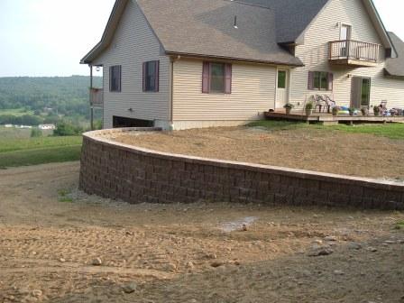

   / What I did on my summer vacation
#42
This is a view from the end of the house showing the entrance to the garage.

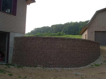

#43
Here is a shot I took last week after work. The last course is complete, and all the backfill is in place. You can see the first pile of caps I started moving.

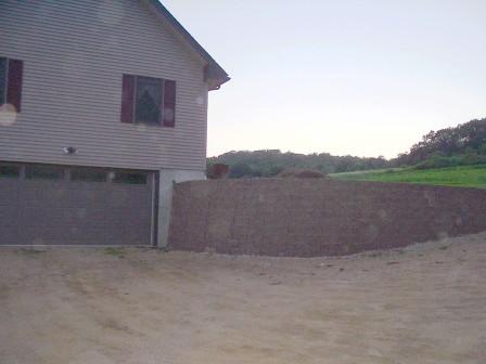

#44
This is the same shot but zoomed in a little. I guess the deer didn’t mind me running Fergy from the pallets to the top of the wall much…

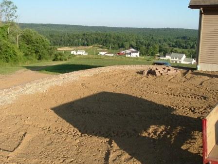

#45
Had to get a shot of Fergy; here she is waiting for me to load her up with caps.
   / What I did on my summer vacation #46
Wicked nice wall there.
The stone backfill makes all the difference in the world in terms of longevity. The wall will be there much longer than it takes your back to recover.
Very nice indeed. Thanks for the pics.
All the best,
Martin
#47
</font><font color="blue" class="small">( Wicked nice wall there.
The stone backfill makes all the difference in the world in terms of longevity. )</font>
Thanks! I used landscape fabric between the stone and the rest of the backfill as much as possible to try to minimize the siltation process. I hope you are right about the longevity!

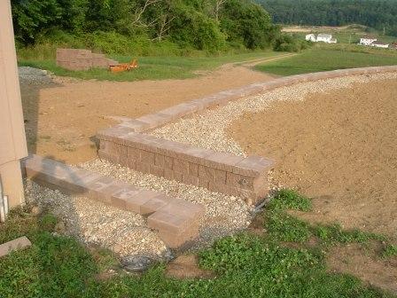

#50
View from below. I used to be able to drive up the driveway and look for deer in the back yard; it’s going to take a while to get used to having the wall there!
