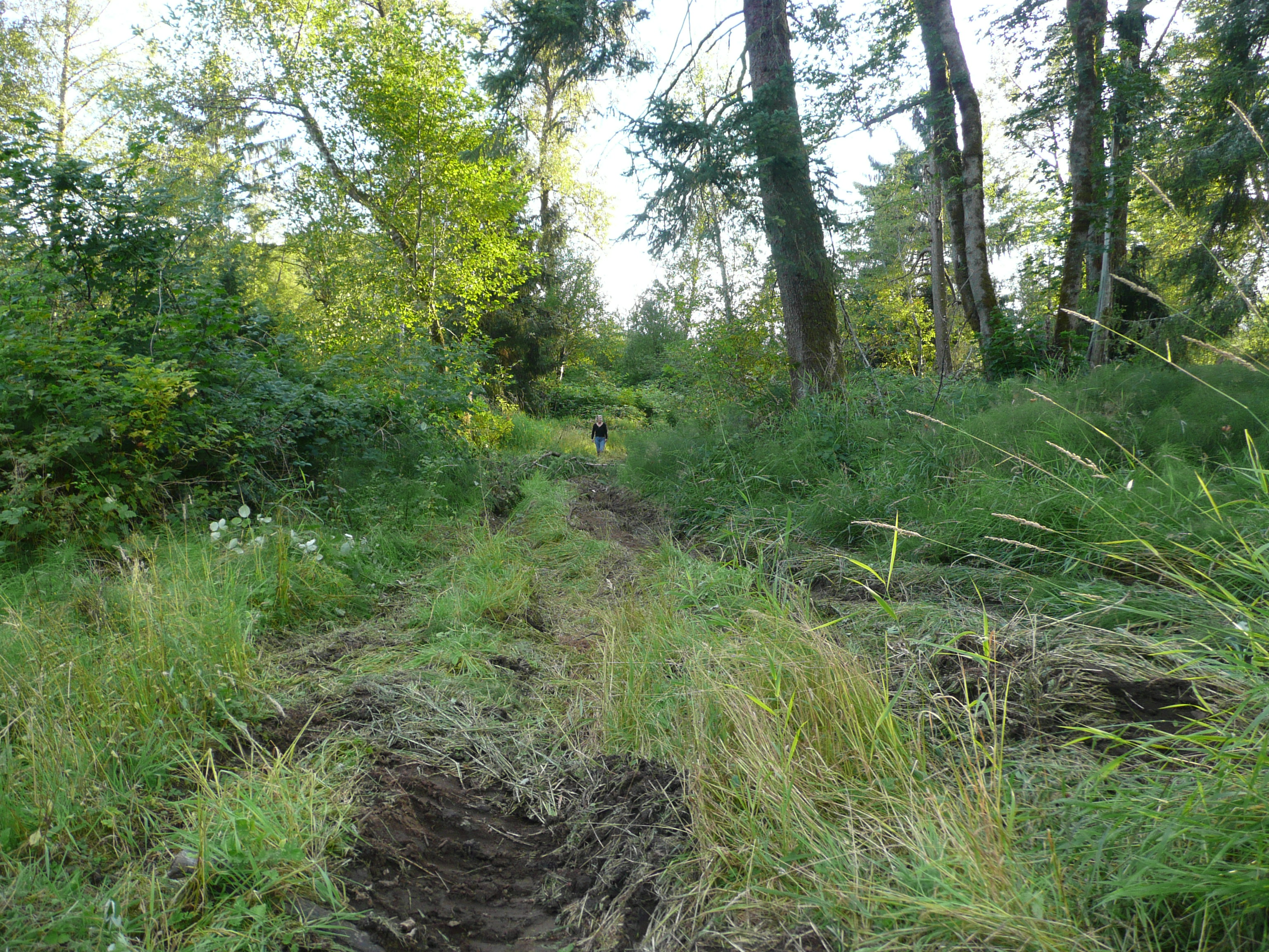

On my property I've dealt with tractor-swallowing ruts from log skidders: OK, tractor didn't disappear, but I once high-centered (with the B7800- ALWAYS cross at an angle, never perpendicular!). Used a box blade with rippers (same B7800); took lots of time but it was worth it.

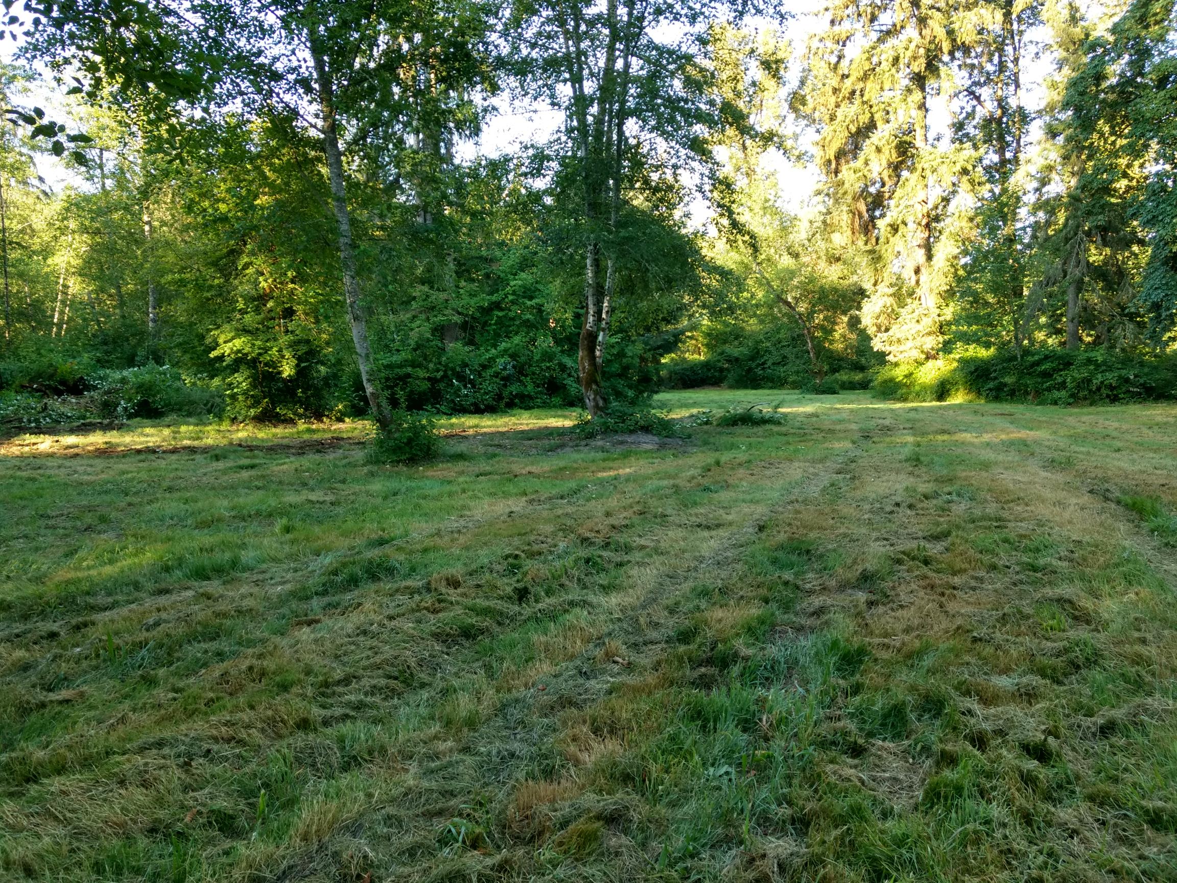

Found a picture of some of the ruts that I've had to deal with (took me several hours but I managed with my B7800 and a 5' boxblade):
What it looks like now (about 8 years later, with lots of other work done):

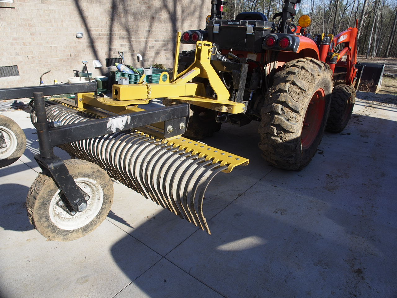

I would likely use my rake to even things out and then back drag with the bucket.
+1. They key is to wait until the ground dries out enough to support the tractor without sinking in but is still workable enough for the implements. I have done a lot of this type of rutting. You may find a good rake is all you need. You most likely will have to make a final pass with a rake when the ground has thoroughly dried for the final smoothing.
This is my 7' rake that works well for everything I have tried, including light box blade type work. With wheels, it weighs 450 - 500 pounds. Wheels are a great help, even with T-N-T.
Everything Attachments Landscape Rake, Root Rake
