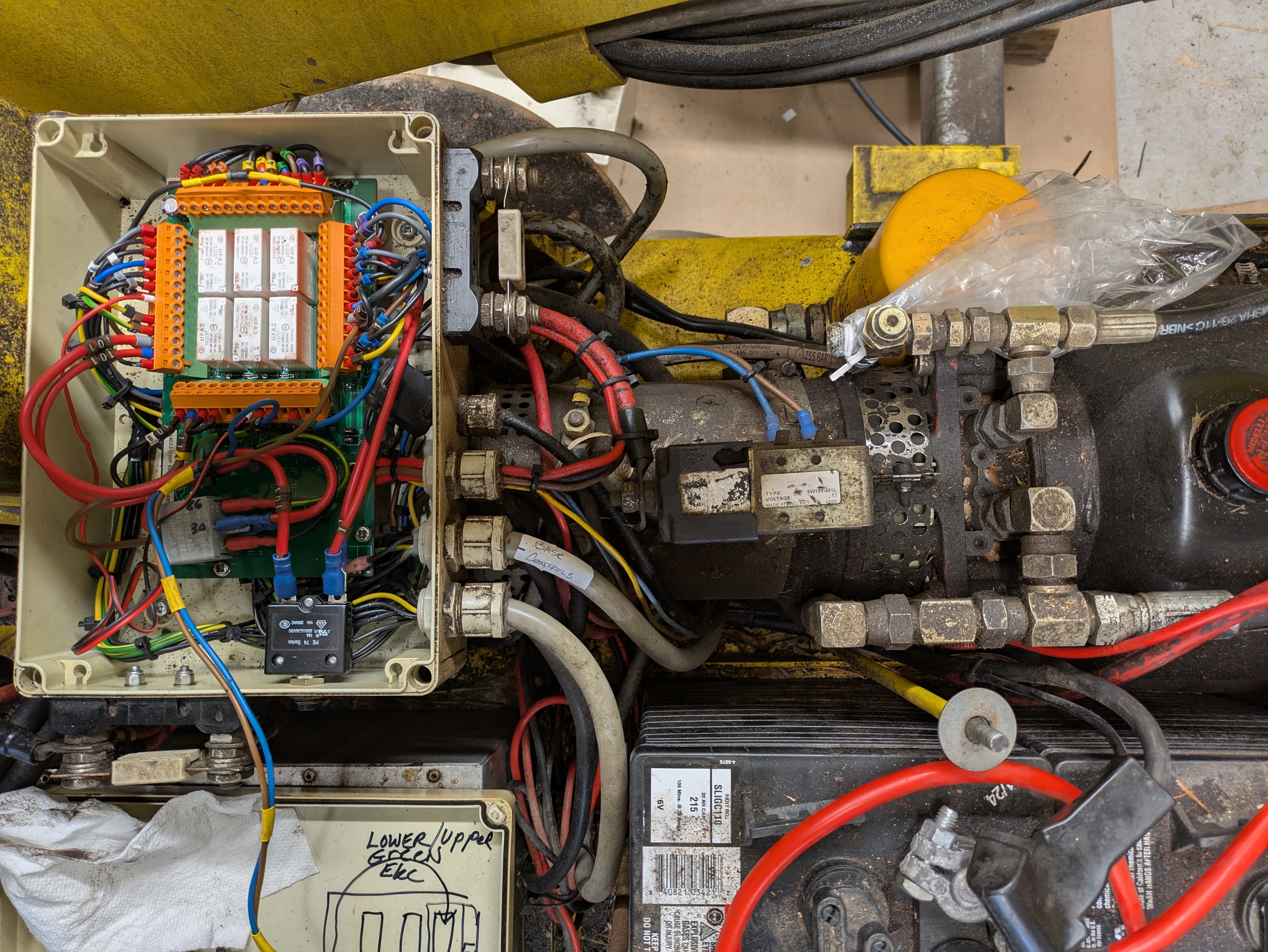

The plot thickens. The flow switch works properly, which means RL7 should be deenergized. But even with the flow switch disconnected from the circuit, connection point 115 in the diagram has 12v, which is inconsistent with the logic diagram. So the problem is starting to look more like a problem on the control circuit board that's causing 12v to be applied to connection 115 all the time. The only thing that interrupts that power is the emergency button, which is also inconsistent with the logic diagram since it implies there is a path around the flow switch to connection 115 that allows the 12v to be interrupted.
Since the system was working and then suddenly stopped, I think it's not likely a wiring problem. I don't see how it can be anything but the control board at this point. A new one costs $250, not the end of the world but a real pain to change all the wires.

Yeah, it's impossible to debug the board because they sprayed the bottom of the board with some kind of insulation to weatherproof it. It's also a multi layer trace so there's no way to figure out which terminals go where. I have the data sheet on the relays but it doesn't really do any good.
Do those orange terminal strips clip to the circuit board or are they permanent connections?
They're soldered then epoxied around the edges.
If you leave RL7 disconnected does the gas engine circuit work properly?
The gas engine works properly without disconnecting or changing anything on the machine. I thought the flow switch was to protect the pump, but looking at the hydraulic diagram I can see its purpose is to prevent both power sources from coming on at the same time. So if the gas engine is running, the DC motor can't turn on. The fact that the system acts like the flow switch is closed all the time doesn't affect the operation of the gas engine.

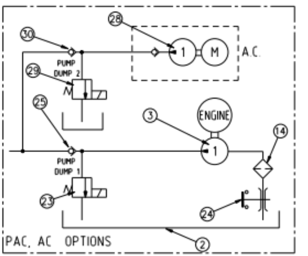

I stumbled on this definition of "dump boost", which is one of the things on the logic diagram we didn't understand. How is this different than the pump dump logic?
"In the context of hydraulics, dump boost refers to a system where a valve is used to quickly relieve pressure from a system, often by dumping a large amount of fluid into a tank, and a "boost" is applied to increase the pressure in the system, such as for a pressure regulator valve.
Here's a more detailed explanation:
"Dump" Valve:
A dump valve is designed to rapidly exhaust pressure from the downstream system, allowing for quick pressure release. It can be activated by solenoids, air pilots, or have override/emergency functions.
"Boost"
In this context, "boost" refers to increasing the pressure in the hydraulic system, often achieved by applying a higher pressure to a pressure regulator valve to achieve a higher line pressure.
Compound Relief Valve:
A compound relief valve, used as a pressure regulator in pump delivery, consists of two valves: a pilot valve and a dump valve. The pilot valve relieves a small amount of flow, to which the dump valve reacts by dumping a larger flow. "
/ What is a pump dump? #31
In looking at the hydraulic schematic two of the functions are single acting cylinders with load holding PO checks so you need pressure to open the checks to lower so not sure if there is two stage relief to just supply pilot pressure for these functions. It is not shown on the schematic that I could see.
Only dump valves shown on schematic are the pump unloading and they only unload the pump.
Do you know if this lift had some option for an accumulator. If yes the boost dump might refer to unloading the accumulator.
