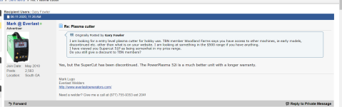

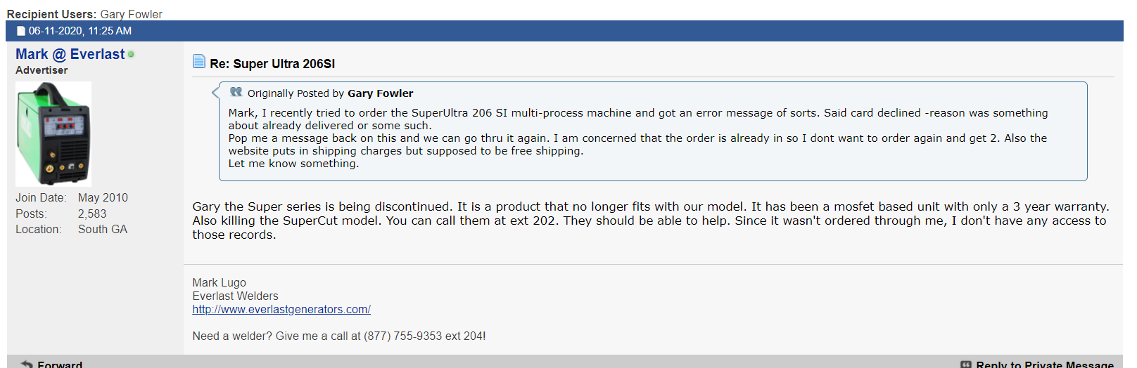

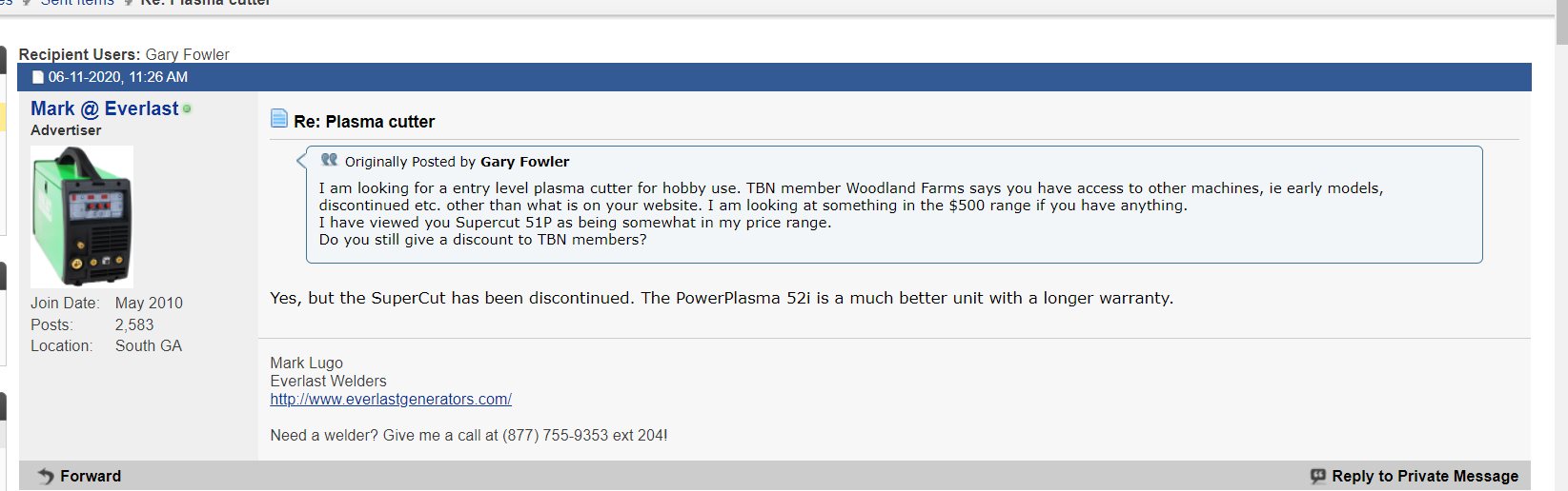

Now as far as being after the fact what I told you... Here is the conversation that I have with you over TBN to clear things up. I want people to understand that when I try to recommend a product to a customer, I try to recommend the BEST product for him or her. In many cases it is something less expensive, all depending upon their need. I don't make much money from sales in %. In fact a unit like that barely makes a ripple in my check. So, when I make a recommendation after someone is looking and asking, I try to inform the customer as best as I can what unit I think is best. I've always done that no matter what industry I was in whether it was in the farm equipment industry, or welder industry... Of course people tend to ignore things when the pocketbook is the bottom line. This isn't "after the fact". This was before and during. I can't really blame you for wanting something cheap, but I told you the facts about it.

First, I hate to hear of any customers unit that has a problem or fails. If it is my customer, then I tend to take it personally. I remember quoting a unit to Gary for our entry level unit.
In fact, let's just put this out there. I just checked out emails and pm's. I counseled Gary against buying this type of unit and also told him that our entry level models were being discontinued. I did not feel comfortable recommending those units to him. Best I can remember, he did not buy direct from me, and insisted on buying it anyway and bought it elsewhere against my advice and explanation. I in fact made recommendations for other machines. When he had problems initially, I think I was the first he contacted though.
If anyone has followed my advice over the years. I've never recommended those type machines, especially for the average user. They are specific designed for a purpose. Regardless of what I say, There are still people that say people "no, this is what I want." I think I recommended against Gary buying one, but he did. Sure a lot of people do buy them. Most all are happy until something happens.
