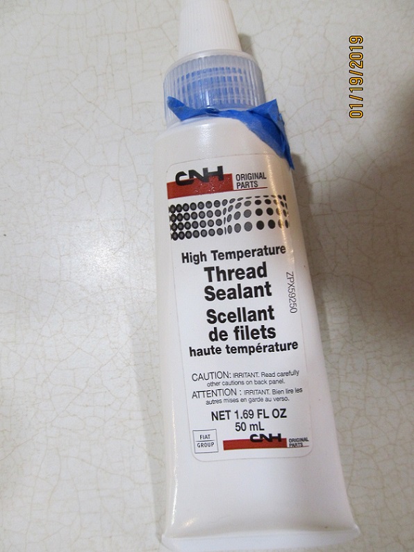

The thread sealant I'm using is here
and it says it's for, among other things, hydraulic systems. I called the parts counter and he said that's what they use for hydraulics. So, I'd say it's fine. I've done a lot of hoses over the years, just never anything beyond that and am trying not to screw it up.
