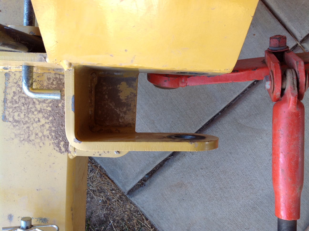

I hesitated for some time before writing this post, but decided I could use a little community input.
I purchased a 78" box blade for tractors between 30 and 70hp from Everything Attachments a few months ago. I hadn't even heard of Everything Attachments at the time, but I was searching for a box blade made in the USA, and when their site came up on searches, I did a little research and found that they were a legitimate company. I ordered the blade and it came via freight right on schedule.
I was very satisfied with the apparent build quality, especially for the price, over anything I could source locally. The blade had one small defect; one of the lower 3 point mounts was narrower than the other due to a welding mistake.
I spaced out the narrow side differently, and went ahead and used the blade. I eventually decided I'd drop EE a line and mention that although I really liked the blade, they should be aware that they had a little QC problem and should watch out for it in the future.
Well, I heard back from EE, and they seemed polite enough in acknowledging my email, but then a few days later I get another email saying they thought that I had a stabilizer issue which was letting the box blade swing from right to left and causing the ears to bend. (note that the outer ear is angled inward, which isn't something that could be caused by swinging in the first place).
I sent a few additional pictures showing that the ear was simply not welded square to the center clevis panel when the implement was manufactured, and it was not bent in any way. The ear itself is a perfect 90 degree angle with perfectly straight sides, etc.
What did I get? Another email saying I would "continue to bend the ears" if I continued to use it without a stabilizer.
I'm pulling the 78" box blade with an old farm tractor that makes under 25 drawbar horsepower. The box blade is rated for tractors of up to 70hp. I am using a factory 3 point hitch adapter that has pulled box blades for hundreds of hours without bending them up. In fact, if this blade can be bent - even if it was abused (when in actuality it's doing light work in light soil) - by this old tractor, it's got a problem to begin with.
I don't understand this kind of response insisting that the customer is essentially destroying equipment through misuse when it is clearly a manufacturing defect. I have several other implements on my shopping list, and due to my overall satisfaction with my box blade, I was going to buy them from EE. At this point, seeing their attitude when a defect or quality control issue is pointed out to them, I am concerned about what kind of response I would get if I had a real issue that needed to be corrected!
I'll say it again - this box blade is better than locally sourced blades that cost $500 more -
I guess I'm just looking for some input from someone who's had to deal with Everything Attachments after the sale...

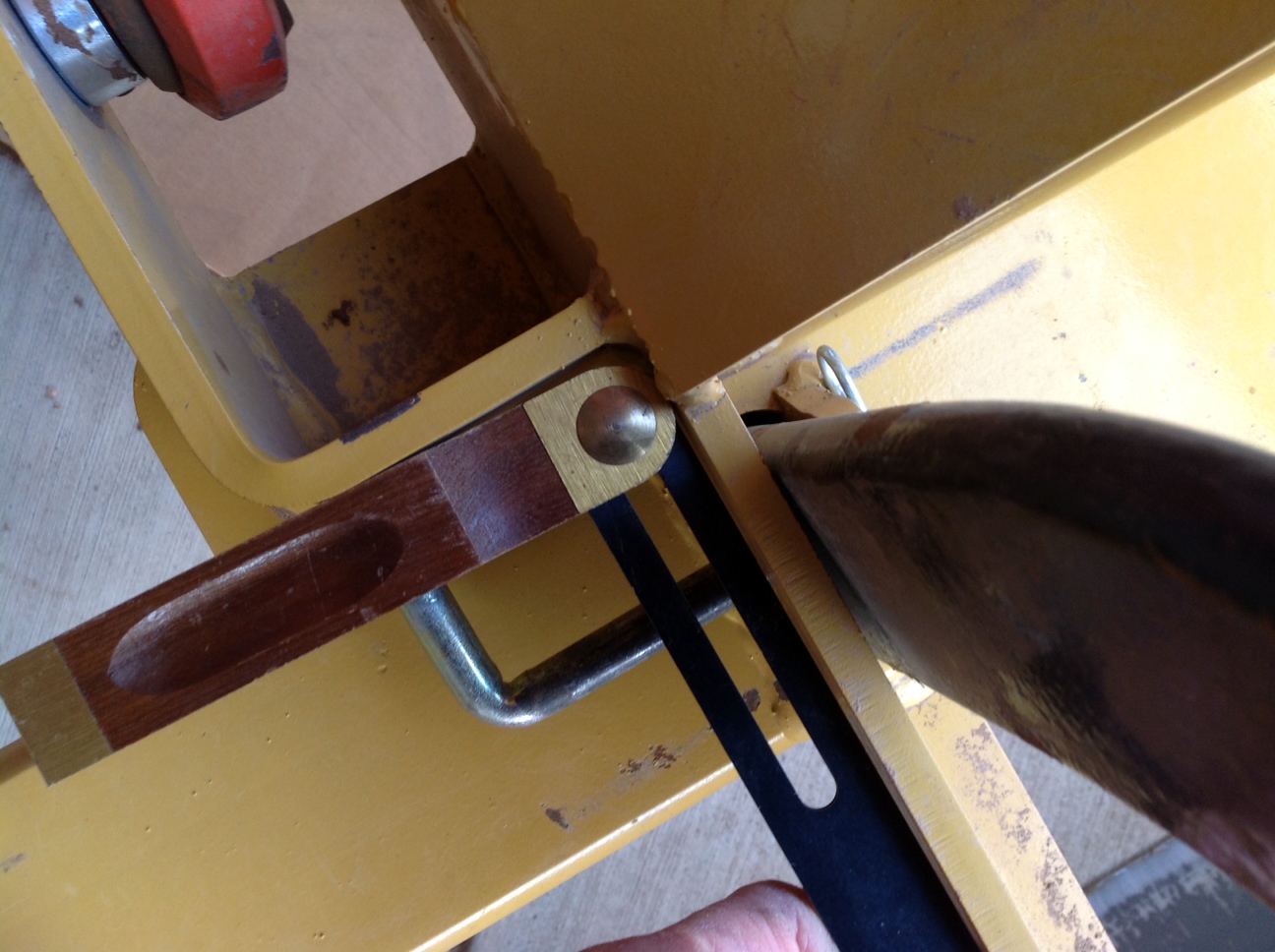

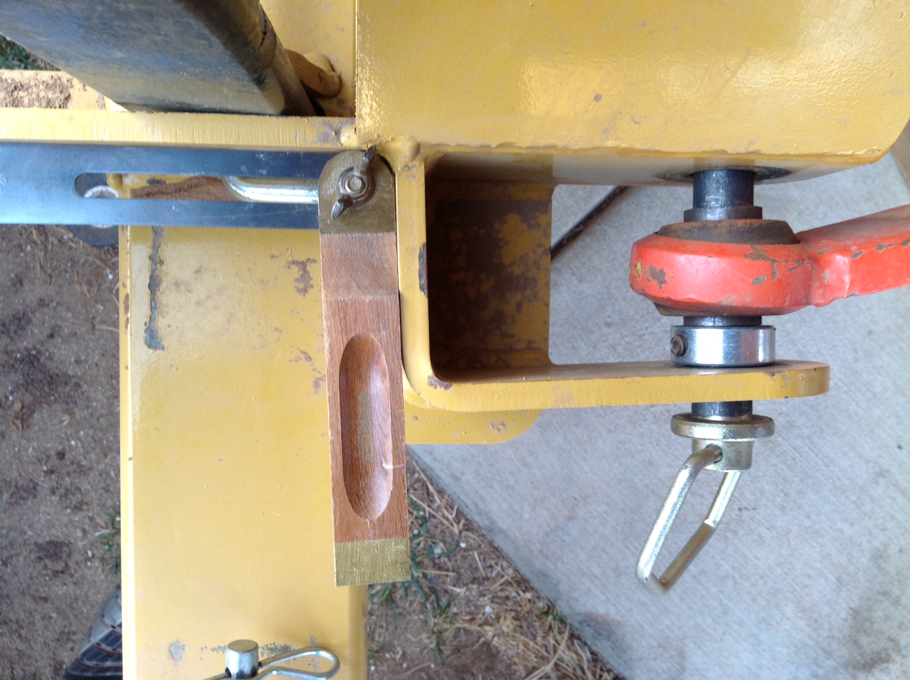

Angle made between the frame and the back of the mounting ear (quite a bit more than the proper 90 degrees):
let's transfer that angle to the good side which is welded at 90 degrees... Oops :)

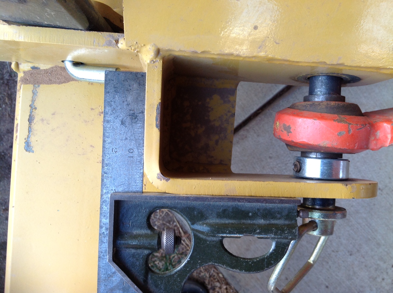

side plate of ear is as straight as an arrow:

The ear itself is a perfect 90 degree piece of angle:
Here's the 3 point hitch:

I'm no fabrication engineer, but that is clearly a welding error. The ear itself is 100% intact--not bent or deformed in any way. And you can see that the welds themselves are not square to the frame.
/ What is Everything Attachments thinking? #6
Yep, they goofed welding up the ear. You should see how much King Kutter goofed on one of my carryall's legs. It's definitely not square with the rest of the implement.
Is EA's welding goof causing you much hassle operating the implement as designed?

I think they are reasonable people, and it's obvious looking at the pictures that this was a welding issue. The piece was clearly not clamped or held down in the proper position before welding it up.
Does it affect operation in any way? Can you still get the pin to slide in and out easily?

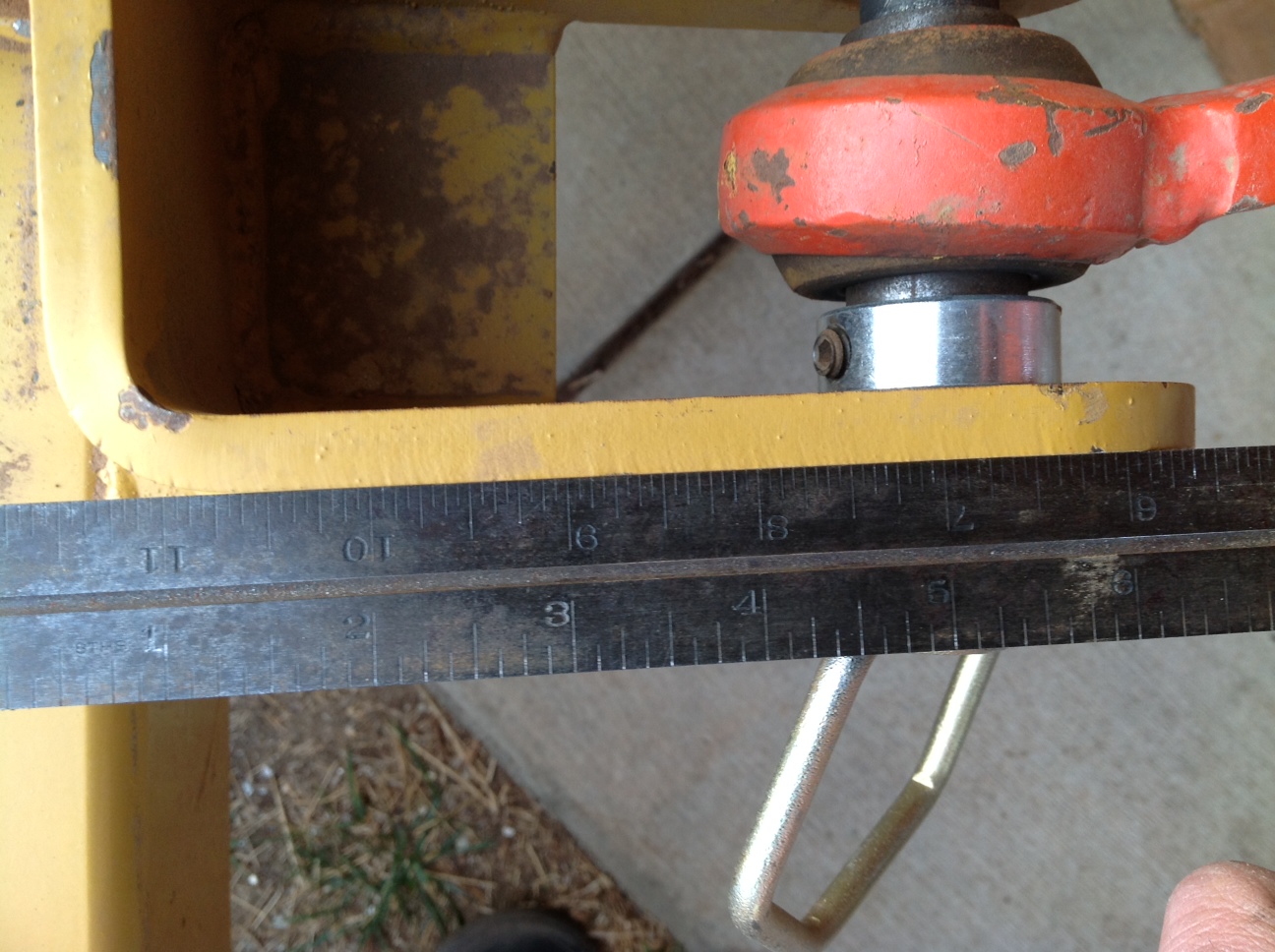

It does bind a bit as you are getting at. The cat1 lower link pin is 7/8". The implement hole is drilled 0.050" overbore, but the wall thickness of the ear is a hefty 3/8" so it takes a bit of persuasion to get the pin installed. Yes, it can be frustrating when it is cold and windy out. :laughing:
The ears are about 7.5% narrower on that side which is right at the limit of being able to install the pin without enlarging the mounting holes in the implement, whereas the good side slips right in. It does require me to use a stack of washers instead of a 7/8" x 1/2" shaft collar to space the stock 2" bushing on my 3PH to the width of the mount point. It looks rather stupid.
