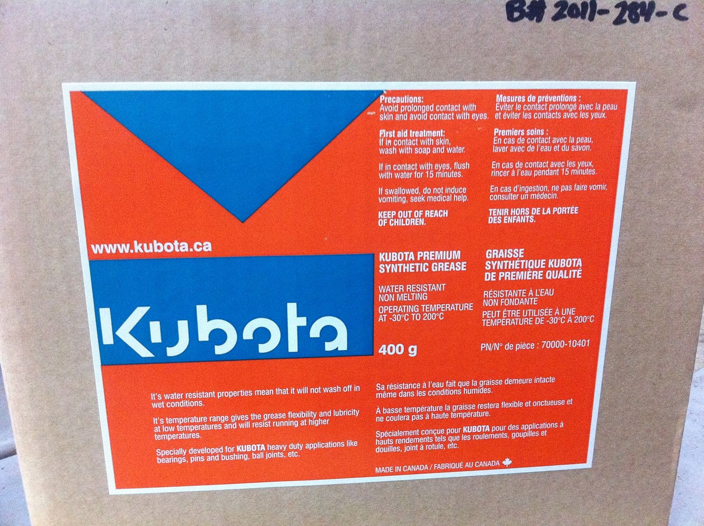

I ended up just greasing with the molly ep. There seemed to be so little grease in them in the first place I doubt I'll have an issue. (Wish I checked sooner) Why do you all like the red so much because it matches the tractor or for certain properties over others?
By red grease, I mean lithium complex. I don't care which brand of lithium complex... as long as they're the same basic type, all is well. Without going into all sorts of techno-babble, lithium complex is a good, all purpose grease for my needs on the farm. Good high temperature stability, decent water resistance, good rust prevention, pumps easily, and it's widely distributed, which means I can get it everywhere.

   / What is kubota factory grease? #27
This is what I use.

I dont have anything to fit the tractor in so it does sit out in the weather. I've loaded it it up with the valvoline ford moly EP. I understand your point just to grease it but is it worth switching to the polyurea for the extra water resistance next time I need to buy more?
   / What is kubota factory grease? #29
If you only have one tractor I think the price difference spread out over a year is so negligible it's worth it. That way you will not be wondering.
   / What is kubota factory grease? #30
I wouldn't. Polyurea is really meant for constant exposure to water-wash environments. Think: bearings in car washes, etc. Lithium stearate & Lithium complex grease has reasonable resistance to water wash, is easier to find (more common), and since these get greased every 10 hours of use there really is no risk to rust in the bearing area of the pin/sleeve. On machines that run 24/7 that is not the case.
btw - the difference between "plain" lithium (stearate) soap thickener and lithium complex soap thickener is high temperature breakdown resistance. So for this application, it doesn't matter which type you use. But - if you were re-greasing a disc brake bearing hub, you would have to use lithium complex. So that's what i have around all the time so I don't screw up.
