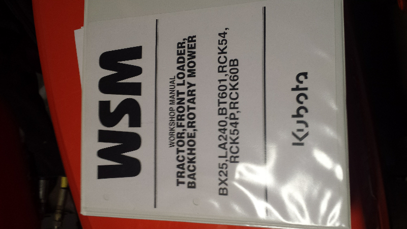

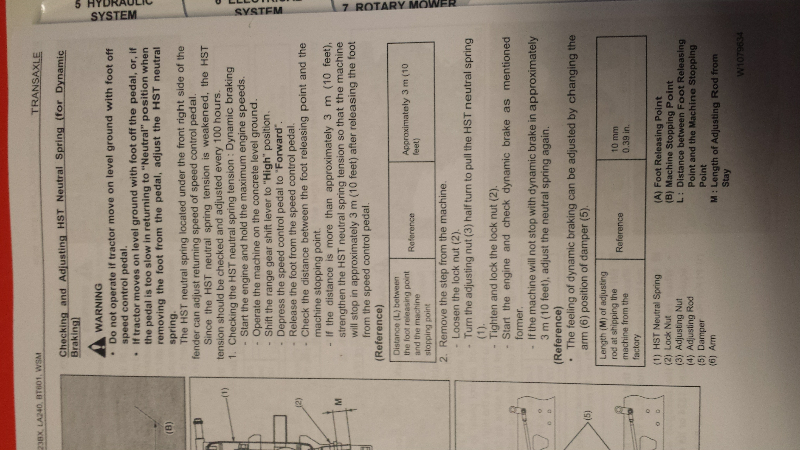

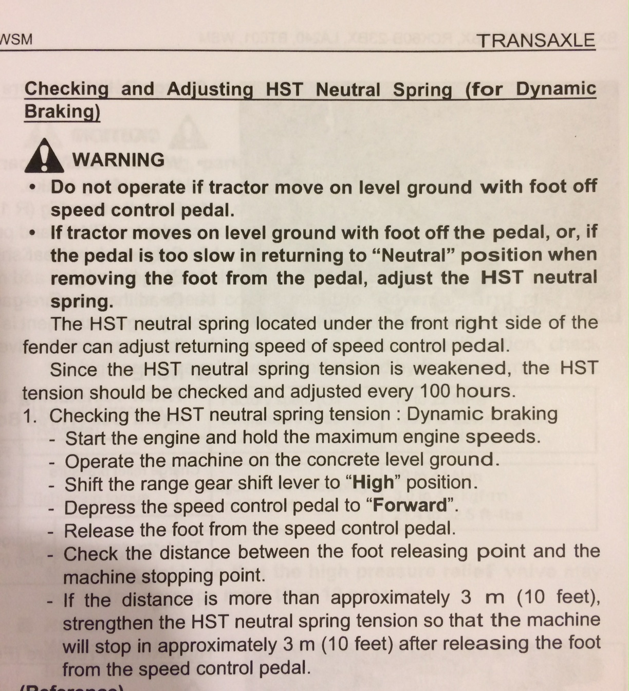

Found it in the workshop manual,
Pretty much full rpm's and full bore in 2wd in high and stop within 10', on level ground preferably concrete. Mine was 9.xx something. Again I'm used to mine so its not as issue for me.
