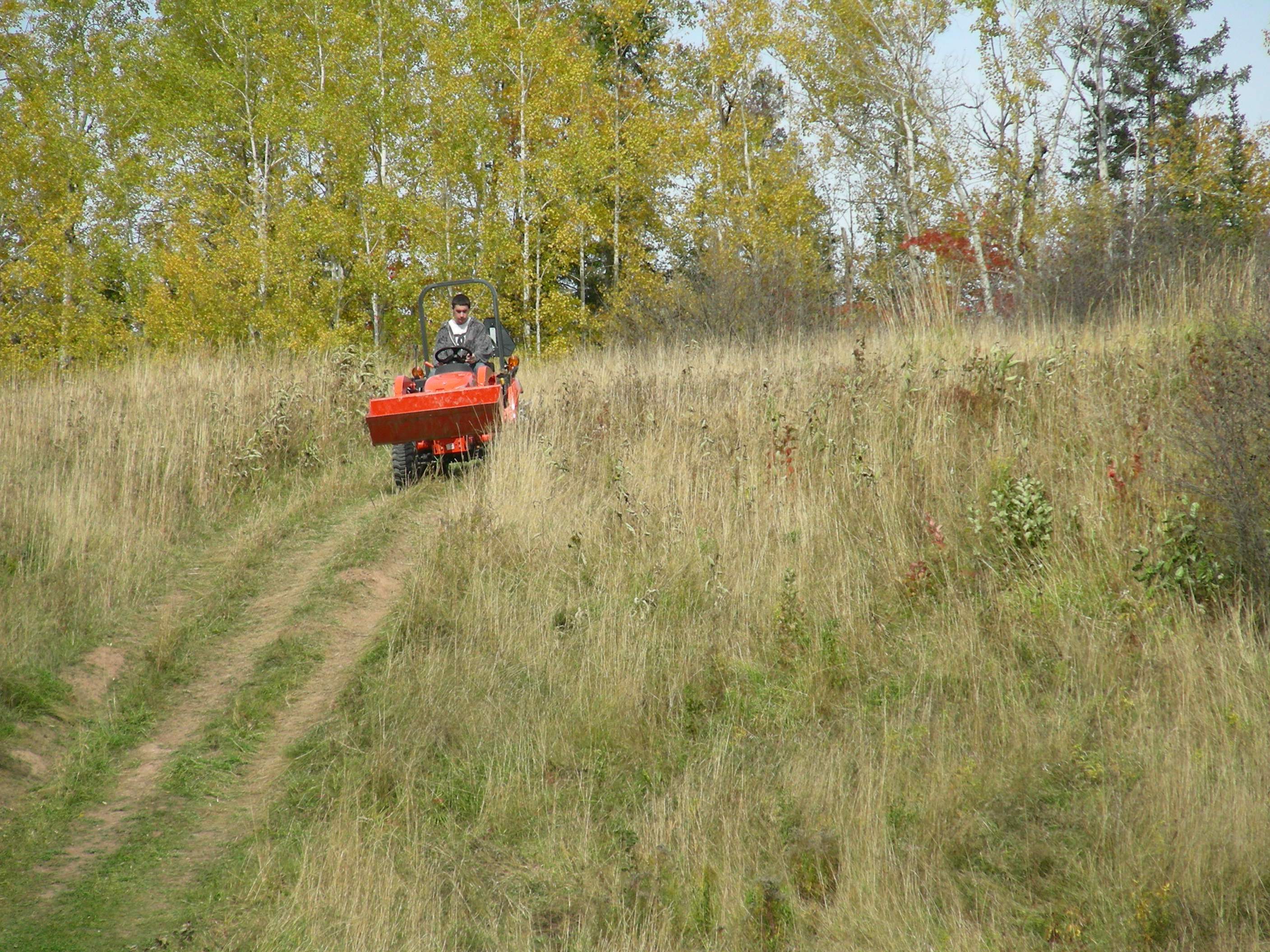

I have a 2008 BX2660 , I regularly go up an down a 15 % incline to my upper meadow (see pic taken many years ago my nephew riding it down) .
If I let off the HST pedal in middle of that hill , my tractor stops . I also often stop and jump off tractor (on level ground ) and do not use parking brake. When it does start to creep, then I know it is time to grease the HST pedal . And then I am good for a few more months.
