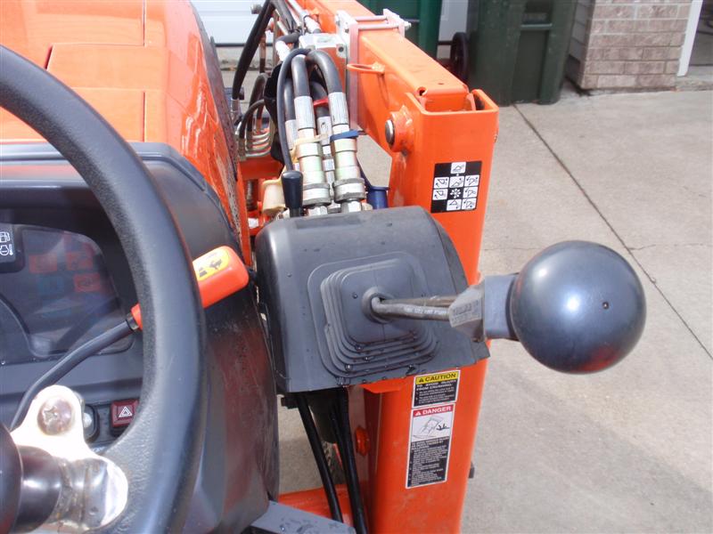

I got my valve and wiring harness from Fasse (Farm Equipment Solutions | Fasse Valves) I did need to modify the wiring harness as it did nto reach to the places I wanted it to for how I wanted to connect it. But the switch is a nice weather proof rubber covered thing that mounts nicely on the joystick with a couple small zip ties. They were really very helpful, especially for such a small order (to them).
You can see the black rubber switch on the joystick, if you look closely. It sort of looks like a gray blob just below the knob in the pic, with the wire running down the joystick shaft and through the boot.
attachment.php
Oh yeah - it took me 2-3 good days to get everything connected up including trips to Metalsupermarkets, the hydraulic shop (twice), hardware store, marking/drilling/cutting and just putzing around with how I wanted to do everything. Don't plan to bang this out in an afternoon unless you are very experienced in this type of thing.

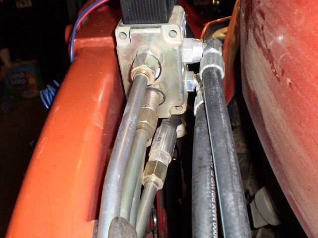

Dave.... Here are some pictures of the valve.
