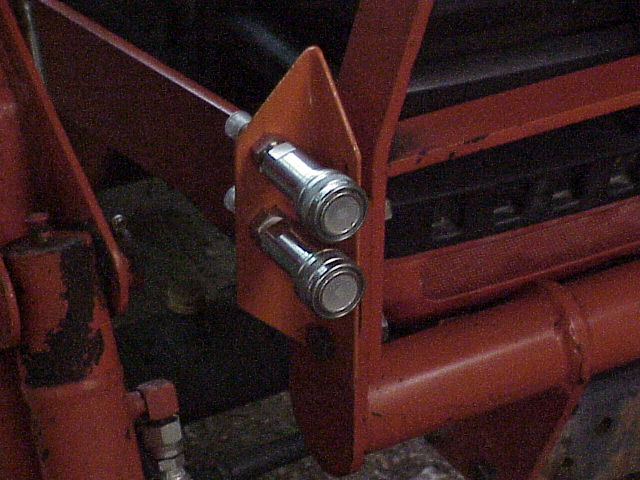

This is what I did:
   / What is needed hydraulically for a grapple? #32
This is what I did:
Why did you mount it to the grill guard rather than torque tube? Doesn't that require you to have extra long and potentially more vulnerable lines to the grapple?
   / What is needed hydraulically for a grapple? #33
I got a complete set of Kubota Loader hoses (5) on e-bay for less than $50 ( a steal)...the lengths worked out perfectly... I did not use QD's at the valve so If the QD's were mounted on the loader it would create problems if I remove the loader...have not had any problems...

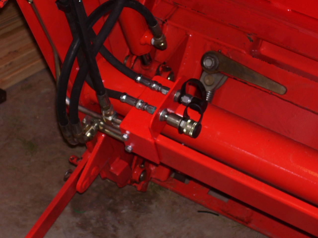

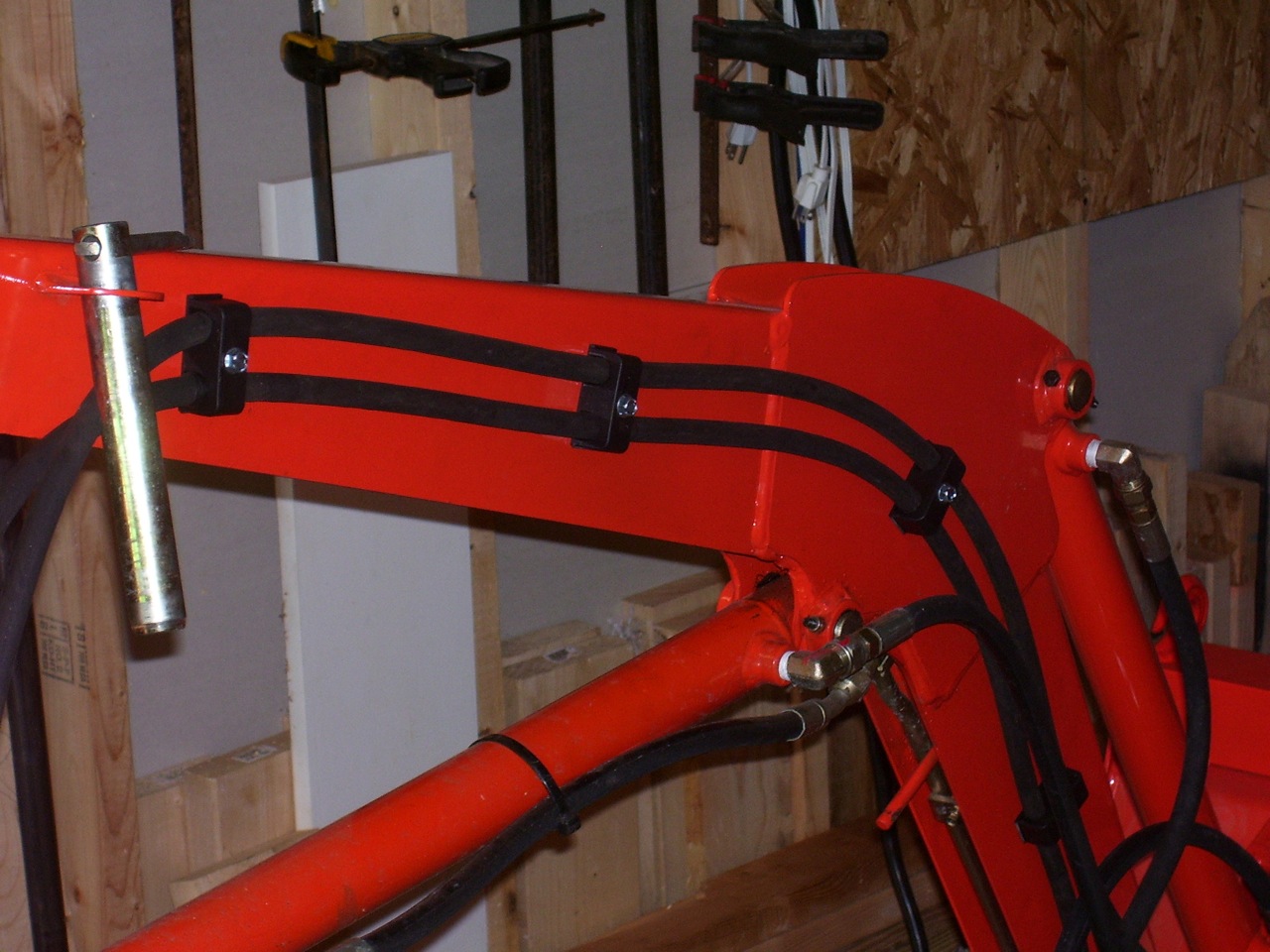

I just use one pair of my rear remotes... KennyV
Like others I used the rear remotes. I ran the lines under the tractor and to the left side of the engine. It got very tight on the right side that is why I went to the left side. I fabricated the metal brackets after I made a cardboard template, added quick disconnects, and fastened the hoses to the loader arm. Pictures might explain it a little better. I was waiting for one disconnect in the third photo so it is missing one QD. I use this (so far) for the angling of my loader snow plow.
