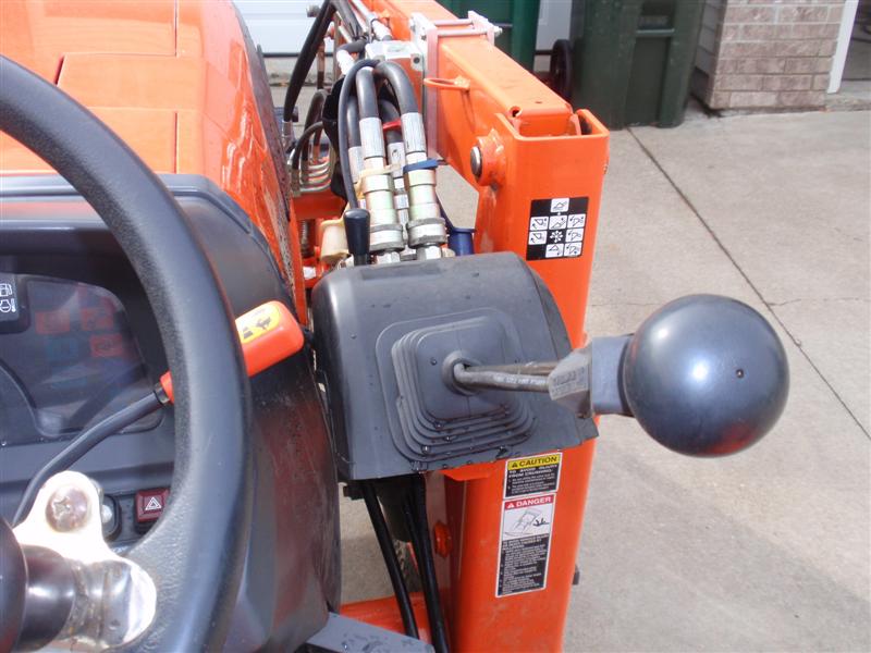

I got my valve and wiring harness from Fasse (Farm Equipment Solutions | Fasse Valves) I did need to modify the wiring harness as it did nto reach to the places I wanted it to for how I wanted to connect it. But the switch is a nice weather proof rubber covered thing that mounts nicely on the joystick with a couple small zip ties. They were really very helpful, especially for such a small order (to them).
You can see the black rubber switch on the joystick, if you look closely. It sort of looks like a gray blob just below the knob in the pic, with the wire running down the joystick shaft and through the boot.
attachment.php
Oh yeah - it took me 2-3 good days to get everything connected up including trips to Metalsupermarkets, the hydraulic shop (twice), hardware store, marking/drilling/cutting and just putzing around with how I wanted to do everything. Don't plan to bang this out in an afternoon unless you are very experienced in this type of thing.

kattywumpus said:
My question is are there any recommended electric over hydraulic valves?
WRLong has one that quite a few TBNers have installed. Never heard a complaint but it is a tad pricy as you must go through a dealer.

I put quick connects on the valve also. Just in case I want to take the loader off for some reason I can leave my grapple hoses connected to the loader. And all of mine is bolt on. The two bolts on the bottom of the factory bracket are long enough for another 1/8" steel plate. Then I got a longer bolt that holds the plastic cover and ran it through my bracket and back into the cover so it could keep the lever end from flopping around. Just a little stouter in my opinion. Works great!!!
   / What is needed hydraulically for a grapple? #49
I did the same thing with my first tractor and had it set up to split when the loader came off. I would not recommend that for most people though as I never took the loader off (most of us don't) and therefore it was just extra expense. It also means you have a lump of four bulky QCs dangling at the base of the FEL mounting post. If I were to do it again I'd just run a single length of 1/4 or 3/8 hose from rear remote all the way to the torque tube. It would not tale long at all to remove the lines from the rear and leave them on the loader if you ever do take the FEL off. Snip a few zip ties under the tractor and you are done.
