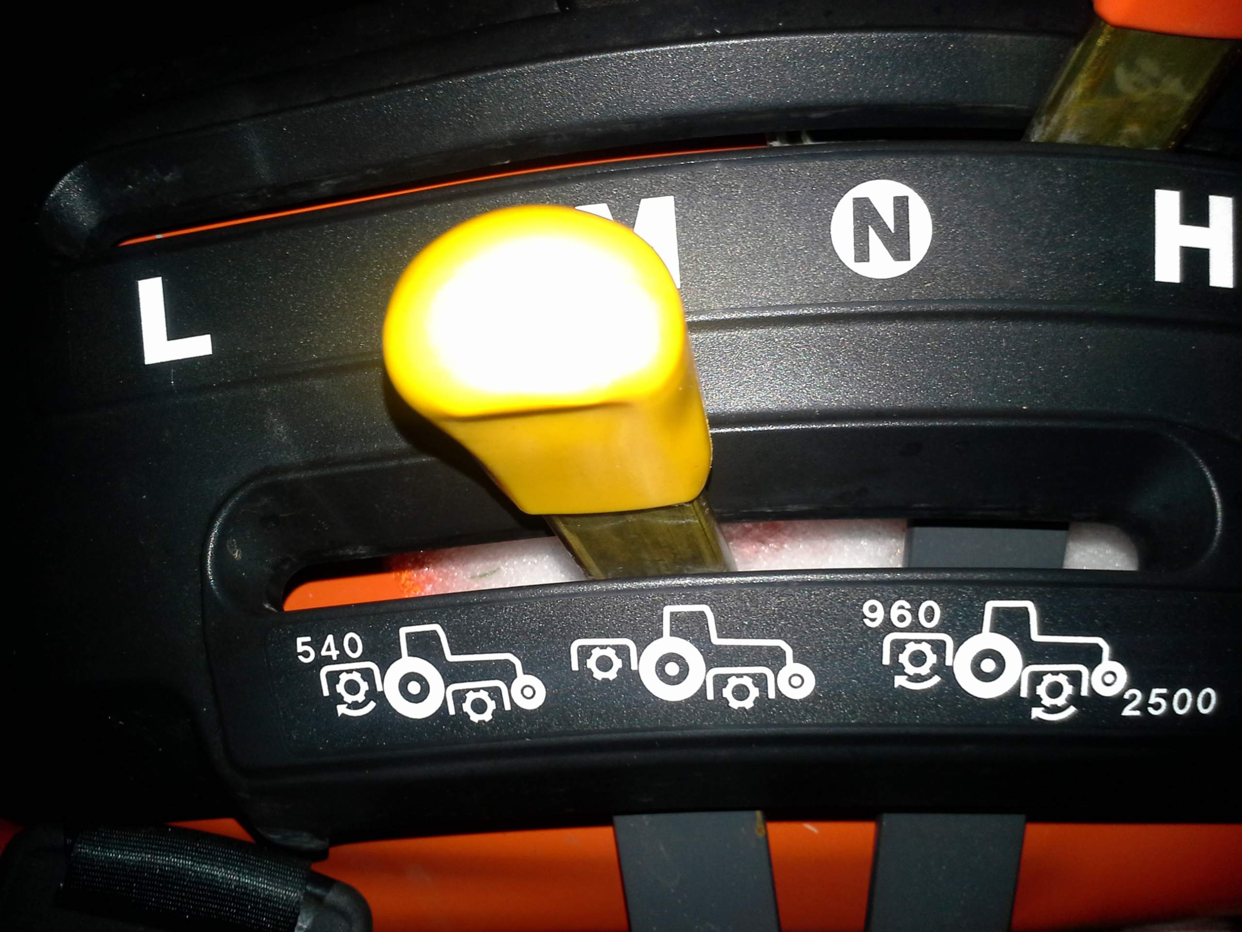

One word can answer your question the 960 setting on your tractor is for the mid pto for a BELLYMOWER
Well my B2920 has the MMM at 2500. Here is what I see.
Al
   / What Is The 960 PTO Used For. #32
I was told by my dealer representative that I could run my brush hog in the 960 position and have the tractor at a lower rpm that would still maintain the 540 output. There is a mark on the rpm gauge to support this theory.
