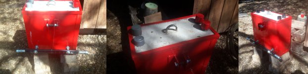

I have small tractor (SCUT) and went with 500lb ballast box (steel frame concrete fill) on rear.....

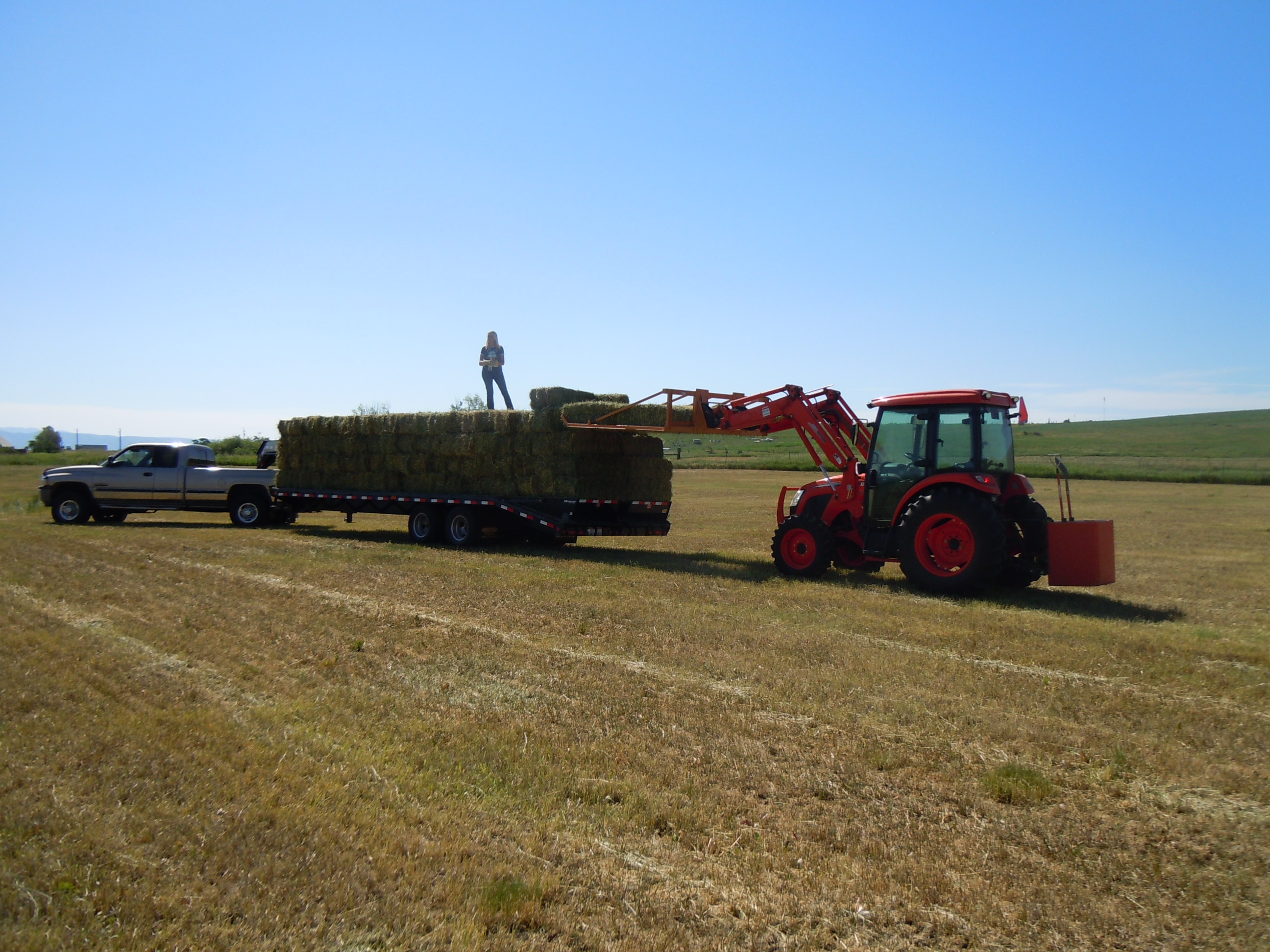

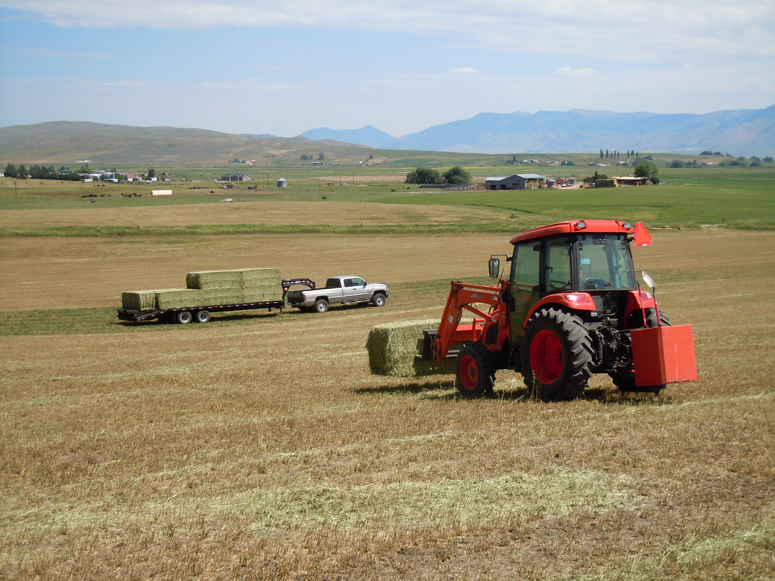

I think Rimgaurd filled rears and a ballast box is the way to go for lifting the bales you mentioned. My tires are not filled yet but this is what I use. Concrete ballast coming in around 1700 pounds.
The big bales were about 850 lbs.
