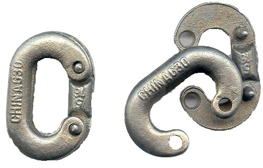

   / What is the best way to install a grab link onto a chain? #30
I like these connecting/repair links:
They are a bit hard to find but should be available at industrial supply stores. You put the two halves together and then pound the two rivets flat to make a tight connection. They make a cleaner connection than normal shackle type connectors. They look just like a regular chain link once installed.
