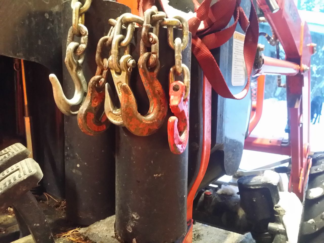

Here is a photo of a couple of my chains (they are 5/16") showing the links:
I like this method to attach hooks because it gets rid of the pin and cotter key. Although not as strong as the chain, the links seem to be stronger than what my DK35SE weighing around 6,000 lbs can pull. They have not broken over the several years of use. My favourite chain for dragging logs is the one on the right. It is similar to the one you recommended in a previous post in this thread.

That’s still less than half the working load of a grade 70 5/16 chain.
   / What is the best way to install a grab link onto a chain? #46
I realise that, but it works for me and I prefer the cleaner connection. I think my loader's capacity is around 1,600 lbs.

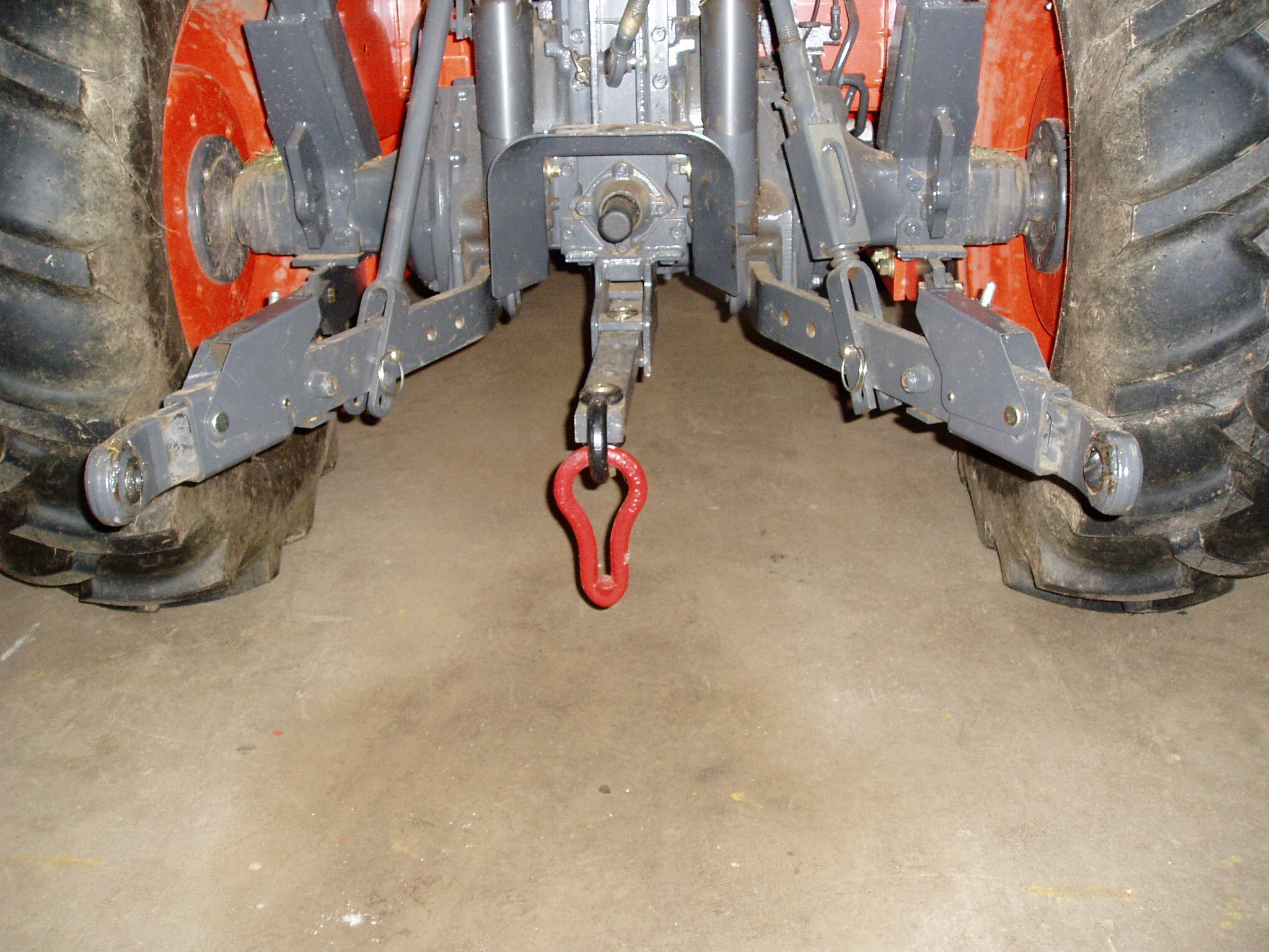

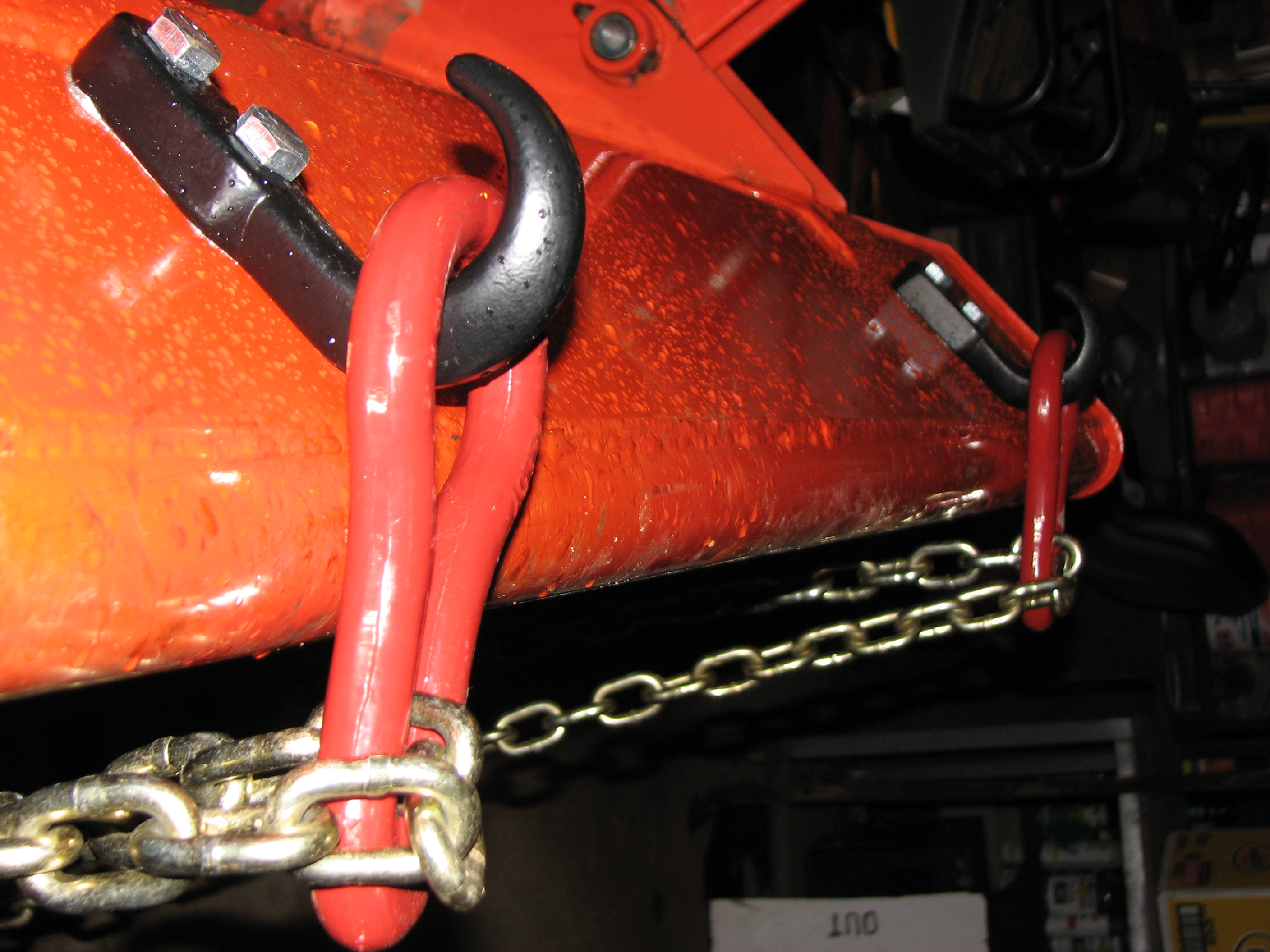

I use them all the time with 5/16" chains that have grab or slip hooks on both ends.
The chain with the hook attached passes through the "eye", so no need to attach the grab link to the chain with another piece of hardware.
I keep 2 in my tractor toolbox and they get lots of use.
Attached to the draw-bar with a clevis for pulling saplings makes quick work of hitching the chain:
... or to safely pull a log from the draw-bar while its weight is lifted by log tongs on a boom pole.
The slip link makes attaching the chain and adjusting its length really quick.
On the rare occasion when I need to attach chains to my FEL slip hooks (where I would typically use ropes):
