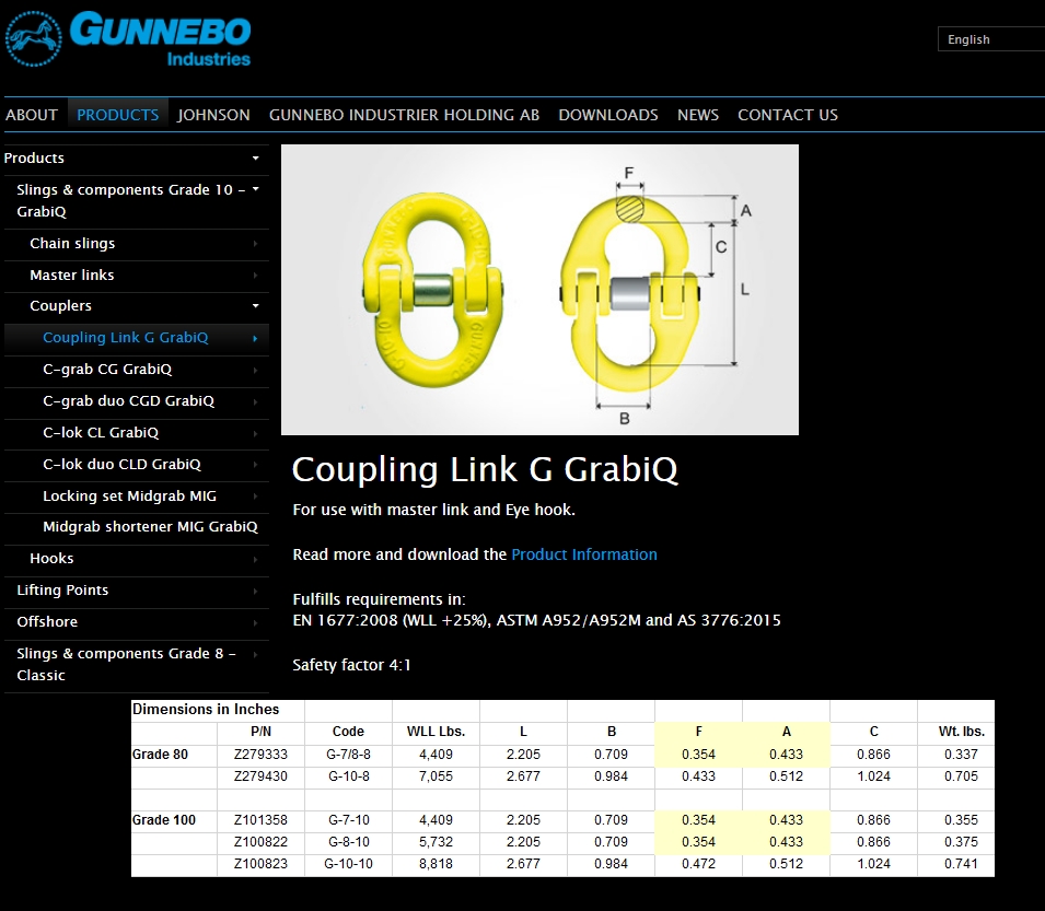

Just purchased a grab link and want to mount it to the end of a 5/16" chain.
Obviously the grab link is made for a 3/8" chain, but from what I am told it will work with 5/16" chain as well.
Would like to be able to remove it easily to be able to install it onto other 5/16" chains, of various lengths.
Also has to be able to move/rotate easily within the new fastener that will be mounted to
the end of the chain.
2x Hammerlok / Coupling links

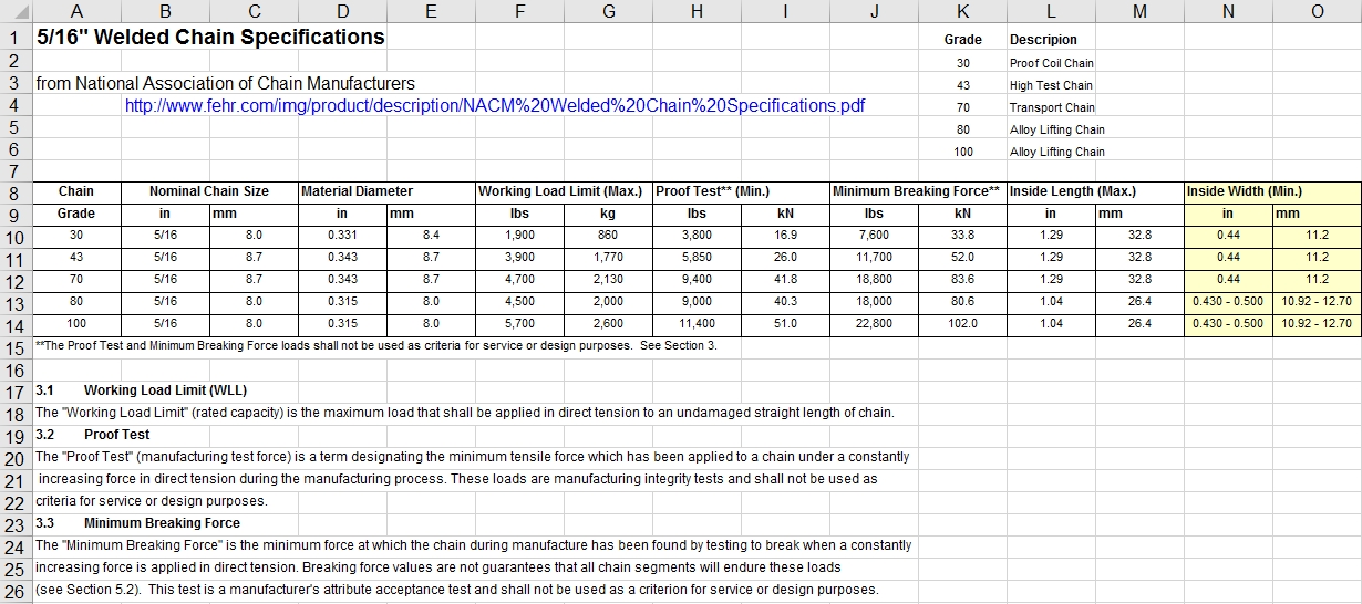

A CM Hammerlok Coupling Link (9/32") or a Gunnebo Industries Coupling Link G GrabiQ (7 or 8 mm) can be assembled through 5/16" chain (0.44" chain inside width, see A and F dimensions of coupler below), while still handle the 3/8" Grablink (see B dimension of coupler below).
See Youtube video for how these Coupling links attach / detach.
5/16" Chain Specifications
