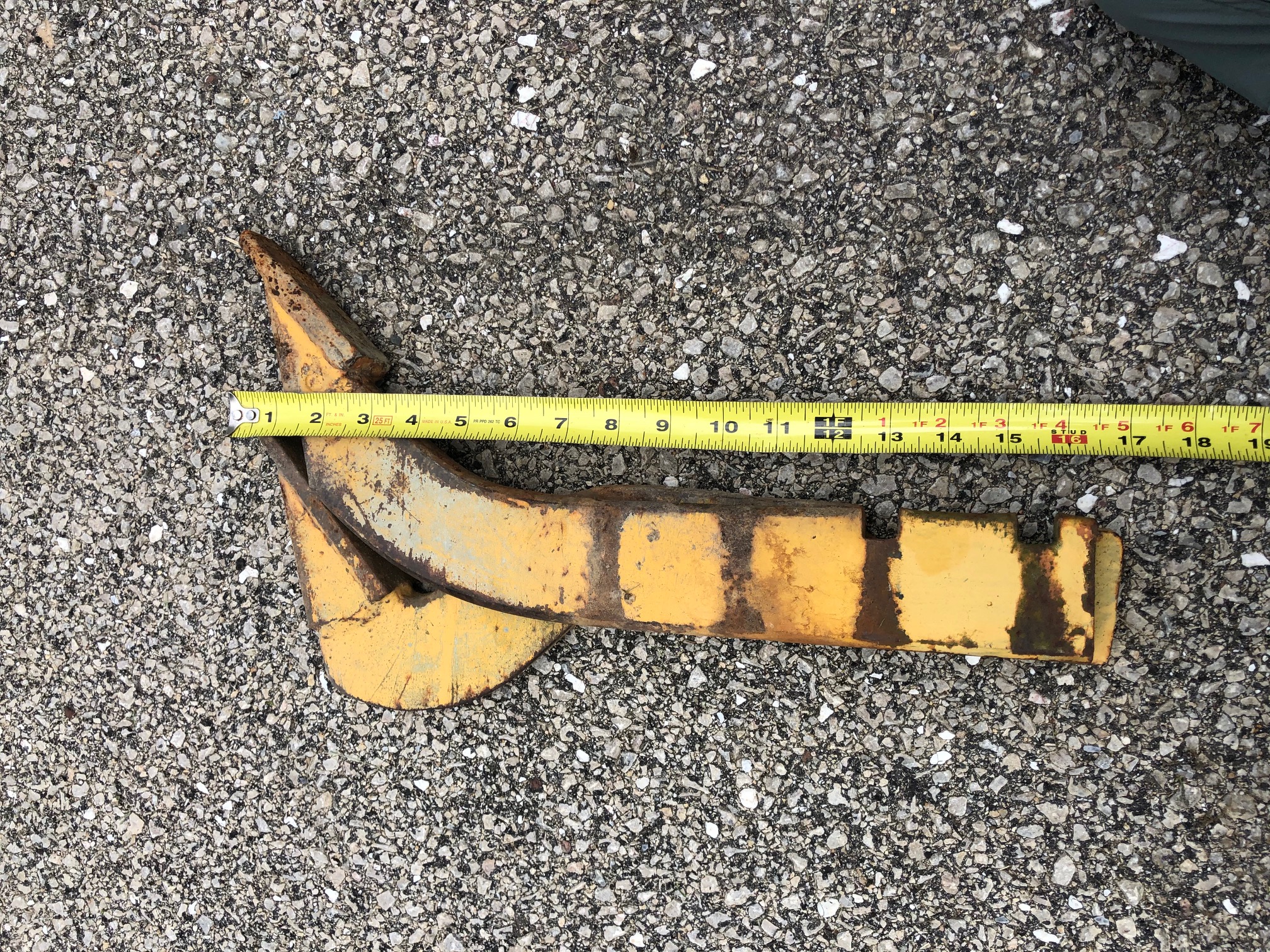

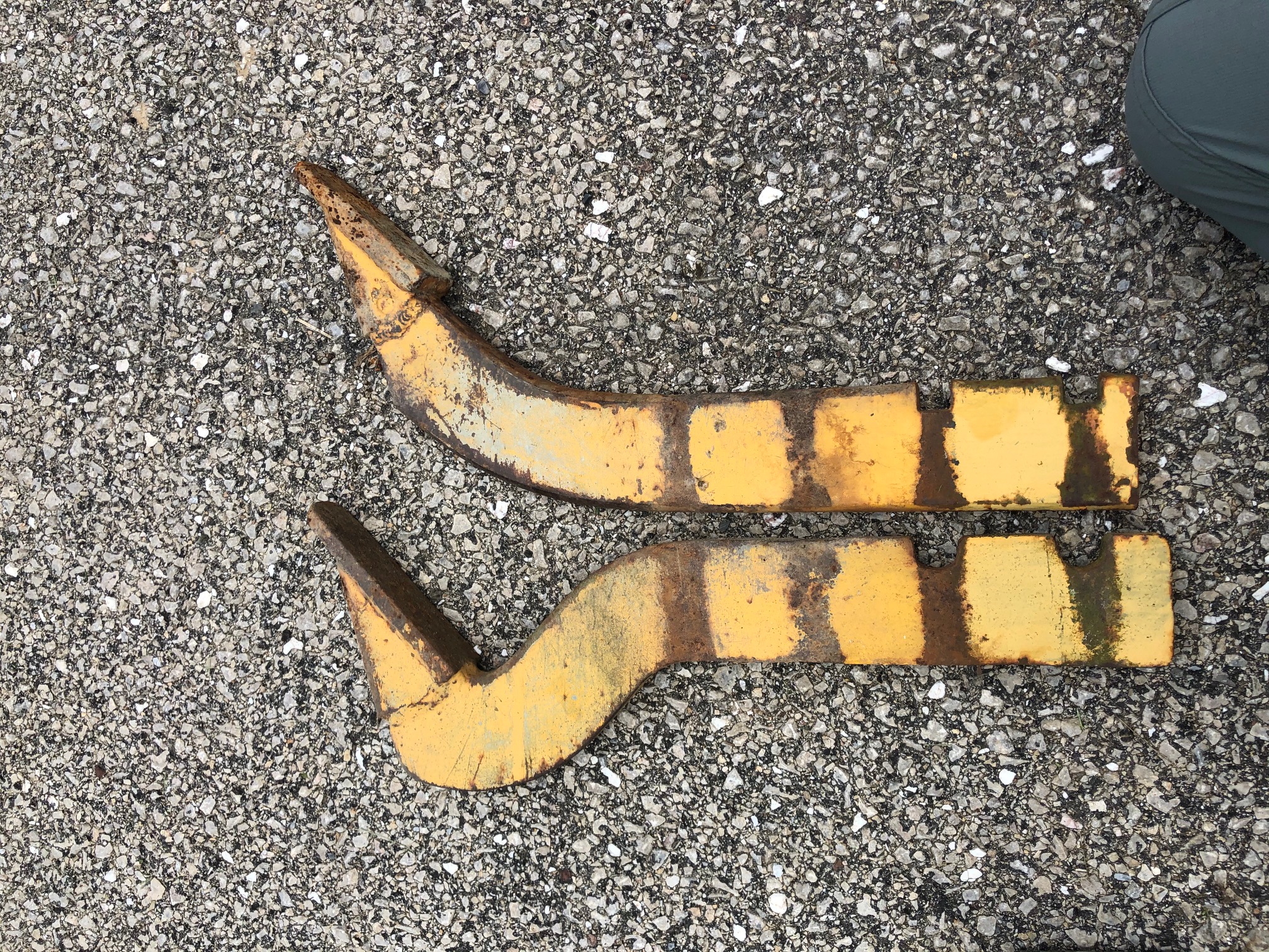

Anyone know where I can get a replacement scarifier? I cant find any on the internet with such a heavy rear angle. I need the one with the rear angle, the other one is a replacement that came with the blade. It sticks way out and hits my tractor when I raise 3 point to top position.

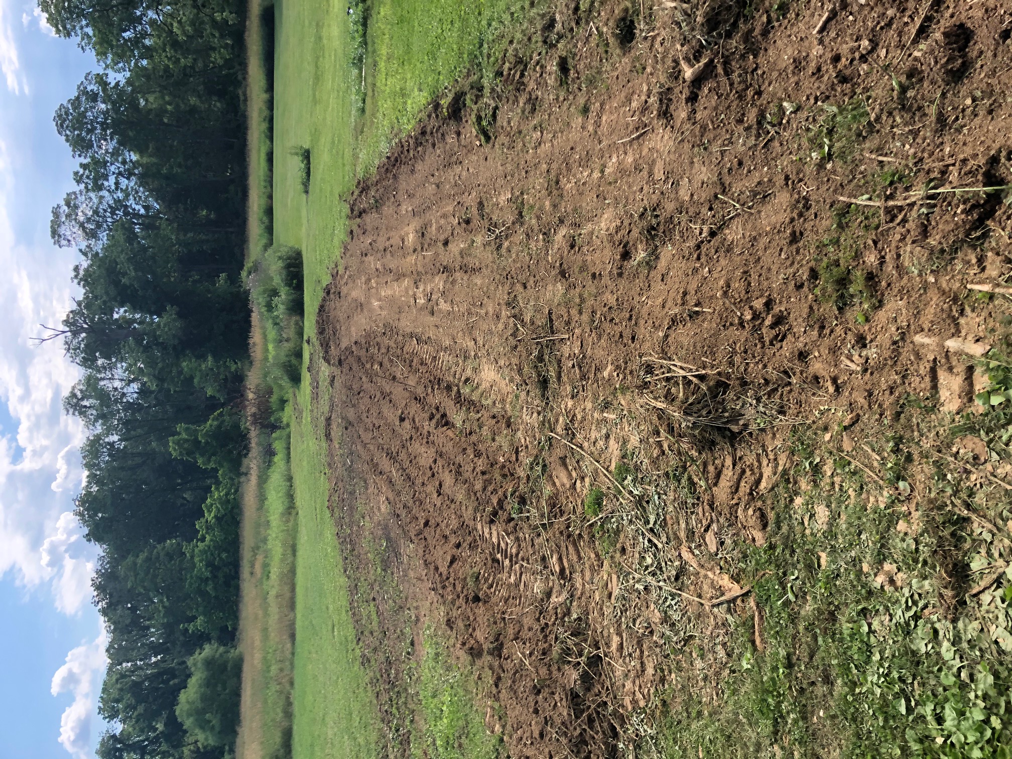

Here is a small test run, had to take out a hump where I couldn't mow. Only used it for about 10 mins I am very please so far
