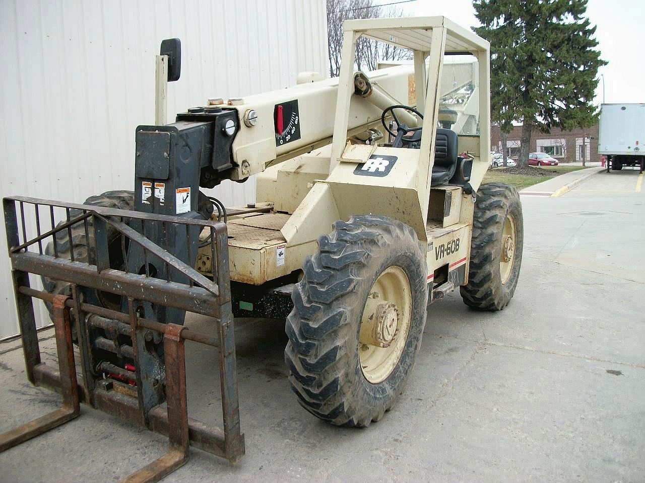

I always liked these kind of forklifts. You could run over a 1/2" lip, and never know it!:laughing:
