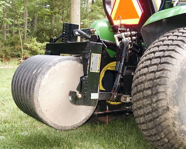

You either need a 3PT weight box or a rear weight bar for hanging weights.
A 5x4 or larger bale would need at least 500+ pound weight on the rear.
If your tractor has a quick hitch, using a 15-gallon plastic barrel makes a super neat weight.
This is about $35 overall to make.
This is around 550-lbs.

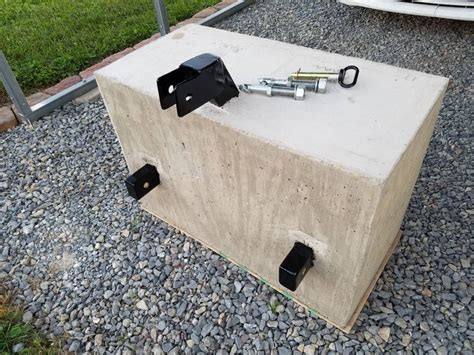

Its certainly not a one size fits all situation, but on my GC 1715 if I was lifting 500 pounds in FEL rear wheels came off the ground, my solution was to make a ballast box about 24x24x12 inches which comes out to 4 cubic feet, concrete weigh in at about 150 pounds per cubic foot, so weight is about 600 pounds, probably weigh more than I need, but rear wheels stay planted even when FEL can not lift weight in bucket... Probably something in the 300 to 400 pounds range would have been sufficient...

Our solution was a ballast box. We filled it with rock we had on the property... breaking the rock to smaller pieces to get a better fill. The ballast box cost $200ish. The rock nothingish but our time to break and place. And we did place.. filling tightly as possible to maximize the weight.
Our guess - north of 700lbs based on what we can lift without the rear trying to rise..
