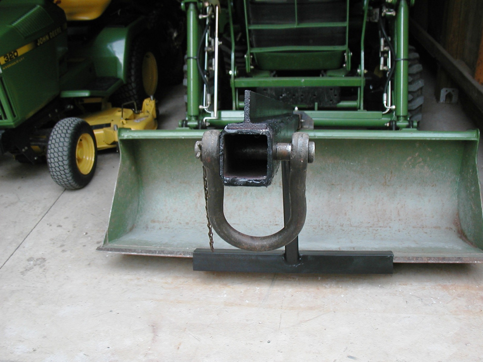

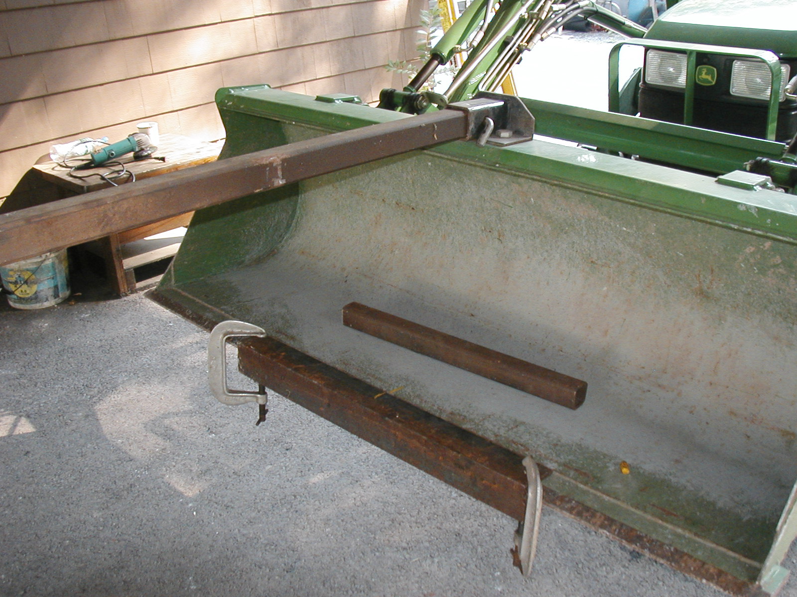

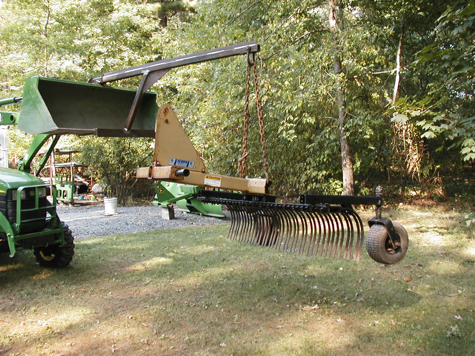

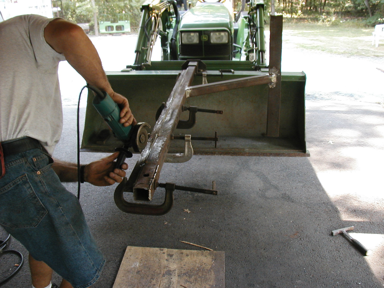

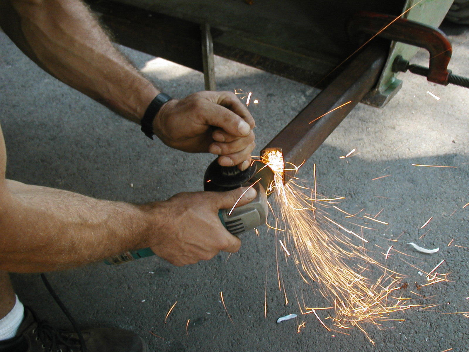

Here's a little fab job I did last week.
