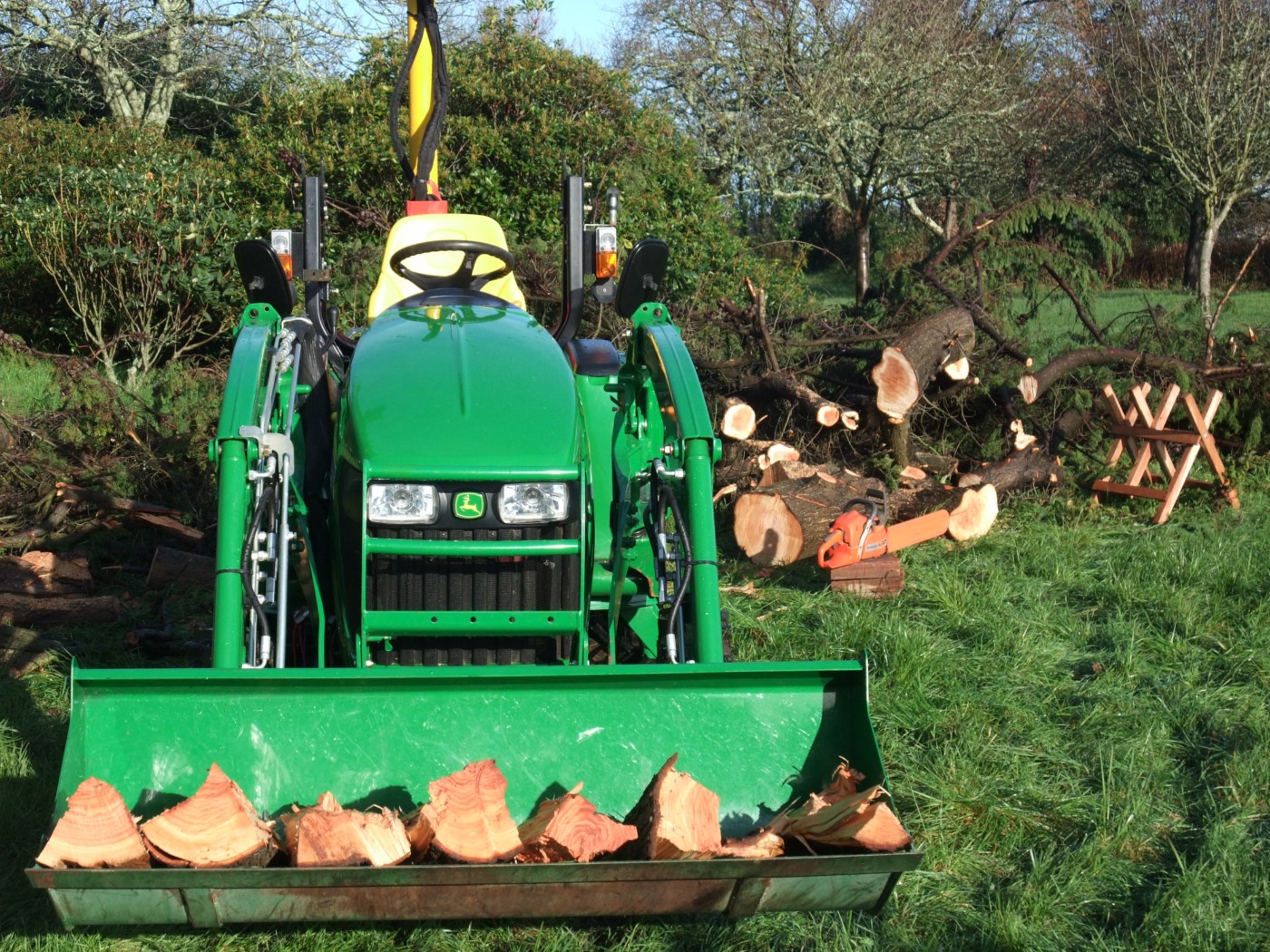

I use a 60" bucket with my 3520 and agri tyres. I find it already very cumbersome around trees and buildings and when full it is very heavy for the 300CX and the front axle. I wouldn't try anything bigger.
