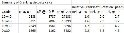

Here's a snap shot of the cranking speeds (based on their cranking oil viscosities) by oil type that I calculated. I did not do a 5w30. It would be close to a 0w30, which is the best.
A 0w40 M1 was very close to the 0w30, probably the same as 5w30. I did some other comparisons that tended to show this but didn't redo this table to add the 0w40.
Worst is 15w40. Main way it protects is its higher viscosity probably leaves some protection in place to make up for the LOOOONG time the oil pump needs to get oil to the pressurized parts. The R&B #s that you show say this is not quite so.

Ralph, yes, the 15w-40 in the Amsoil data shows good wear protection, probably lingering as you say. But look at the much more modest cold cranking. That is where start-up wear occurs. This wear apparently cannot be measured like the four-ball wear test, but it is presumed. And 15w-40 has the worst start-up protection in their lineup.
