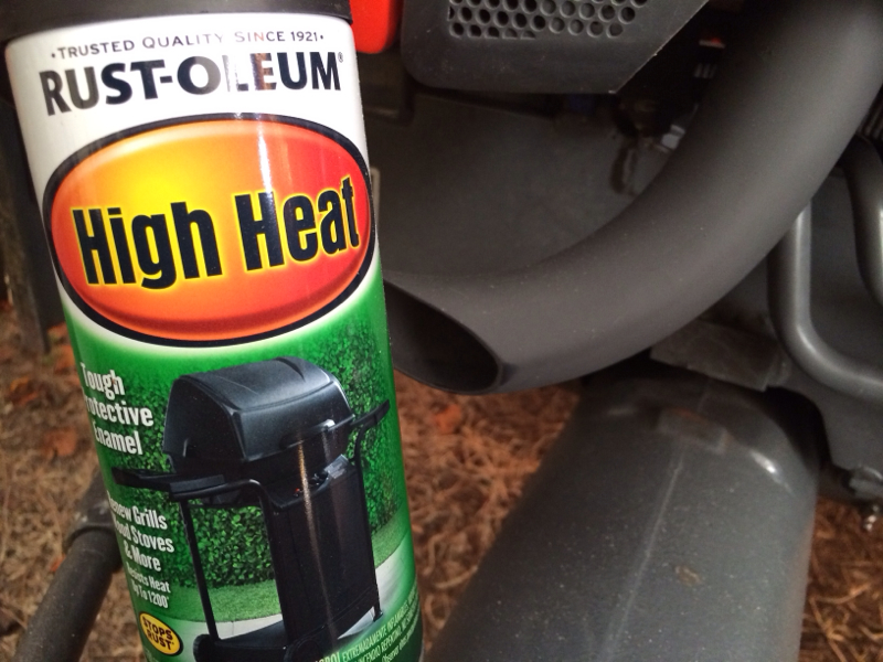

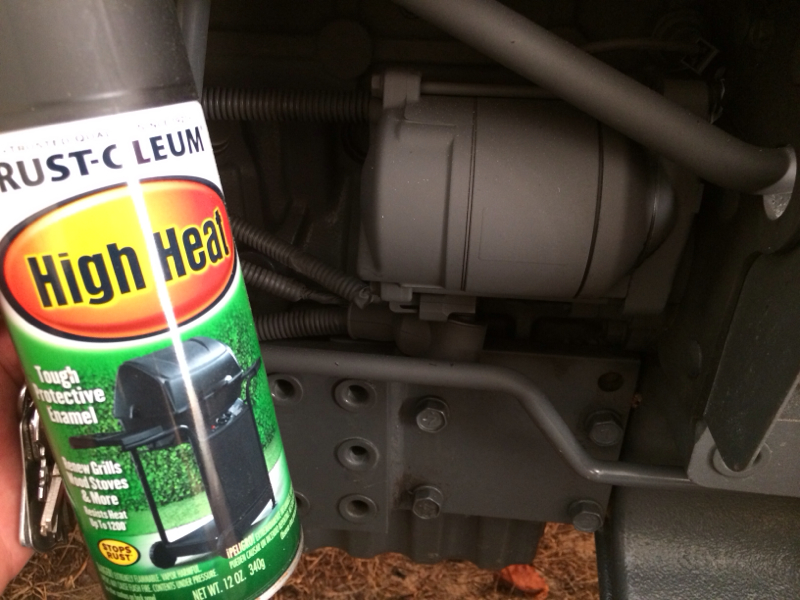

It must be an issue with the site. I loaded pics but after posting it they disappeared. I tried two separate posts. Maybe one of the mods could help, if not I will try and repost tomorrow again. I never experienced it before.
Or maybe just give us the name, we can google it.
