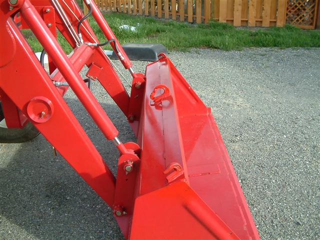

Here's what I have for haying on my 10 acres of flat (formerly) pasture:
2008 Mahindra 5525 (54 hp engine, 45 hp pto, 2WD, gear tranny, power steering) with the ML250 FEL (6-ft wide bucket, 2950 lb lift to 10.5 ft height).
For field mowing, I have a 6-ft Hawkline brush hog (aka bush hog, shredder, slasher). Something like this new would run about $18K. All of the tractor manufacturers have something equivalent.
Be sure to get chain hooks welded to the FEL bucket (you supply the hooks and your dealer welds them on free of charge)

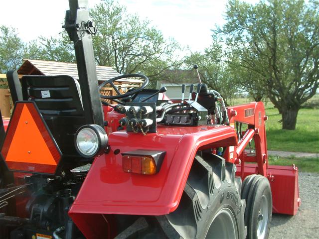

and hydraulic remotes installed on the rear (and possibly front) of the tractor.

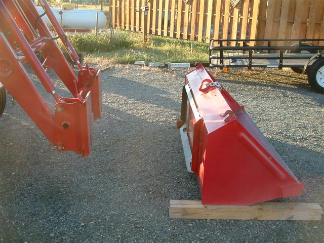

You might also think about getting a skid-steer-type quick attach unit for your FEL (cost is about $1000)

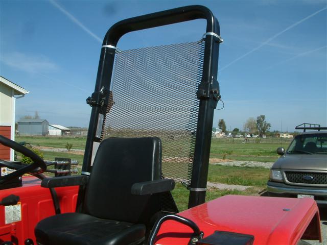

Since you'll be doing a lot of brush hogging, think about installing a protective screen on your ROPs to protect your backside.
[/ATTACH]
Mine is piece of expanded metal from Home Depot held onto the ROPS with hose clamps (don't weld or drill holes in the ROPS--it's a piece of safety equipment that could be weakened by welding and drilling).
