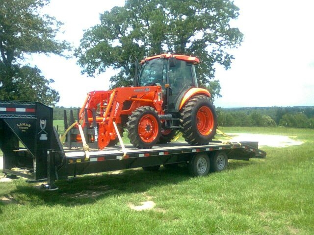

Pulled many 4x4 cat backhoes with a 3/4ton single cab chevy gasser on 32ft,20k trailer,some trips 100+miles done good.
What if you went with a full width lowboy triple axle GN...
You talkin about something like this, foreman Etexas?
Top Hat Trailers
I didn't even know they made such a thing. I sure do like the fact that it would sit low.
I was thinking about maybe one of these originally:
Top Hat Trailers
Top Hat Trailers
Top Hat Trailers

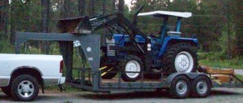

Yeah something like that,I like the fact they are lower also but gotta look at the width cause I believe some are just 6'wide if doesnt have the drive over fenders on it. Here is mine new 7040#2.JPG,its a good 14k trailer,I think you would run out of trailer before truck but with the triple axle you could get more load over the axles with just alittle on your truck and should pull really good.
   / What size gooseneck trailer? #39

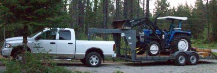

Yeah something like that,I like the fact they are lower also but gotta look at the width cause I believe some are just 6'wide if doesnt have the drive over fenders on it. Here is mineView attachment 312126,its a good 14k trailer,I think you would run out of trailer before truck but with the triple axle you could get more load over the axles with just alittle on your truck and should pull really good.
This is the setup I use the trailer is a Wilson it might be just a little on the light side of what his tractor weighs (2 6000 lbs. axles) although rated payload weight is 10,000lbs. so this would be a minimum and it is a 5 th wheel but the hitch is removable. it will accomodate 80" widthsaugust tractor fishing 013.JPG also this is a tilt trailer... just another option
