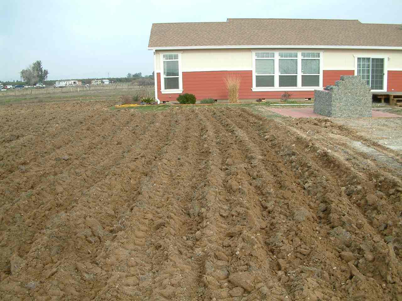

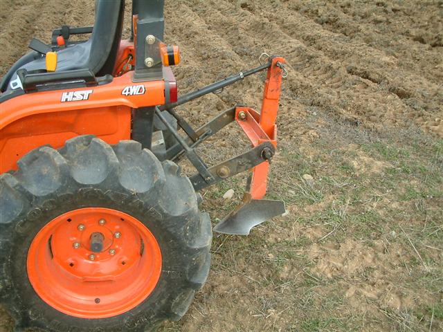

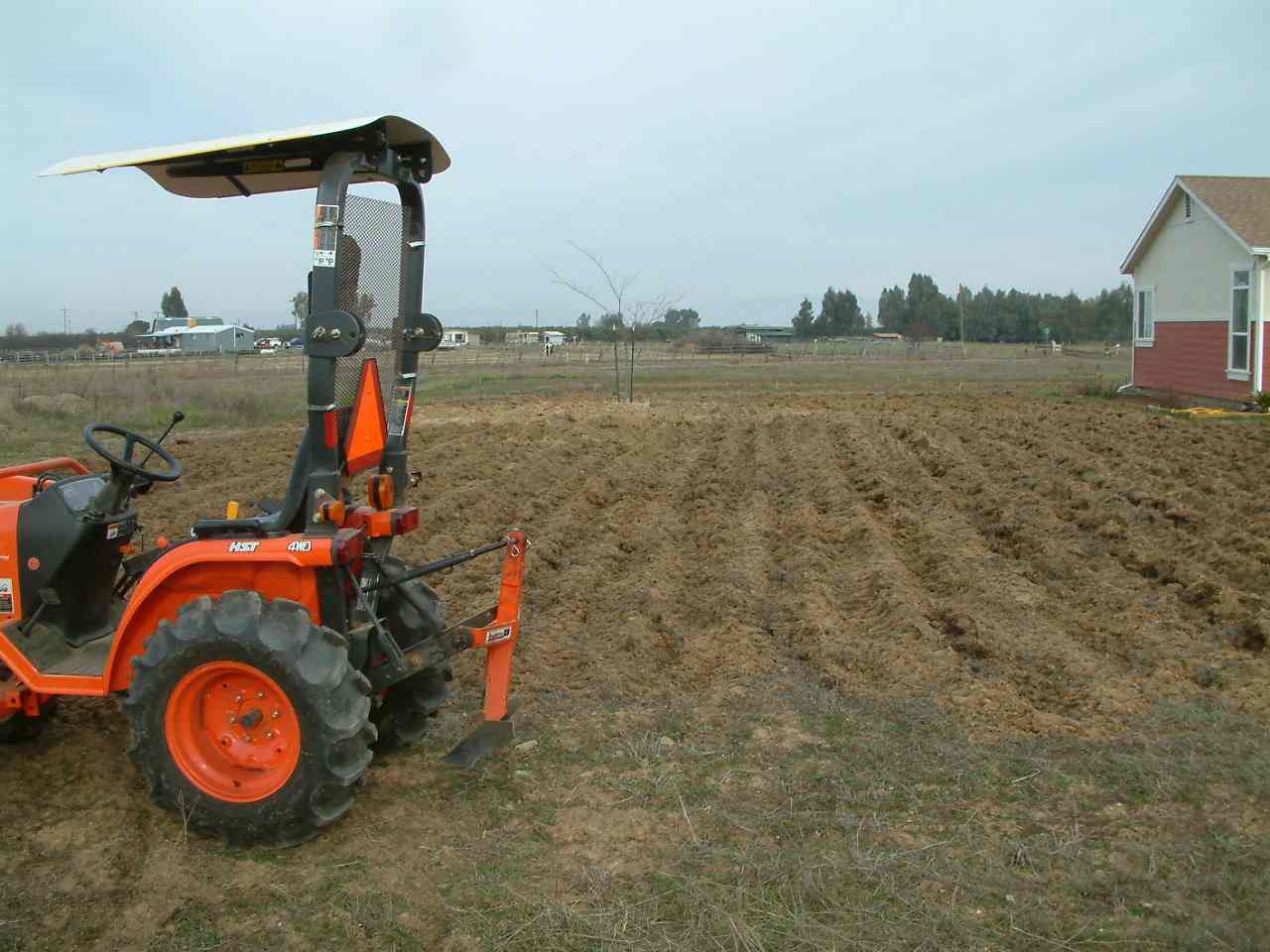

Hmmm potatoes. Maybe you need a potato plow (aka middle buster, ~$150 from Tractor Supply). Easy to use and your garden is pretty small.
I used one of these behind a little 2005 Kubota B7510HST (21 hp engine, 17 hp pto, probably 15 hp on the drawbar, 4WD, hydrostatic tranny, power steering) to plow the ground when I landscaped my new house a few years ago.
Regardless if you use a moldboard plow or a middle buster, you need some way to bust up the clods (tandem disc, rototiller). I used a 4-ft Yanmar RS1200 rototiller on my lawn area and smoothed it out with a simple tire drag behind my riding mower.
View attachment 193687View attachment 193688View attachment 193689
GREAT JOB Flusher! Yes, I do have a middle buster and a 6.5' heavy gang disc. I have thought about doing exactly as you did. But, I've been 'wanting' another implement so.........(lol)..... Besides, the "classic" 2-bottom plow would look a WHOLE LOT BETTER behind my tractor in the parade than a middlebuster would.... See where I'm getting at?? (hehe)
