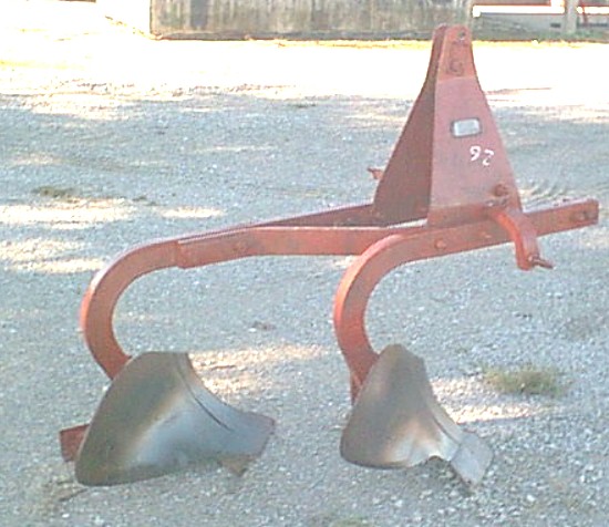

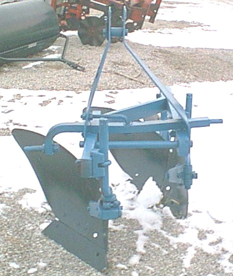

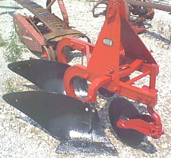

Travis, with that tractor, you definitely need a 2 bottom plow. Here are some that we have below. The first one is a Dearborn 2-12 at $395 and the second is a Ford 2-14 with coulters at $450 and the last one is a Ford 2-14 with coulters at $450 + shipping. The plow at $395 will plenty good for a garden plot. Ken Sweet

As for the Ford 2-14 RED PLOW, I really want it!! If you could bear with me for a little while I'd greatly appreciate it. But if you have to sell it, I understand that too because I know how tough times are right now. Trust me... I am waiting on some money to come in. I'm not sure when it'll be here but hopefully it's soon. The day I get it, I'll be calling you to buy that plow, if you still have it.
No, I don't need a 2 bottom plow but I'm certain my Massey will handle it. Besides, I've always wanted to put my tractor in the local parades with a 2-bottom plow on the back of it!

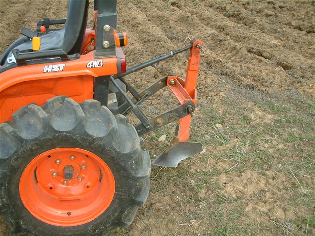

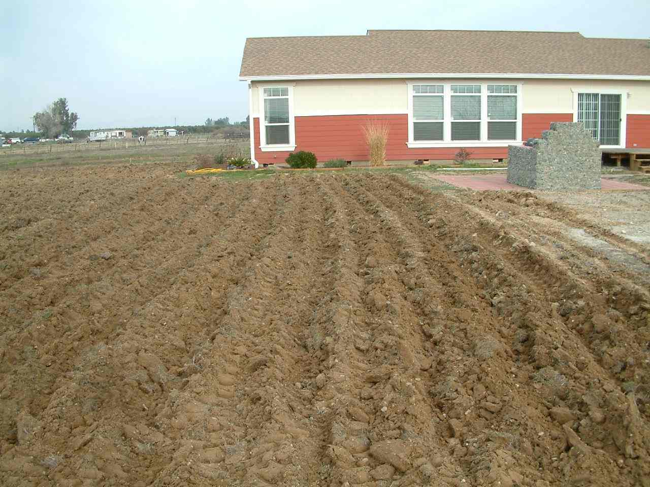

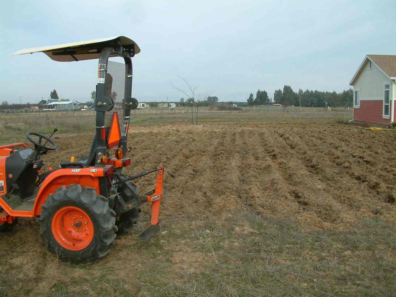

Hmmm potatoes. Maybe you need a potato plow (aka middle buster, ~$150 from Tractor Supply). Easy to use and your garden is pretty small.
I used one of these behind a little 2005 Kubota B7510HST (21 hp engine, 17 hp pto, probably 15 hp on the drawbar, 4WD, hydrostatic tranny, power steering) to plow the ground when I landscaped my new house a few years ago.
Regardless if you use a moldboard plow or a middle buster, you need some way to bust up the clods (tandem disc, rototiller). I used a 4-ft Yanmar RS1200 rototiller on my lawn area and smoothed it out with a simple tire drag behind my riding mower.

View attachment 193687View attachment 193688View attachment 193689
GREAT JOB Flusher! Yes, I do have a middle buster and a 6.5' heavy gang disc. I have thought about doing exactly as you did. But, I've been 'wanting' another implement so.........(lol)..... Besides, the "classic" 2-bottom plow would look a WHOLE LOT BETTER behind my tractor in the parade than a middlebuster would.... See where I'm getting at?? (hehe)
