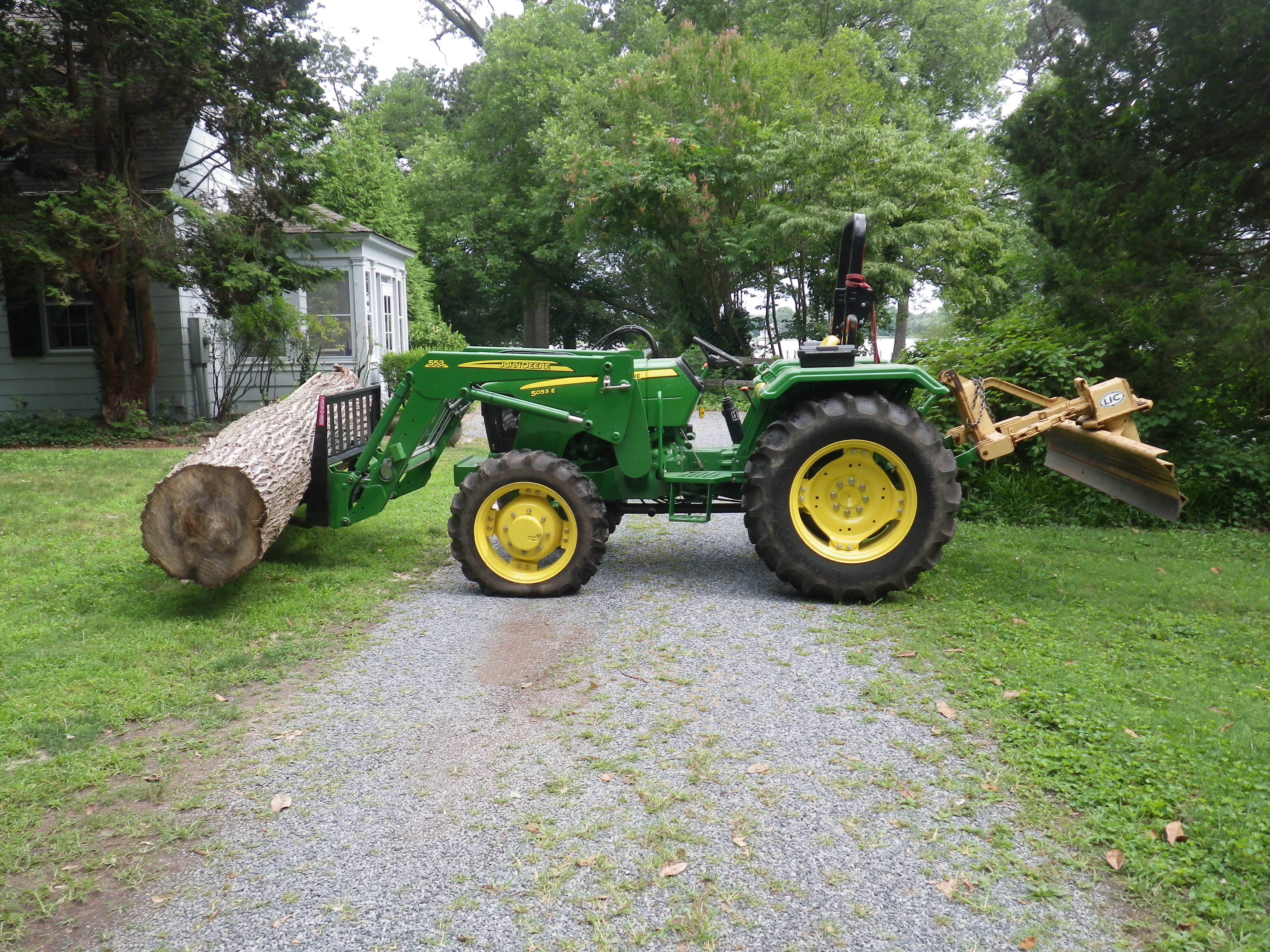

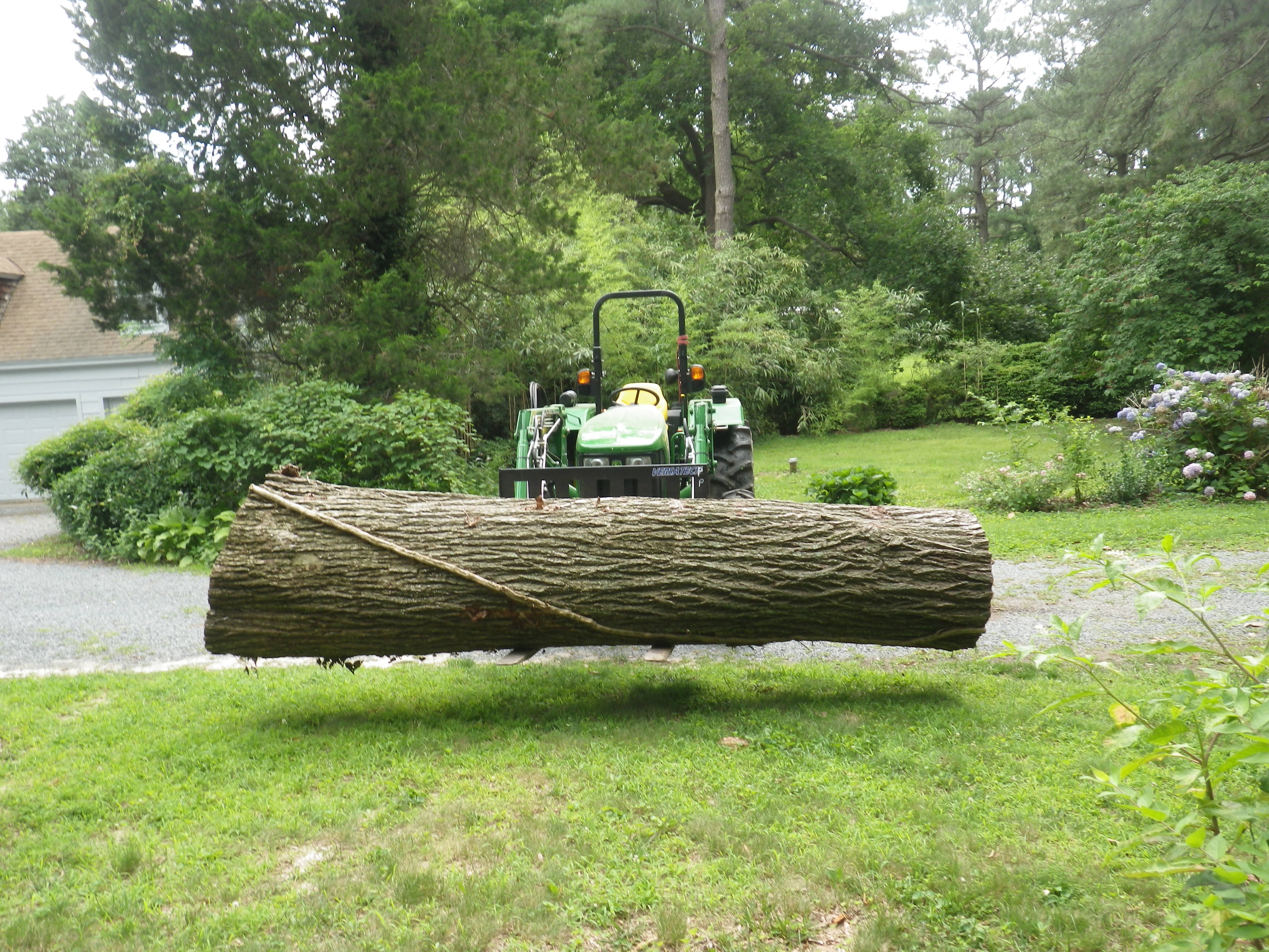

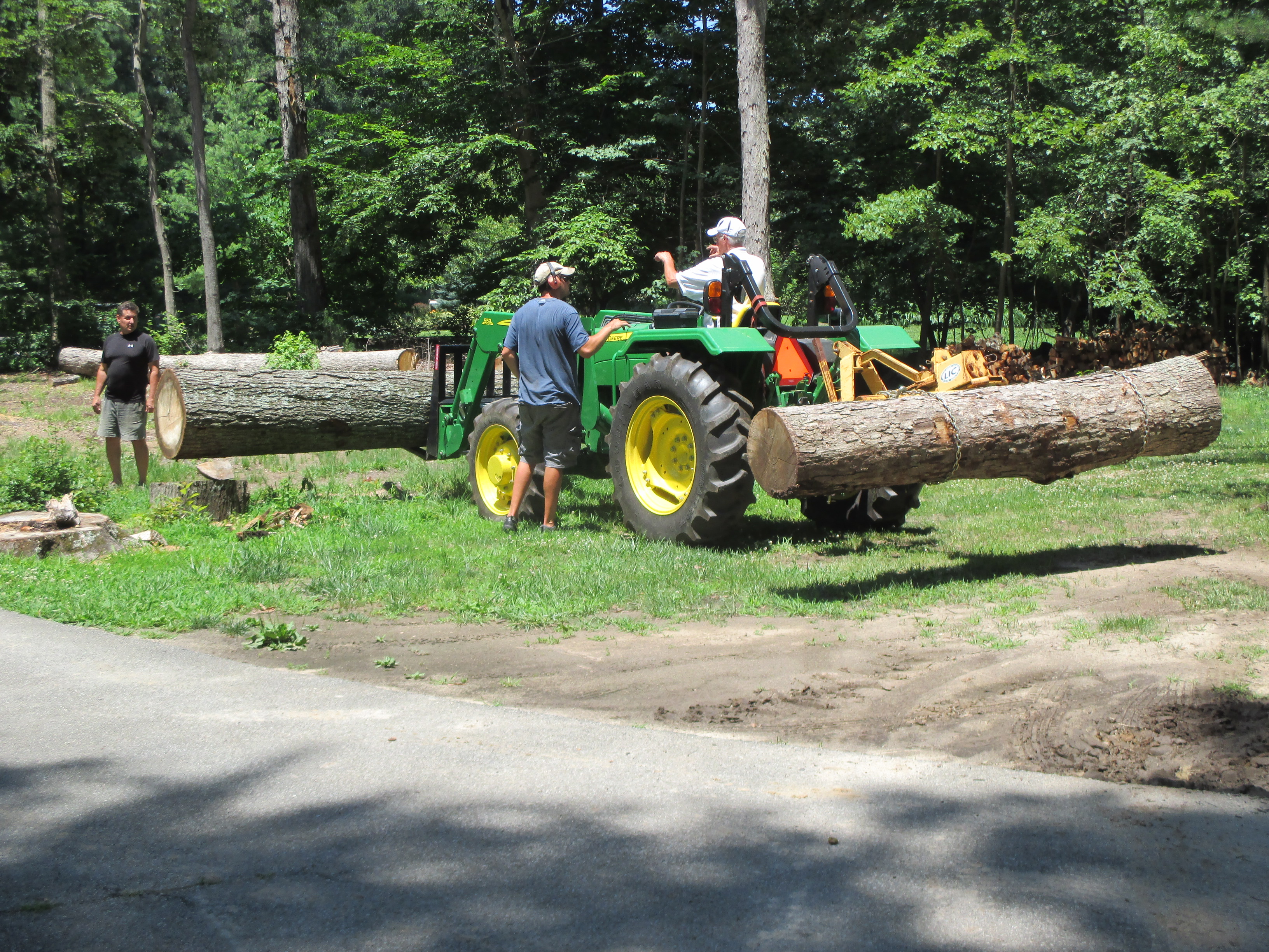

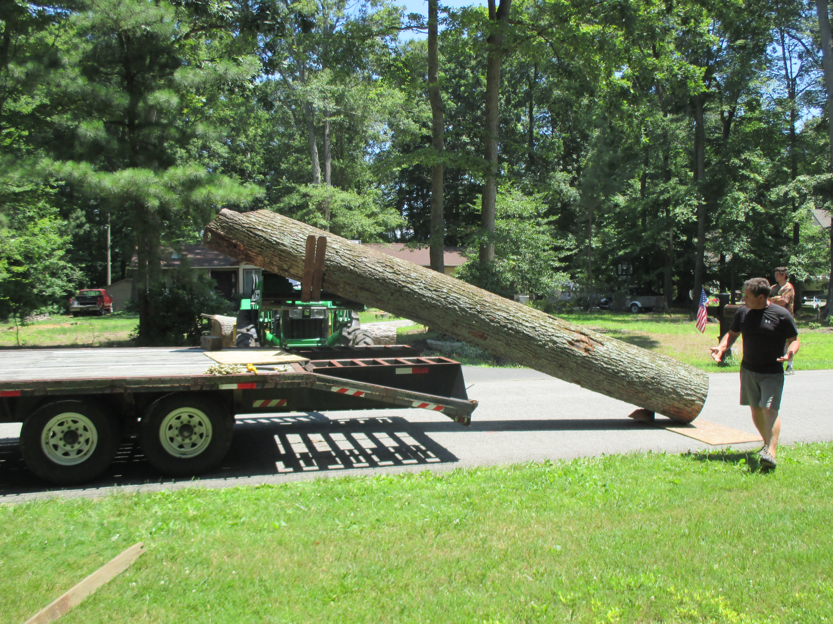

you don't need a 100hp tractor. the 5 series deere is plenty. i have a 5055E with the 553 loader. loader specs almost 3200lbs at the pins to full height and almost 5000lbs to 59" again at the pins. i can't remember what the measurements were 500mm and 800mm in front of the bucket, but i could check the owners manual at the office.
couldn't lift this log onto the GN, but it would lift it almost high enough. green white oak i think it was 15 ft long and 30" around
this was elm 34" on one end 40" on the other 13-14 ft long. had to remove the fender to loader it on my car trailer
Specs for your loader
Breakout force (at pin) 5,378 lbs [2439 kg]
Breakout force (at 800mm): 3,604 lbs [1634 kg]
Lift to full height (at pin): 3,133 lbs [1421 kg]
Lift to full height (at 800mm): 1,956 lbs [887 kg]
Lift to 1.5m (at pin): 4,008 lbs [1818 kg]
Lift to 1.5m (at 800mm): 2,891 lbs [1311 kg]
