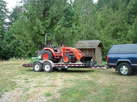

I second gravel13's comments. Make sure the trailer measurement is for the BED and not the overall length. I'd recommend a bed length of 20' minimum with an overall length of 22 - 23'. If you buy one too short, you'll be sorry. No offense to the other guys, but your machine is a CK30, not a CK20. You'll need a bigger trailer, especially if you have an FEL and something on the back. I have an LK3054 with FEL and backblade in the attached picture. It is on a 20' trailer with an 18' bed and it's a super tight fit. I wish I had more room - don't make a mistake you'll regret /forums/images/graemlins/crazy.gif.
Just returned from a couple of weeks setting up the foundation for my 40x50 storage shed. A couple of red hot days produced enough break time to finally get out the measuring tape. Highbeam/Joe here is the promised follow up. Although my overall trailer length is 19' 2" the deck only measures 16' 0" so the mystery is solved. Now onto some useful (maybe) measurements:
13' 0" = Kioti 3054 with KL122 loader attached
2" 3" = Box Blade (60" width)
6' 10" = Rotary Mower (60" width)
3' 5" = Back Blade (60" width)
5' 7" = Chipper with hopper/chute attached
5' 5" = Post Hole Digger
3' 3" = Rear forks
All the above are 3PH attached and were measured from the center of the 3 point pin to the back of the attachment. So my machine with a rotary cutter attached would require a 20 foot trailer deck with no wiggle room to balance the load. Looks like it might be time for me to search for another trailer soon but there's too much other work to be done. I'll soon be erecting my storage shed and hope to post some pictures in the Projects forum as it goes up. Wish me luck :D.
