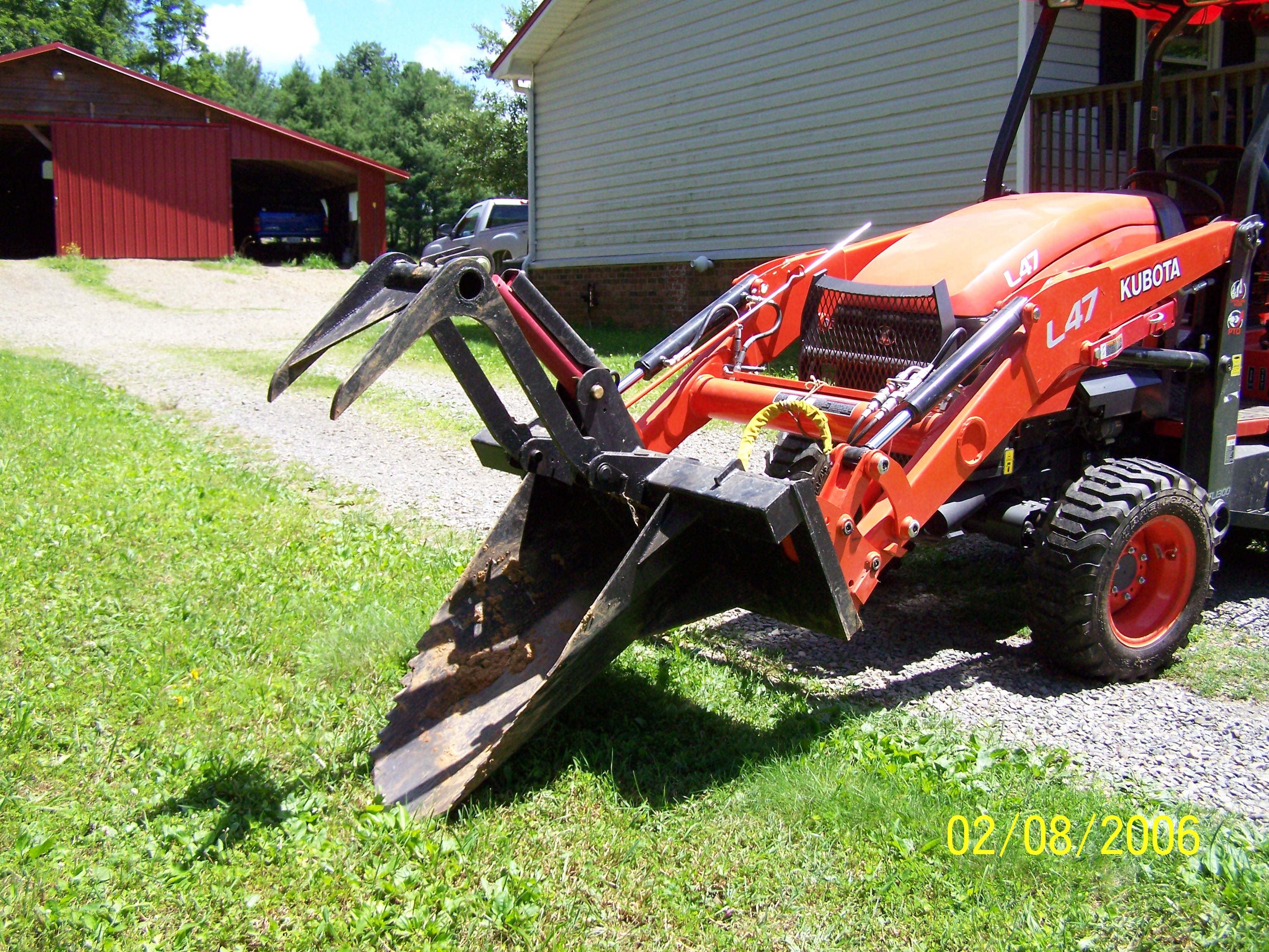

I like my "spade shaped" bucket w/grapple. I bought it from #37 Spade Bucket | MS Attachments
The list price now is $650 or $600 wo/the grapple. The grapple is very handy for stumps and small bushes.

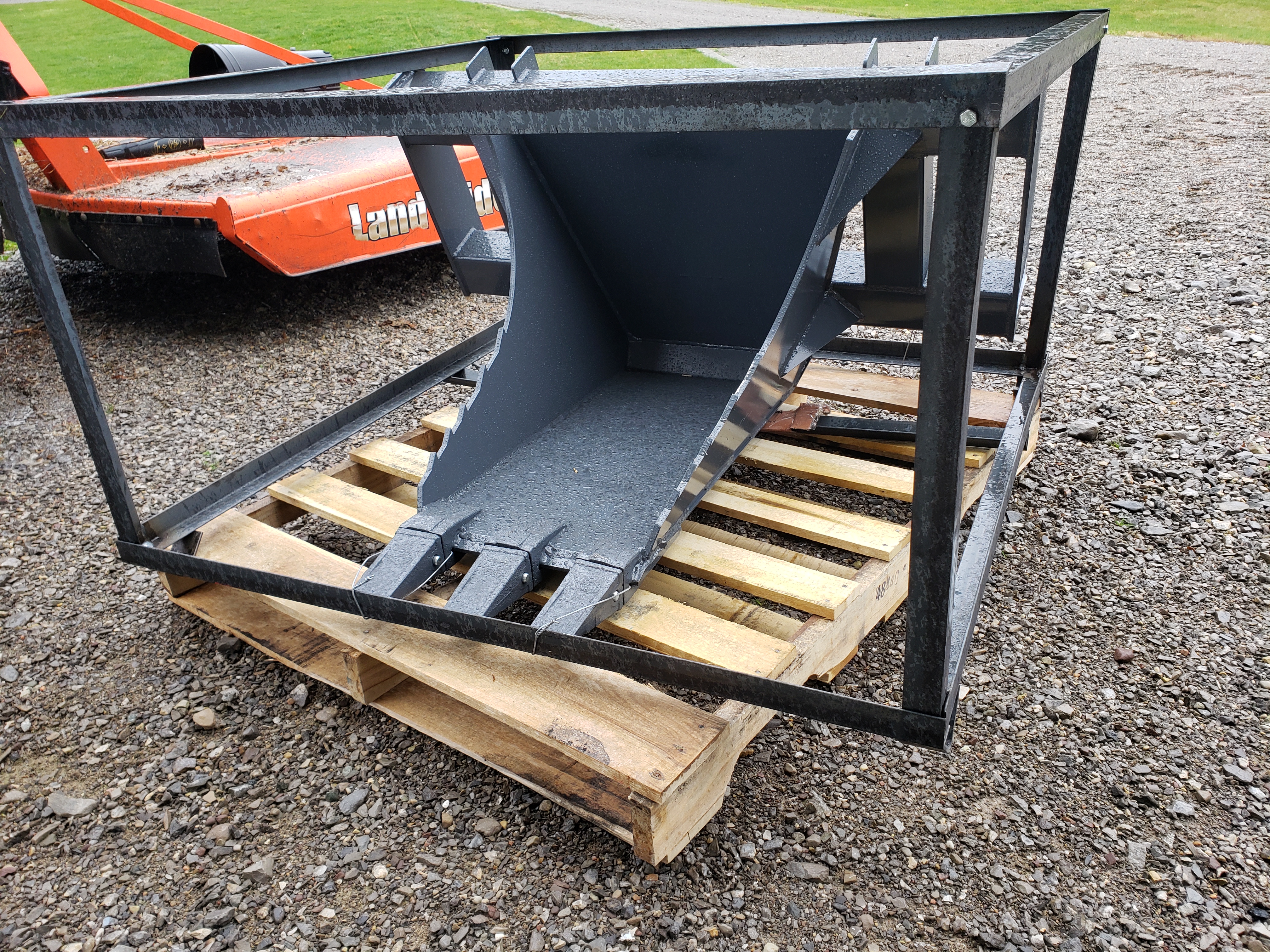

Shipping on this was very fast. Too fast for me in this case as I had to push off delivery a few days around the holidays. Item arrived with no dings of any kind on a pallet surrounded by a metal cage made of angle. Looks like a few screws and possibly a cutting wheel will have that disassembled quickly.
   / What Stump Bucket for MX5200
#23
Had 20 minutes of daylight to get it uncrated, attached and to dig something. The crate top was held on by 4 bolts and then I was able to just lift and shimmy the bucket through the bottom part which has the vertical supports tack welded. I hooked up with no issues and the attachment point is perfect with the ssqa (as it should be). I dug out four large rocks / small boulders in the 1-2' range with ease. The hardest part was getting the rock up in the bucket. I would normally just pick-up and move stuff with the grapple, but this worked. I stuck it into the ground just to see how easy it would dig, and it ripped into the ground like butter. When it dries out, I need to go after a few of my stumps and see what it will do.
Two features that would have been nice are drain holes in the bottom/back for water to escape and the tabs or hooks for a chain.

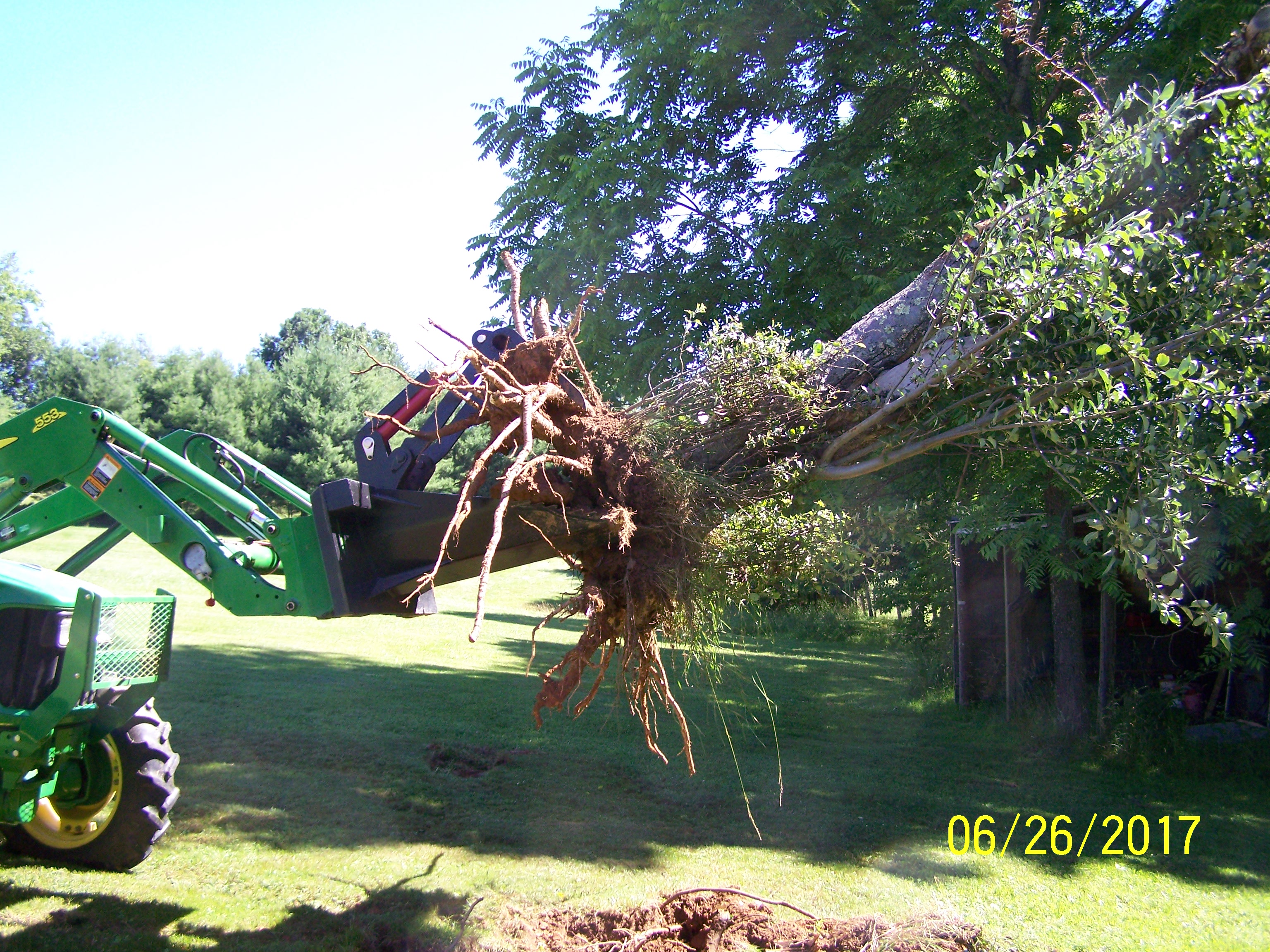

I've been clearing the woods behind my house. Had been using a L3901 but traded it to a MX5400 and the MX will push over small trees that would stop the L. I also bought a attachment that uses the SSQA and wraps the arms around small trees and by pushing and lifting takes out small trees. I pushed it past it's limits and have had to do some repairs/adjustments to it and man who sold/manufactured it sent me a larger pin which made it a bit more sturdy. Was using it on my former, former B26xx and never tried it on the L and think it may be to light duty for MX but will try it one day.
I'm considering getting the Titan Stump bucket and been doing lots of searching to see how it may work on my MX and found your post. So I am very interested in your experience and if you believe it is heavy duty enough for your MX. I figure 6" to 8" trees will be all I'd try and use it on and maybe too dig roots under bigger trees and then push the bigger trees down with the MX. Also to remove some close to the ground 6" to 8" stumps. Maybe do a bit of small trenching and maybe try and remove and replant some 6" fruit trees.
So appreciate any input with your actual MX/Titan Stump Bucket experience. I've bought several attachments from them. Have 48' adjustable forks, front back hoe (2nd one) and other items over the past few years.
#27
It is nice to find the attachments you are looking for with nearly the identical tractor for sure. I was worried about the thickness of the metal on the USA made version. It was 3/8" instead of 1/2" and the weight was a few hundred pounds less. I think it is going to be just fine from what I see so far, and I suppose it gives the tractor a few more hundred pounds of lift which is good. Now that snow has fallen I'm moving into wood collecting mode.
