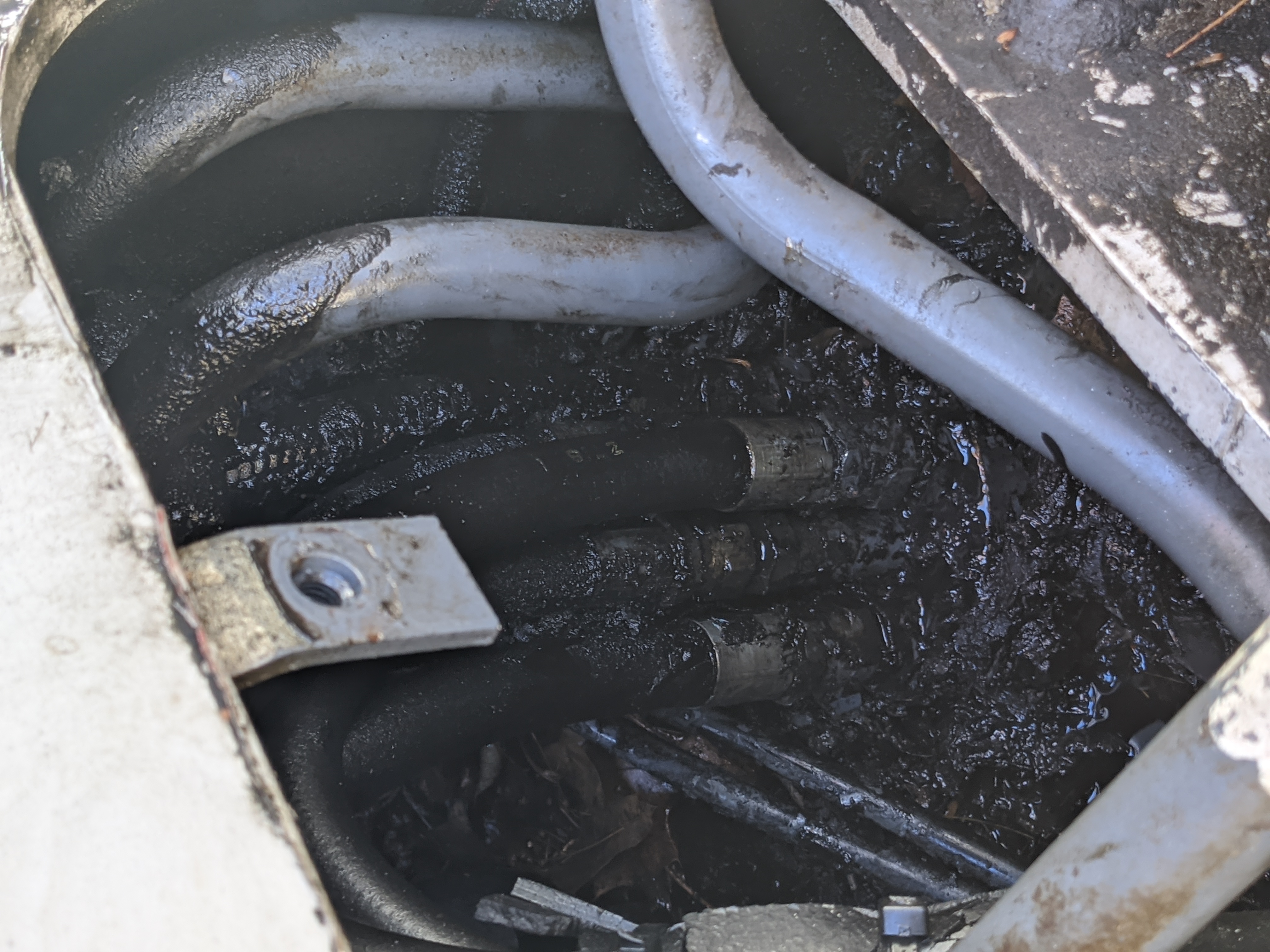

What the heck tool to get these hydraulic lines off?
   / What the heck tool to get these hydraulic lines off? #11
Sorry about the photo. Here is one of the lines. The one I need to remove is in the back but at this point I think I will try having them all replaced.
like all these machines you keed taking hoses off to get access, when i rebuilt the Bobcat 430 we cut and bent many wrenches to get into odd spaces
   / What the heck tool to get these hydraulic lines off? #12
Snap On, and probably others do make (or have made) crow foot flare nut wrenches in your desired size. I found one on eBay but it's almost $30.
Yup. Off the tool truck will be more. And paying someone else to do the job will be more yet because that guy already has the tools.
   / What the heck tool to get these hydraulic lines off? #13
One option is to cut the hose off and then use a socket to remove the fittings.
   / What the heck tool to get these hydraulic lines off? #14
Take the floor out of the operator station, that should give better access to the rear hoses and some extra elbow room to get a wrench in there.
   / What the heck tool to get these hydraulic lines off? #15
Well, that works good for off, but then there is on.
   / What the heck tool to get these hydraulic lines off? #16
They usually go back on with less required force, with a bit of sealant just a bit more then snug usually works plus you can do the easiest last.
   / What the heck tool to get these hydraulic lines off? #18
Careful use of an air chisel will get them as tight as you want.
   / What the heck tool to get these hydraulic lines off? #19
I'm always open to new tricks, but I'm not visualizing how you'd do this with an impact chisel. :confused:
Actually, I'm more intrigued by your comment as a way to loosen a pesky fitting. I have one right now on my 26 y/o B2150 where an FEL hydraulic hose connects to a rusted male 90-degree JIC fitting that's brazed/welded to a hard line on the top of the torque tube. I can get open-end wrenches on both fittings, but it's hard to keep the hard line from twisting as I apply steady pressure to the hose-end fitting. If I damage the weld, it will become a big problem. The hose seems fine for now, so I've avoided further efforts on the "not broke, don't fix it" principle.
I was thinking that maybe a crow's foot wrench chucked onto a 3/8" impact wrench, or onto a 1/4"-to-3/8" adapter in a more gentle impact driver might do the trick. Hadn't thought of an air chisel.
   / What the heck tool to get these hydraulic lines off? #20
Heat the nut of the JIC fitting to a dull red on one or two flats. Let it cool then disassemble with your open end wrenches.
