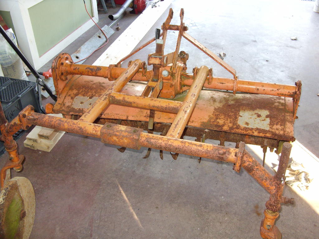

I just picked this up for next to nothing for my FX18D and am not quite sure what kind it is. The markings are all gone but it seems that the serial plate had japanese writing on it with the numbers RS1200 and 22197 which I guess is the serial number. Could this be a Yanmar RS1200 tiller?

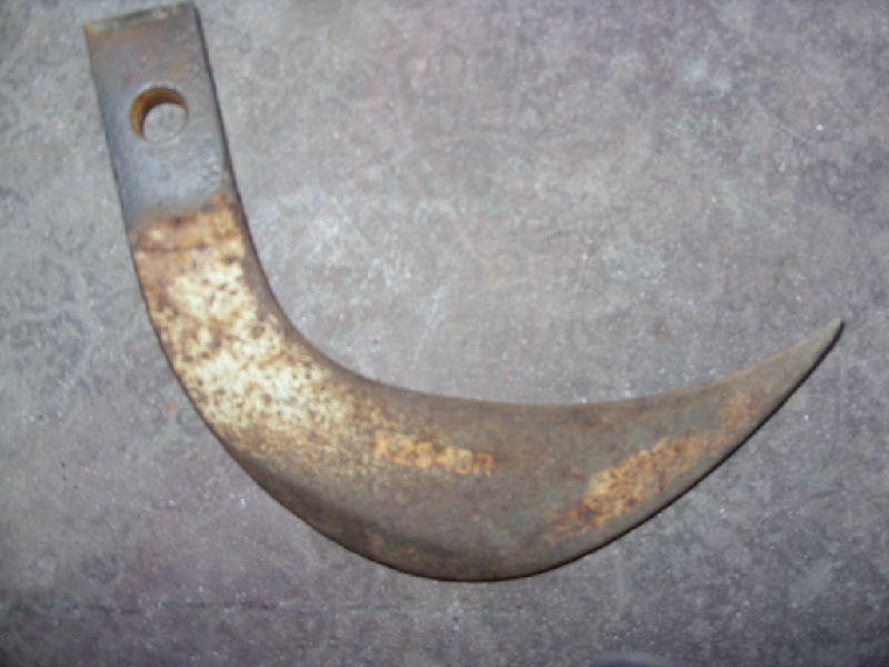

Several tines are missing. They are marked 2545R and 2545L, I assume for right and left. I did a search here and maybe Danny Parker with Parker Euipt. here in Alabama might be a source? Anyone know where they can be had? I just need two. The shank of the tine measures about 9/16 x 3/8 thick and is held in with about a 10 mm bolt. Any help would be appreciated!

Since you are from around here. Check with danny...I have his ph # if you need it. I can pm you with it
/ What tiller is this? #4

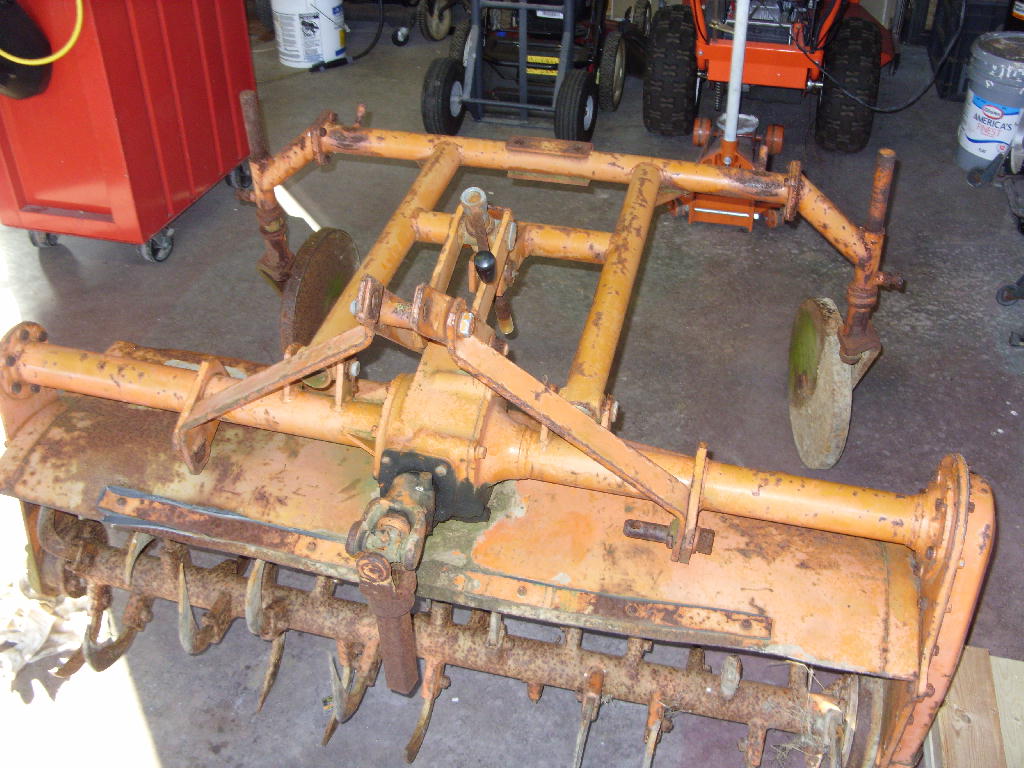

It lookes alot like my Yanmar tiller, it has the same teeth as mine.

Yes it definately is a chain drive, and the id plate is stamped RS1200 which leads me to beleive its a Yanmar. Maybe some one here has a 1200 that they could verify that there's is a chain drive.

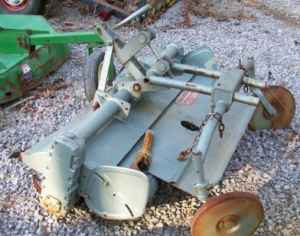

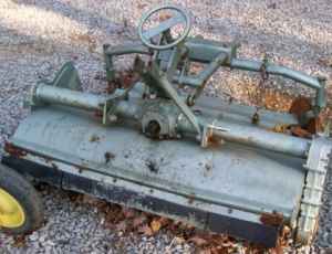

This was posted on CL.ATL. 4ft Yanmar Tiller.Might try to reply and ask for the Specs.The drive side cover does look different.

Isn't anyone going to tell him he needs a whole set of tines? I guess you will figure it out when you get the two new ones.
/ What tiller is this? #12
Good point he might want to make that guy an offer for the cost of parts and hoping the shaft is not damaged.1 HR drive ? HRS. in repairs.

California...Thanks for the pictures...really confused now..LOL...I also have been unable to find a pic of a Yanmar with the same side cover as mine...only a Kobuta..but the RS1200 stamped on it has me stumped.
Danny...I guess you've figured out that I'm the one that emailed you regarding the bearings for this. If we can figure out what this is I will replace both sides. I'll try to get some pics of the chain drive area and post them here so maybe you can verify the make. Any other way to tell exactly which one this is?
