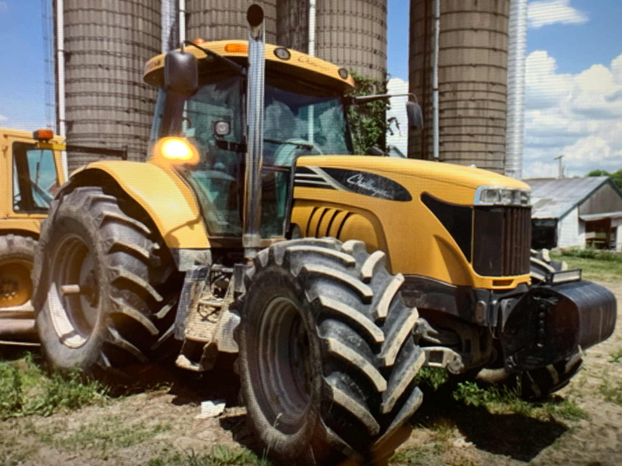

I just got done 4 days straight of driving over logs and stumps with R1’s carry logs and brush in my grapple.
No sidewall damage, no flats.
They make heavier R1’s for that type of work you know?
Heres actual log skidder tractor photos
These look a heck of a lot more like R-1s than R-4s

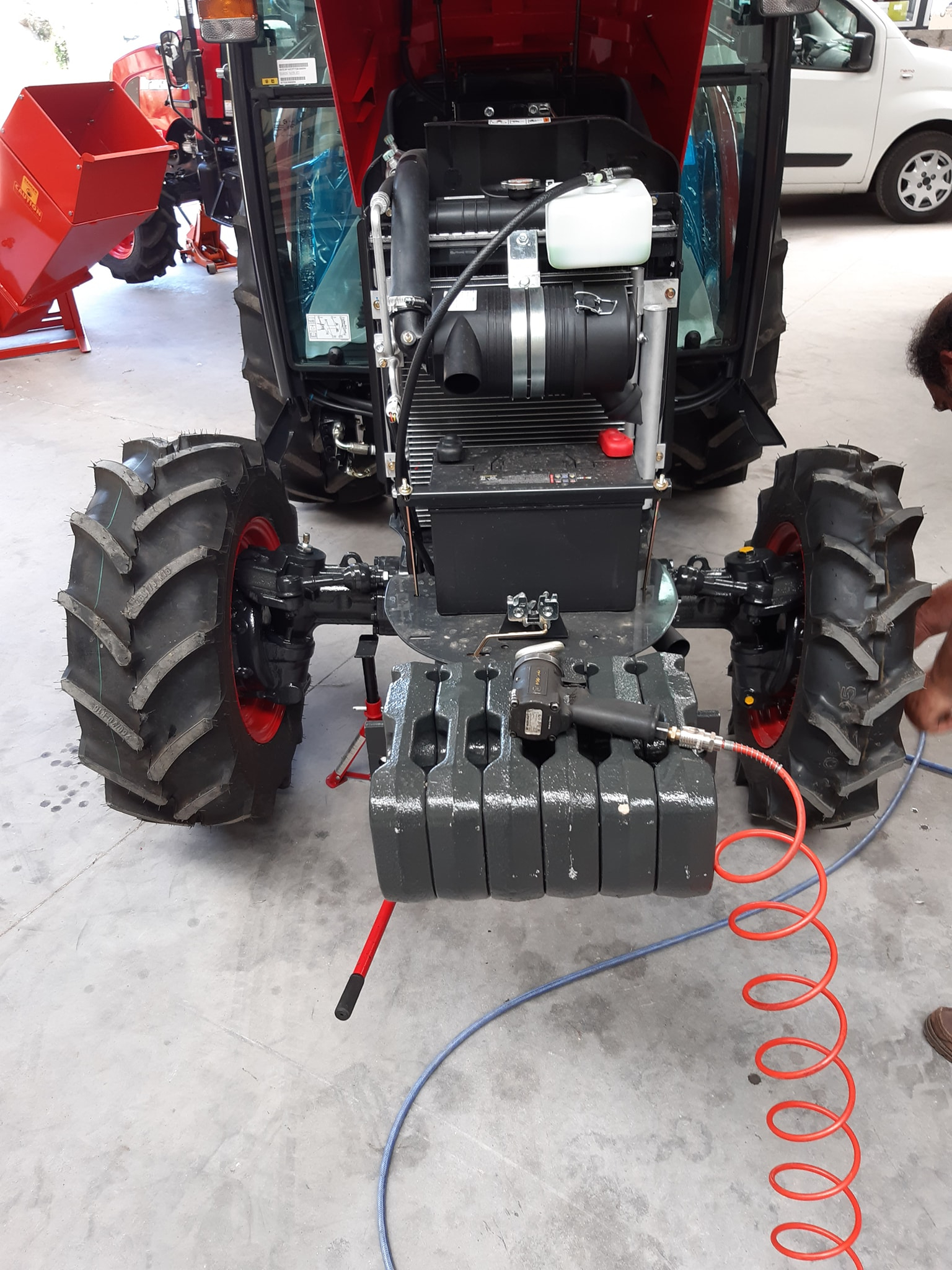

Those R1s on the Kubota in the first picture are wider than the R4s that go on the L3301
   / What tires should you get on a new Tractor, R1, R4, or Turf? #42
You can get wide rubber for your tractors if you want it. In some ways, wider R-1’s reduce traction in that they don’t dig down like narrow pizza cutter R-1s. However, I prefer the flotation from them to keep up on top of grass fields.

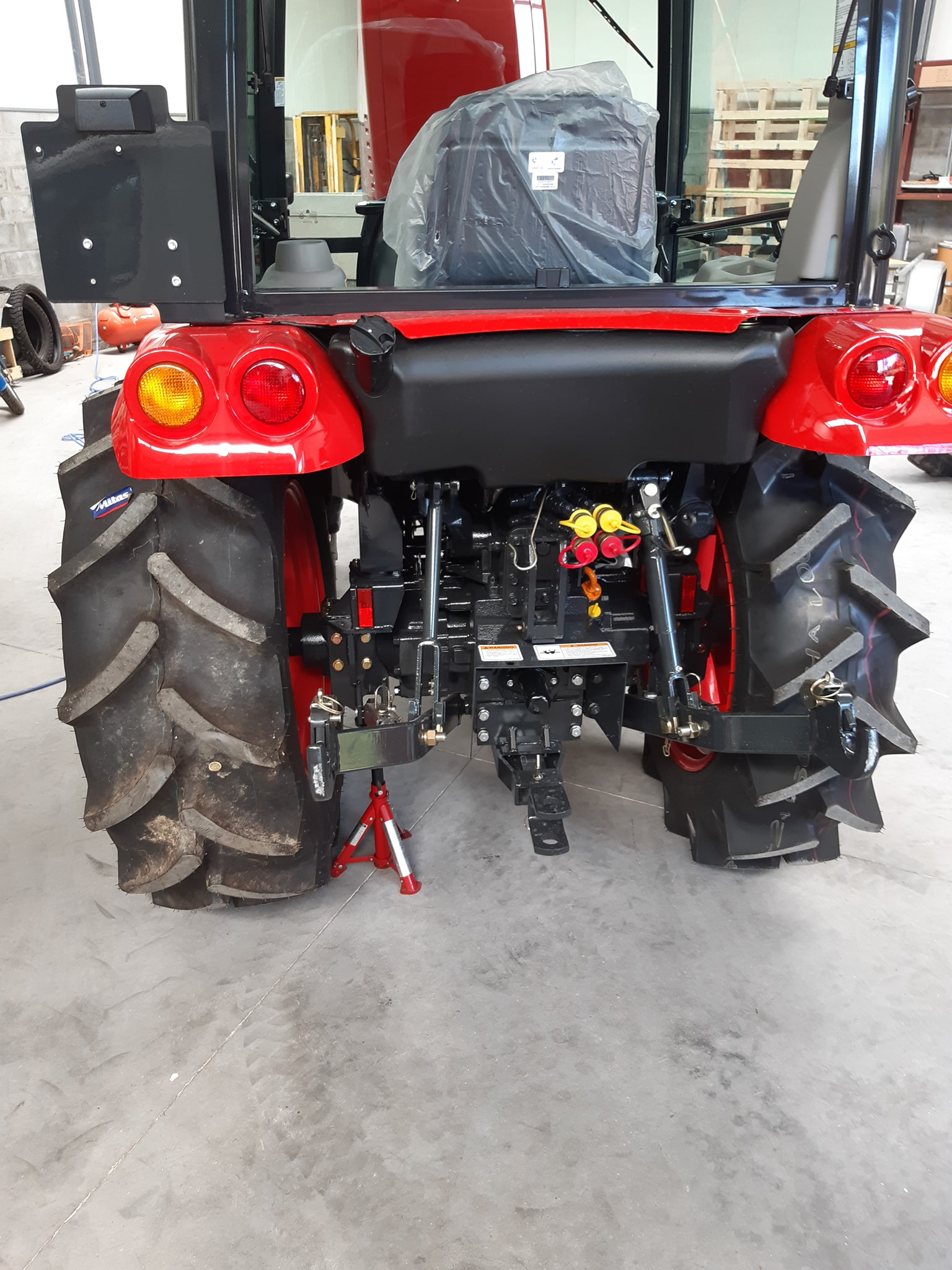

You guys would love wide R-1s. They have the paddle type tread for traction, but float on grass better-kind of like an R4.
Heres some extra wide R-1s (not my tractor)
   / What tires should you get on a new Tractor, R1, R4, or Turf? #43
Sure can. That what's used on this side of the pond on most tractors. Most come standard with the wide R1 Radials, even on 20 or 25 hp tractors.
I agree that people would love the wider R1 radials. Much better investment that doesn't really compromise the traction of the tractor compared to the R4.

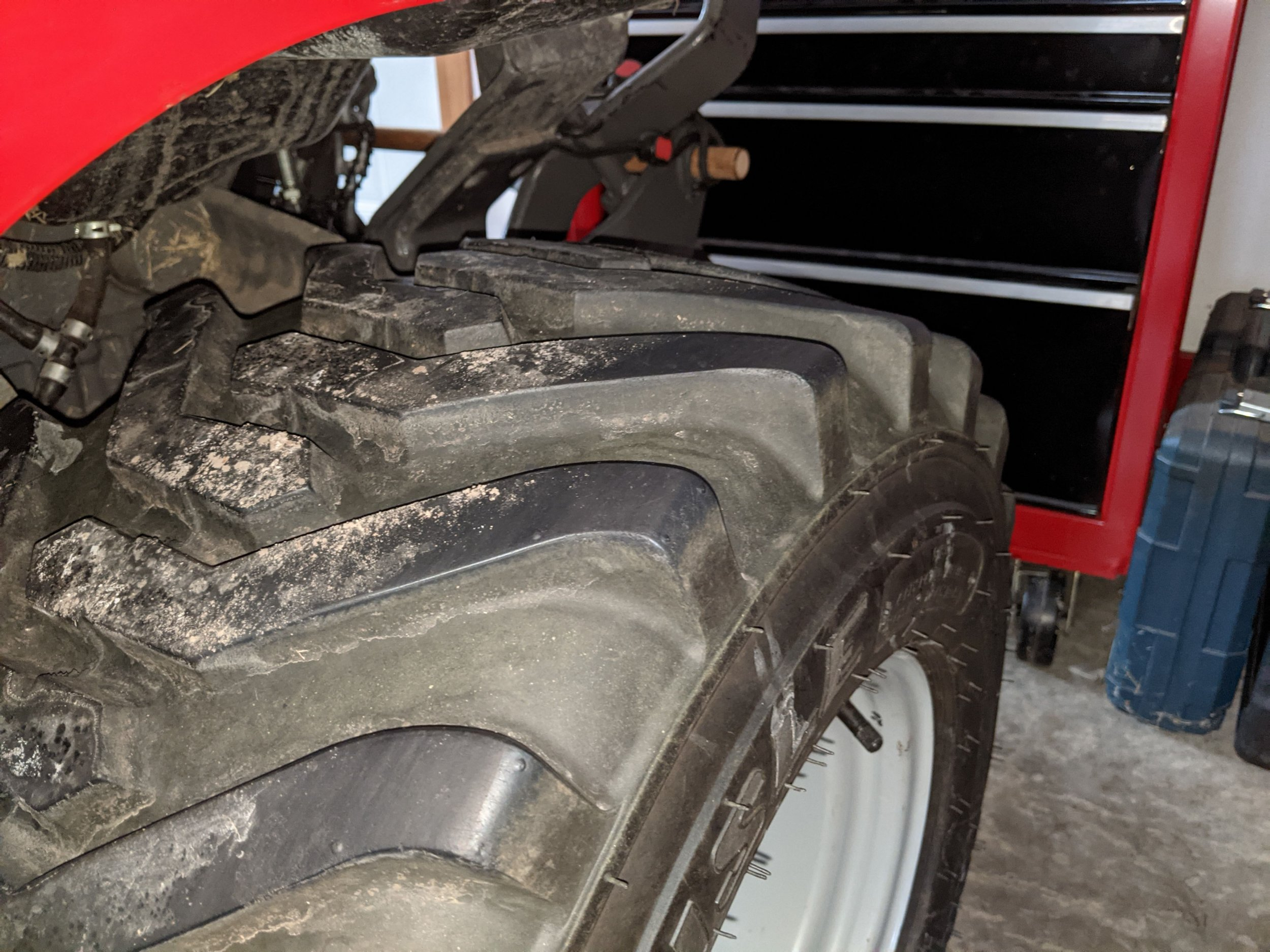

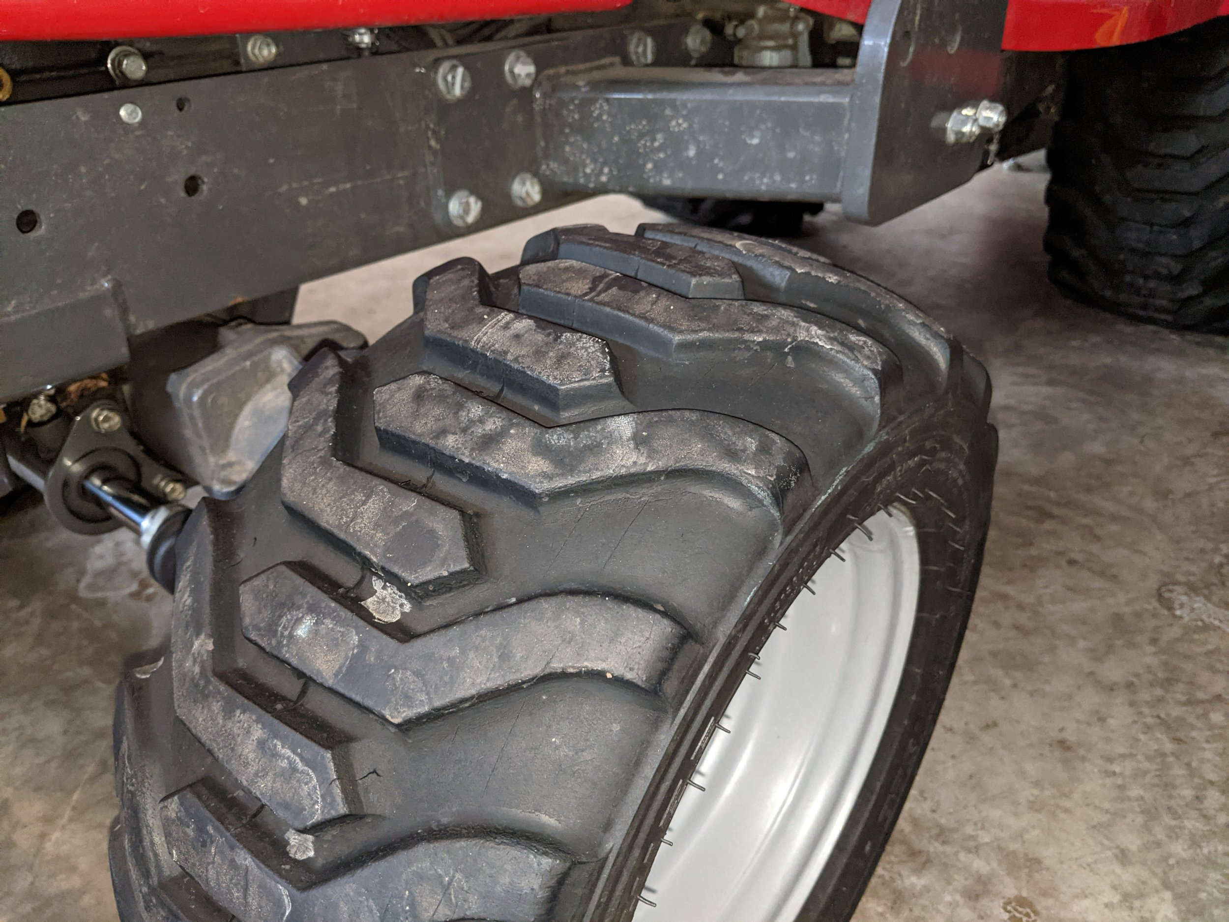

What makes it a R1 then, the tire design?
   / What tires should you get on a new Tractor, R1, R4, or Turf? #45
View attachment 732562 View attachment 732563
Its like an R4 carcass with R1 tread.
