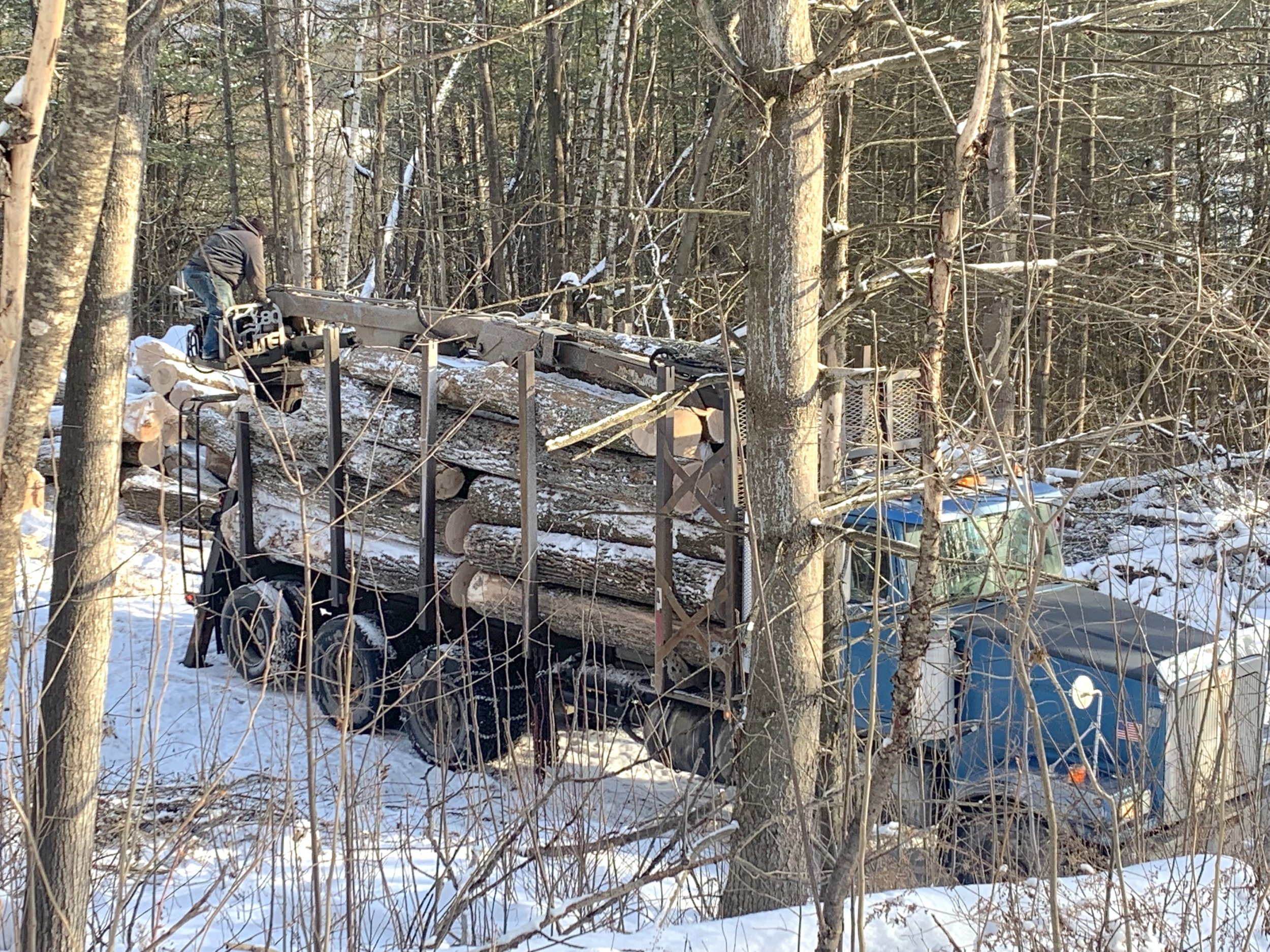

As it happens, we just finished a logging job on a property I own jointly a few miles down the road. When we put the contract out for bid, we specified that it would be done under frozen winter conditions, to protect the soils and water quality. Here's a picture of the skidder used on the job. It may be difficult to see under the chains, but they are Ag style tread. Regardless of the tread, you simply don't see a skidder operator running without chains in this area in the winter.
Even the log trucks have chains:
