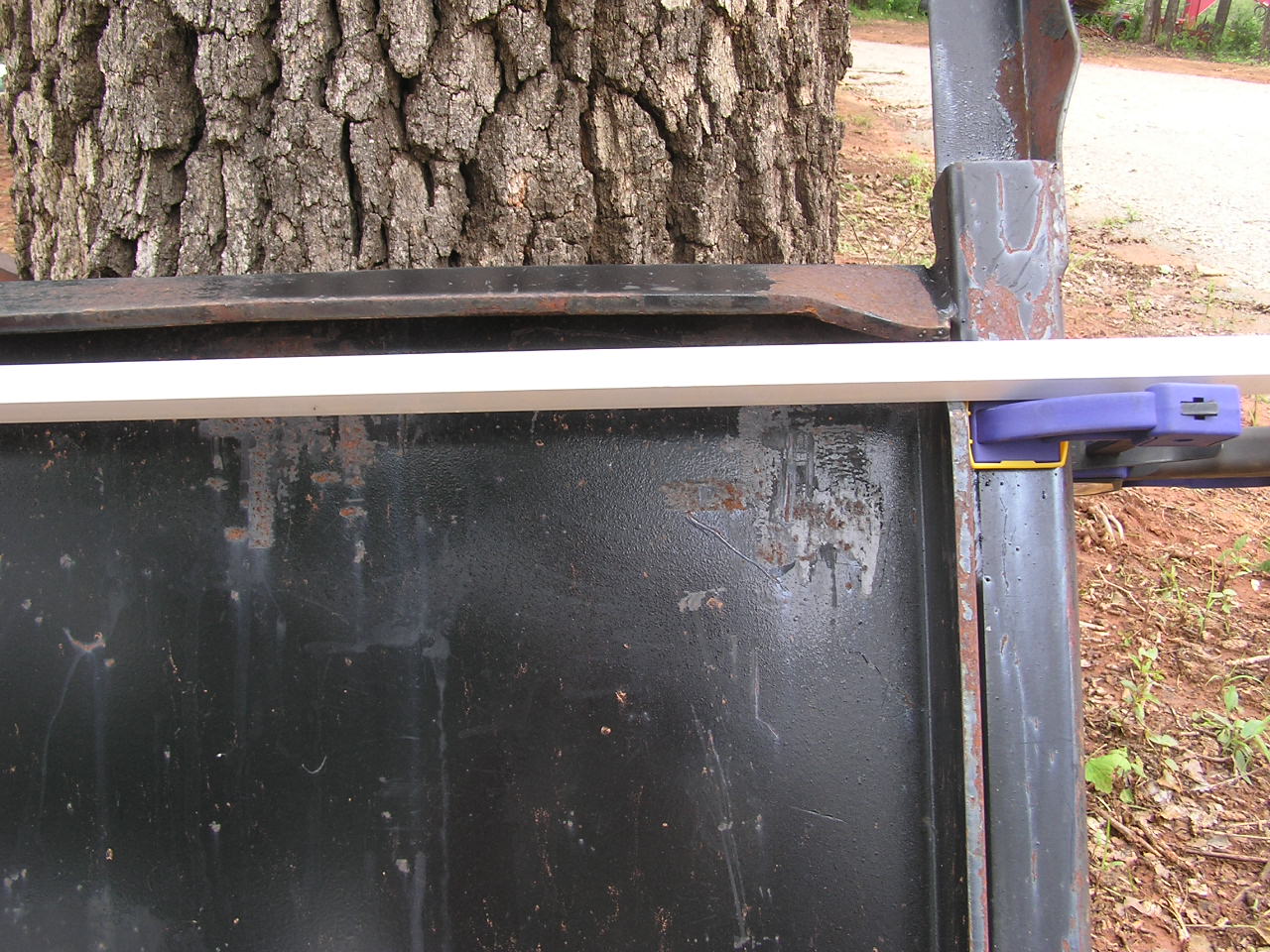

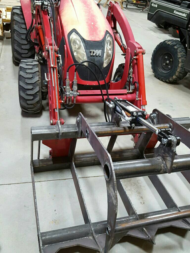

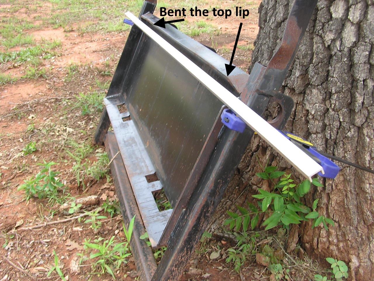

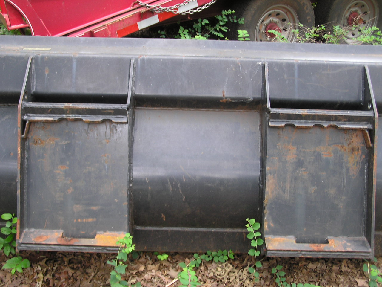

The gusset is to prevent the top lip from bending, like this shop made fork frame did.

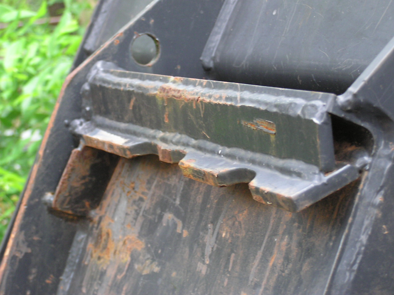

If that is so, why don't we see them on all standard buckets and all grapples etc. I can imagine that perhaps a monster skidsteer could bend the ssqa adapter but a CUT????
I don't know why, but I'd say in looking at grapple designs I found more had them than didn't. Many of them incorporate the lid hinge bracket as the gusset. I see Wildkat and EA do it on most grapples. Like I said, bottom line for me was it added a few ounces and felt it was worth doing on my first fabrication project.

Please be clear that I'm not criticizing at all. I just hadn't seen such gussets used before so am interested in why some use them and most don't.

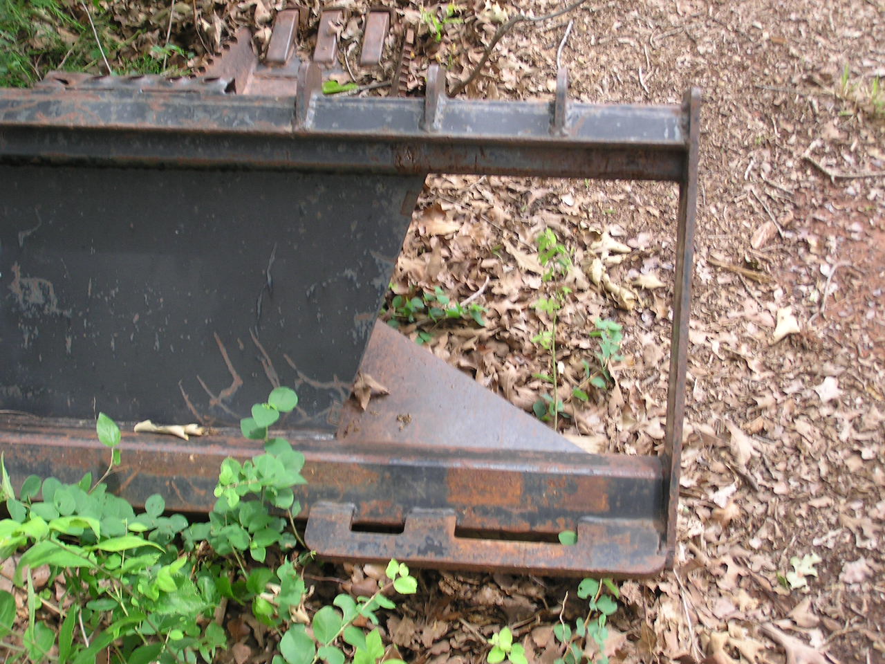

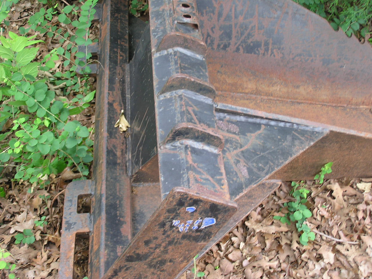

I think that you are right about the size of the machine.
The Bobcat one cubic yard bucket has reinforcement to prevent the top lip from bending:

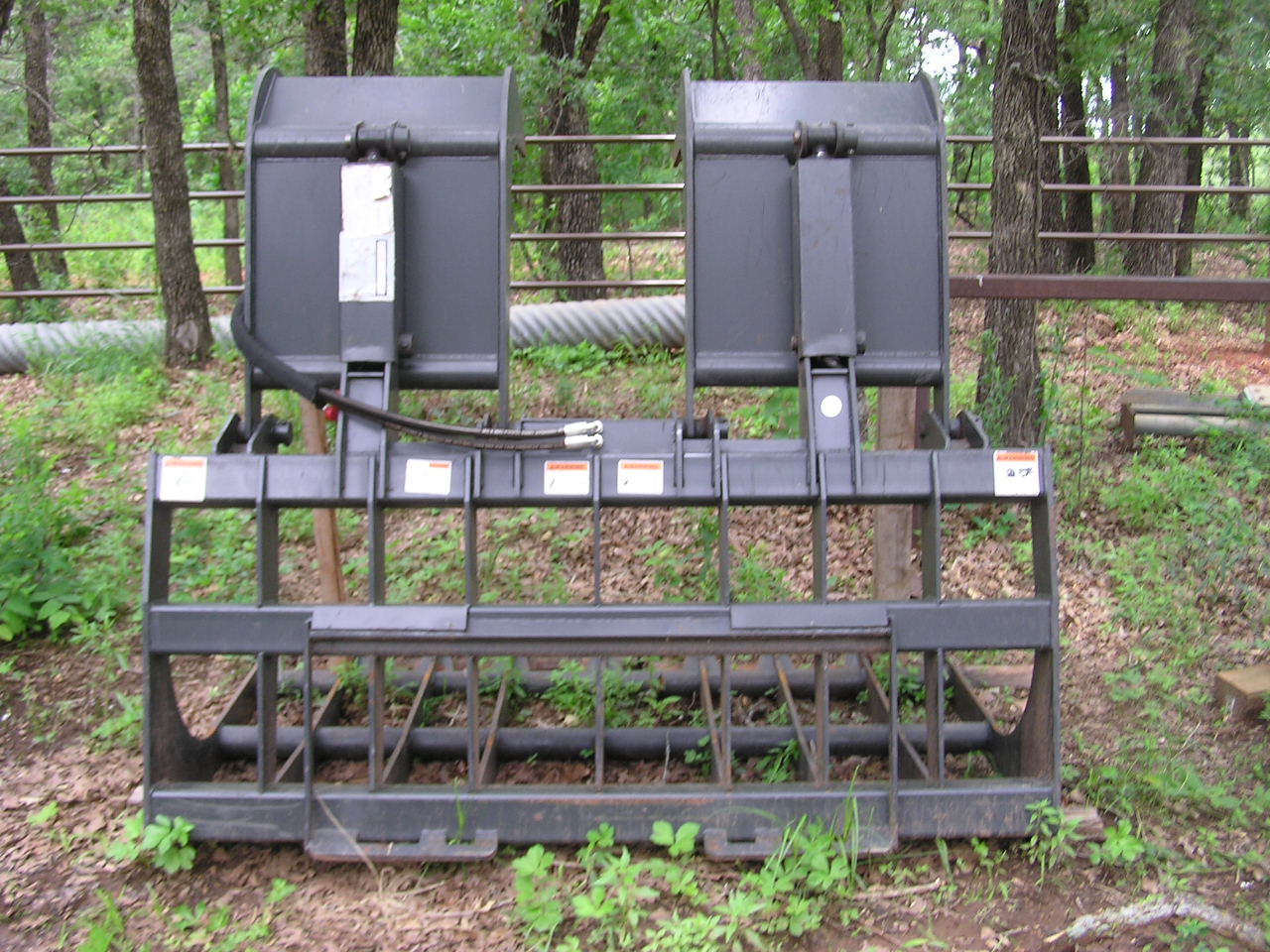

The Monster Grapple:
The Blue Diamond stump bucket:
   / What to build? 72ft of 6" wide flat bar #46
Those implements all look pretty beefy and likely designed for skid steers. As you implied, maybe that's where the gussets are necessary.
There is no way that my 5000lb CUT with 2700lb lift can destroy the SSQA mount on my light duty 48" grapple. However, a 100hp skidsteer with a pissed off idiot employee at the controls could certainly rip it apart.

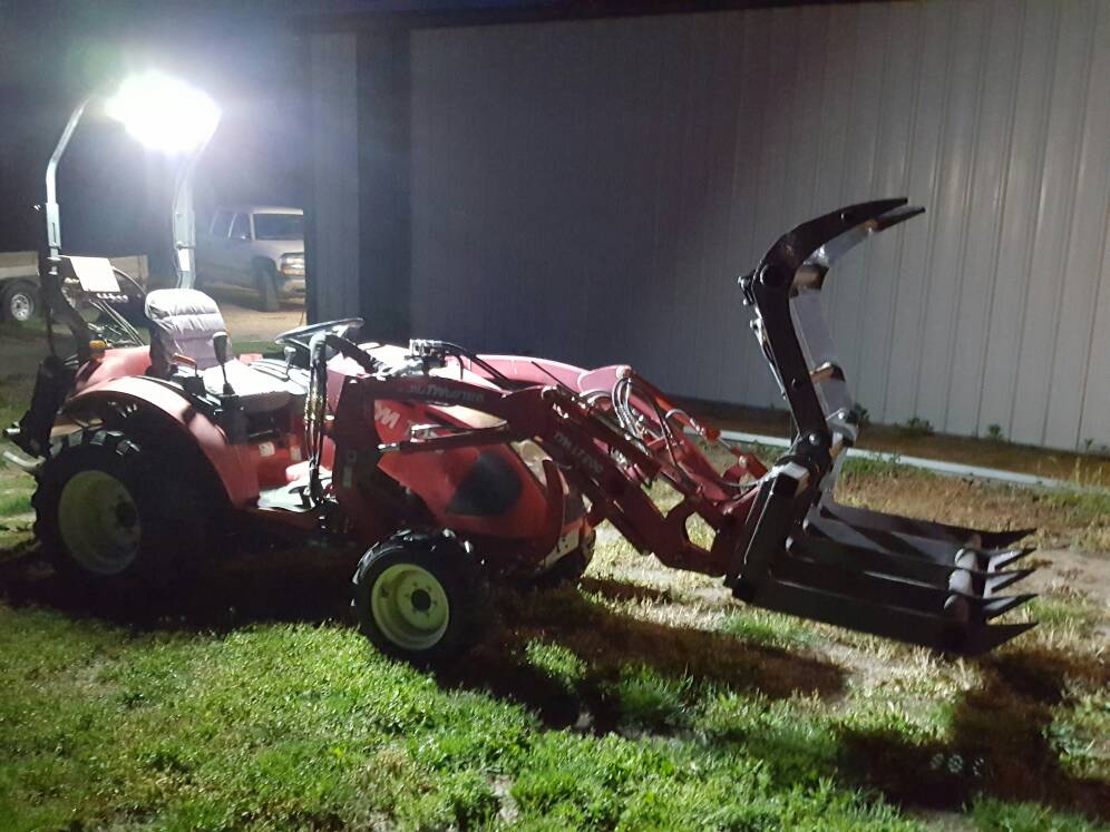

Getting closer to a test run to check things out. Waiting on momentary switch for solenoid valve.

It's alive!
   / What to build? 72ft of 6" wide flat bar #49
Wow! How wide is that opened up?
Haha... I knew someone was going to ask that... all put away for the evening and won't be able to measure until tomorrow.
