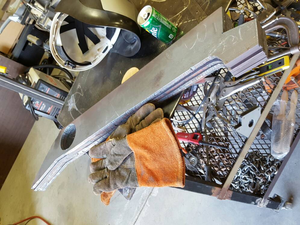

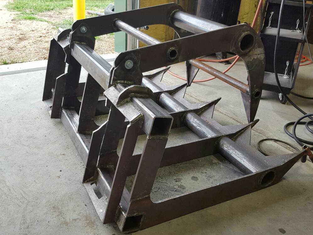

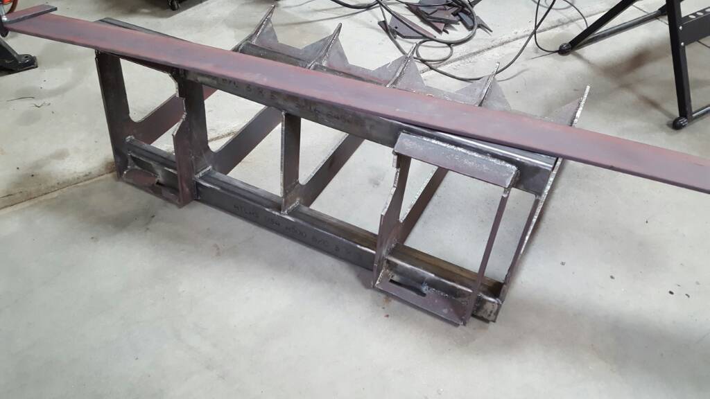

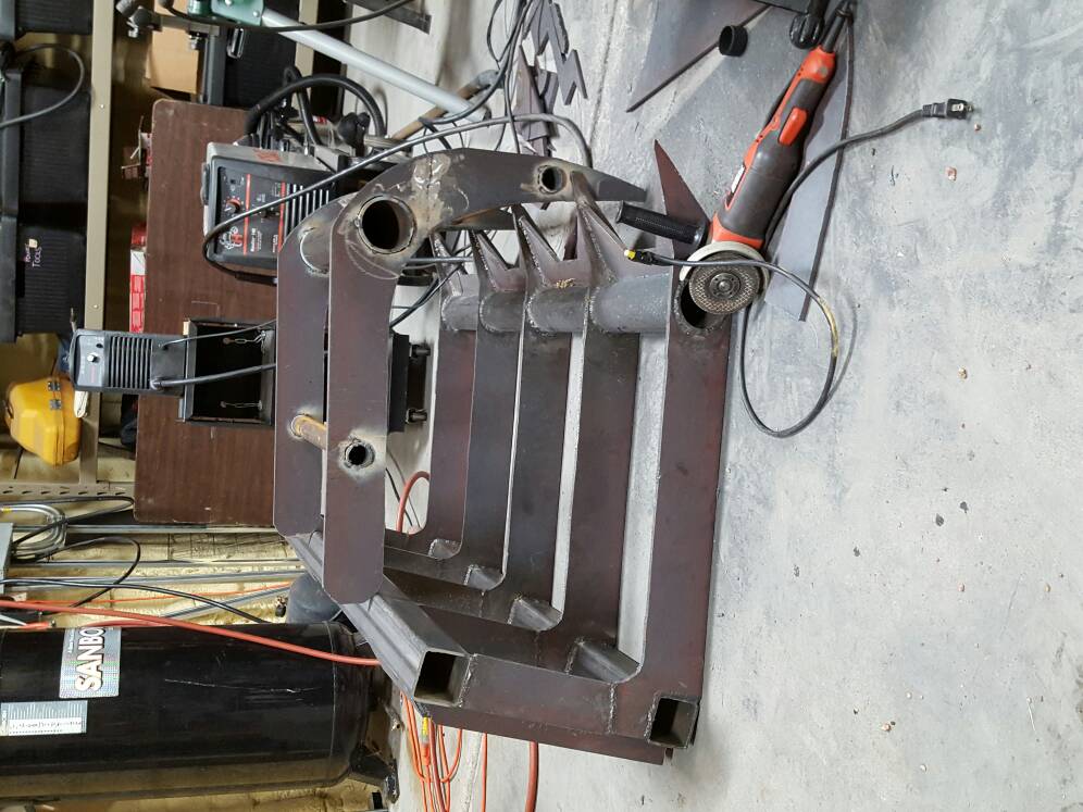

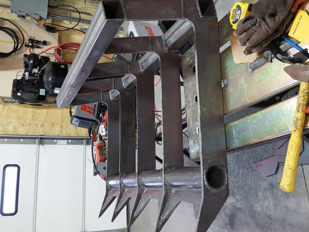

Some pictures of the build. I always forget to take pictures.
uploadfromtaptalk1462243580222.jpguploadfromtaptalk1462243601384.jpguploadfromtaptalk1462243618728.jpguploadfromtaptalk1462243629684.jpguploadfromtaptalk1462243640127.jpguploadfromtaptalk1462243691584.jpguploadfromtaptalk1462243713644.jpguploadfromtaptalk1462243727805.jpguploadfromtaptalk1462243756303.jpg
Sorry about the sideways pictures.
   / What to build? 72ft of 6" wide flat bar #36
Nice job Myyaz33.
I'm confused by the small half round discs welded between the SSQA mount and the top tube. What are those for?
#37
Nice job Myyaz33.
Just a gusset for additional support for the center of the ssqa.
   / What to build? 72ft of 6" wide flat bar #38
Never seen that before. I'd think that a full fillet weld across the top of the SSQA (as well as on the bottom) to the top tube would be strong enough.
#39
I got the idea from another build here on tbn. Some have it, some dont. Have no idea if it was necessary, but I didn't want to find out.
   / What to build? 72ft of 6" wide flat bar #40
Understood. I'd say it is unnecessary though as standard buckets don't need more than the fillet and most grapples don't either. Never heard of a ssqa being ripped off a grapple. I wonder if what you saw on other grapple builds was the cleat for attaching one of the upper jaws on a double jaw grapple or on a very wide jaw single. Certainly no harm in having the extra gusset but I'm pretty sure it isn't necessary.
