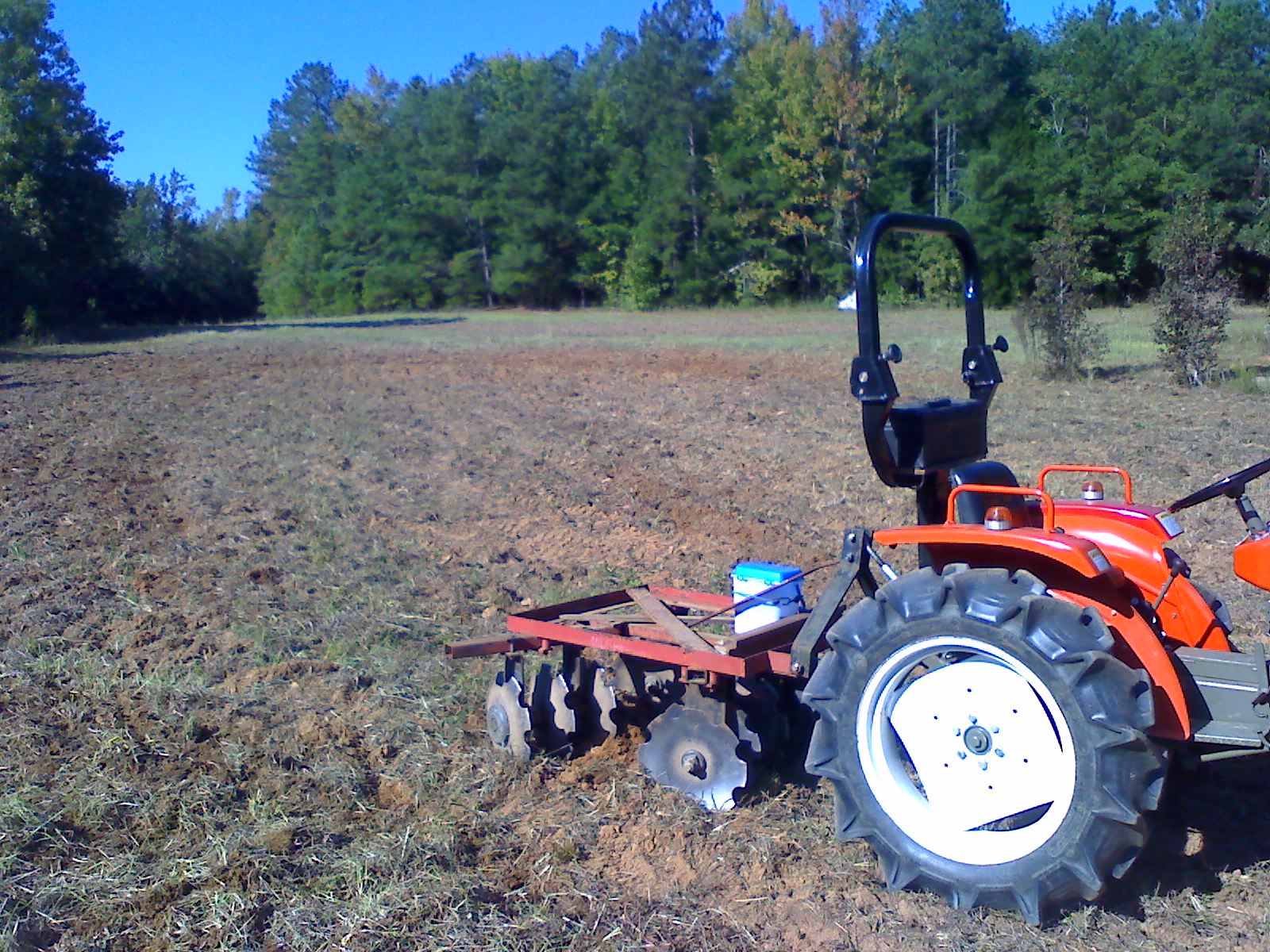

Here is my tractor and my disk that i bought. It is a 12 disk harrow with 16" disks LMC brand. The ground in the fore ground is not really gone over more than oce, it is at the edge of my food plot and not really where i wanted to disk so it is the point which i raised the disk. The point behind the tractor the dirt is turned over better. I am disking in seed now, which is why there is nothing but those flat stoc pieces on the top, they only weigh about 20lbs a piece, the other weights lighten the front to much to hold the disk up for light passes. The blue/white thing is a bucket type container i put my turnip seed in to throw out.
