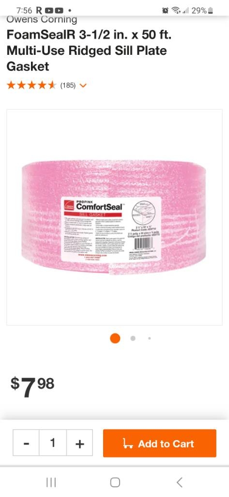

I'll go against the grain on this; its a post and beam Car port, it's not going to be dried in (atleast in my mind, car port means just a roof and posts). It's never going to be dry, and I would just use PT above ground 2x4s as the purlions. If you're worried about the pressure treated wood corroding the metal, you could lay a layer of Sole Seal thing foam directly over the purlion to provide separation between the roofing metal and the purlion. It's cheap, comes in long rolls, and is easily stapled on top of the purlion before the metal is attached. If you already have milled the purlions, or just prefer to not use the PT 2x4s, you could still staple (or button cap nail) the sole seal to the top.

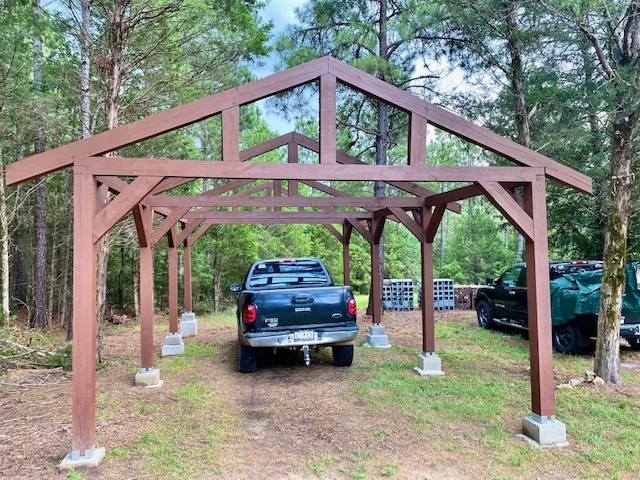

I am building a post and beam, open carport down at my cabin. It is shown below. I will use 2x4 (actual) purlins. It will have a 5v crimp metal roofing.
My much larger tractor shed that i built about 15 years ago has the same metal roof set up; metal on purlins. When the conditions are right water condenses on the underside of the roof and it practically rains under there. This is causing the purlins to be moldy and they'll eventually rot (although I'll be tearing it down before long to make room for a shop).
Anyway, I'd prefer not to have this condensation problem. My initial thought was to use 1" thick boards as 'sheathing'. I have a sawmill and have plenty of it. So the sheathing would sit on the purlins, then tar paper on top of sheathing then the metal roof. Some folks have suggested that there would still be a condensation problem and the 1" pine boards would rot.
I've thought about OSB sheathing but it would be ugly from the underside and probably also rot if the boards would.
So I'm looking at the insulating stuff used in this capacity. Usually white from what I've seen. Sometimes silver. I don't know how much it costs or how to install it. I don't know how well it would hold up over time either. I've seen barns and sheds with it hanging down in tatters and I don't want that.
I am looking for any thoughts or recommendations on this issue.

Was the previous shed walls close? I wouldn't put anything other then planks under the metal roof... I can't see condensation happening if there is no walls to trap the humidity in and if you put something below the metal and its water proof condensation will happen on it regardless putting anything underneath is a waist of money ... and why would you spend the money to sheet it with plywood if you put metal on it ? ... makes no sense.
Your rafters are far apart obviously not complete or no updated picture, you will have to have to ridge beam and more 2x6 or what ever you will install then planks at 12 to 16 inch and the metal...
this is mine ... 2x4 then planks
this is the only thing I put under at the peak ... in your case you would only need it for the cap.
online exemples ... over board with the planks on the first one but you get the idea.

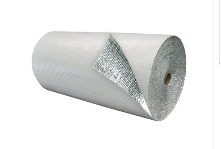

Use the bubble stuff. I've used it for years and it's still good. On open sheds too. That shed over the pickup has bubble wrap insulation from years ago. The main shop has fiberglass vinyl roll and chicken wire under it.
Great to hear the bubble wrap is great insulation, too!
