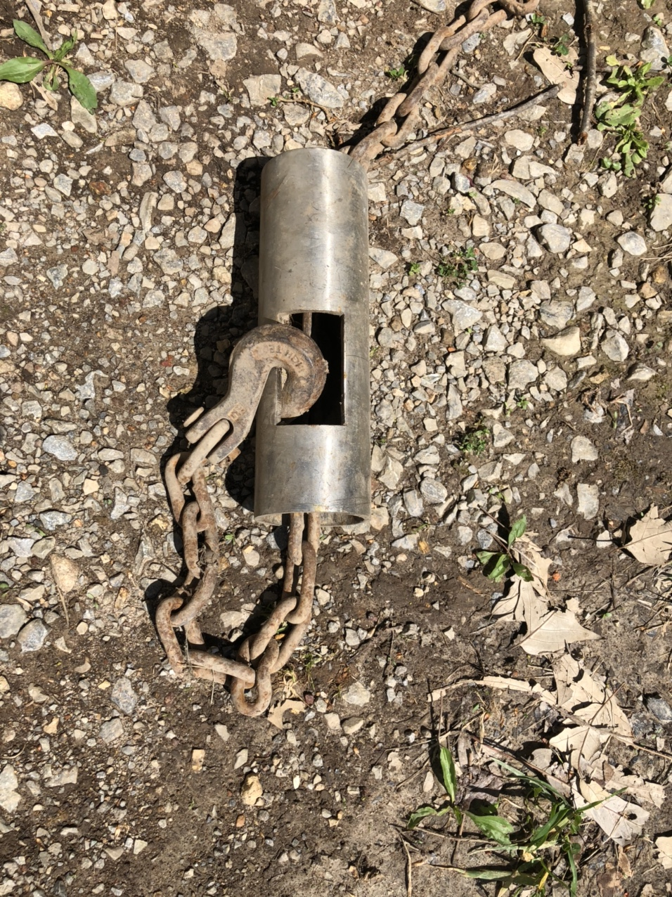

A pin/bolt shackle sized to fit your draw bar hole, and a 1/2 diameter logging choker is a great combination for this. The choker will tighten up and not slip off your brush.
   / What to use as a tow chain? #12
Bark on stems is loose and slippery this time of year. The pipe helps bite and choke the load. Want to pull out of the ground not skin or break off. Usually use two on each end of chain to pull multiple clumps. Easy to hook and release. Wife approved.

   / What to use as a tow chain? #17
These work very well
