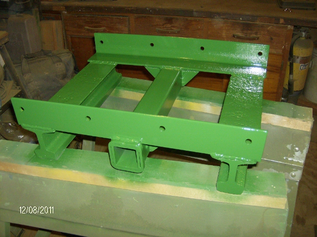

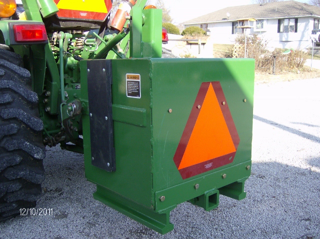

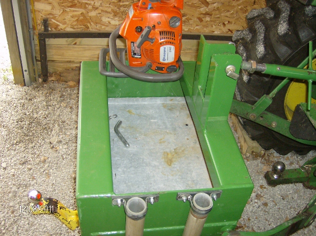

I found a JD box on CL for a good price, modified t to fit my needs. Scrap iron inside, galvanized tray (old grainery door) above the iron, chain saw sheath on one side & 2-tool tubes on the other. RR rail skids with 2" receiver tube for light towing. Have put in another set of 3-pt pins 5" lower to avoid digging-in when loading on my trailer. ~~ grnspot

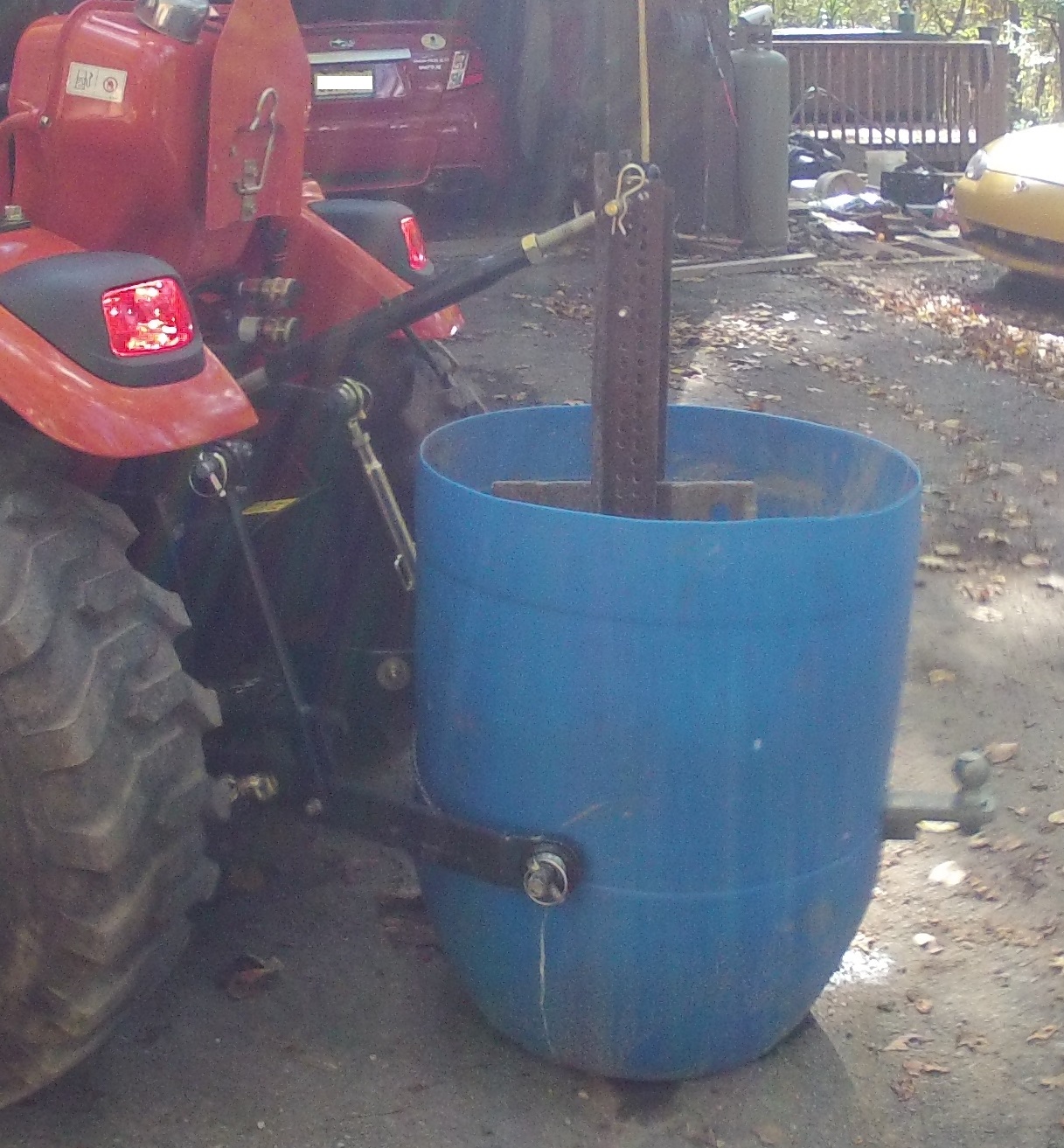

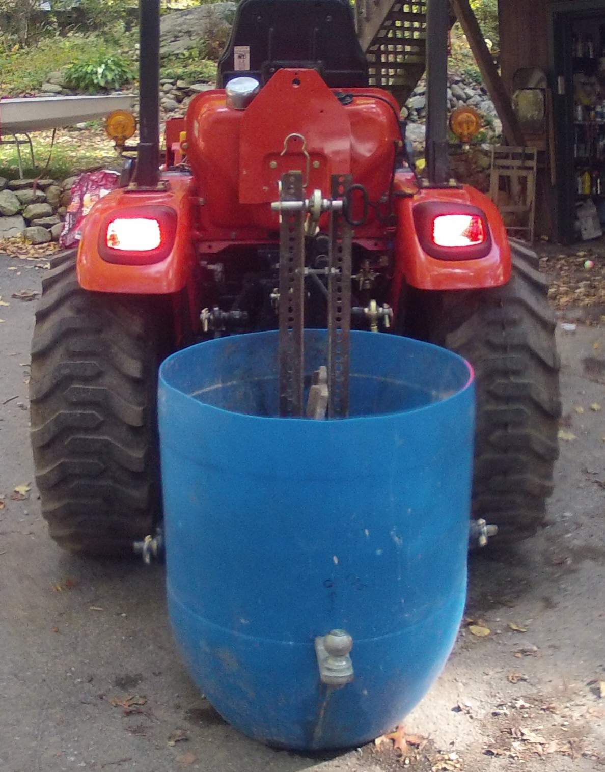

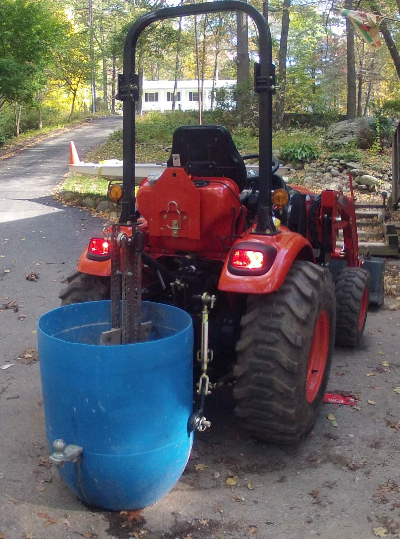

GOPR2003.JPG My ballast bucket. About 650 lbs with room for more and tools/chain.
GOPR2004.jpg I imbedded a hitch to move the trailers & log splitter
