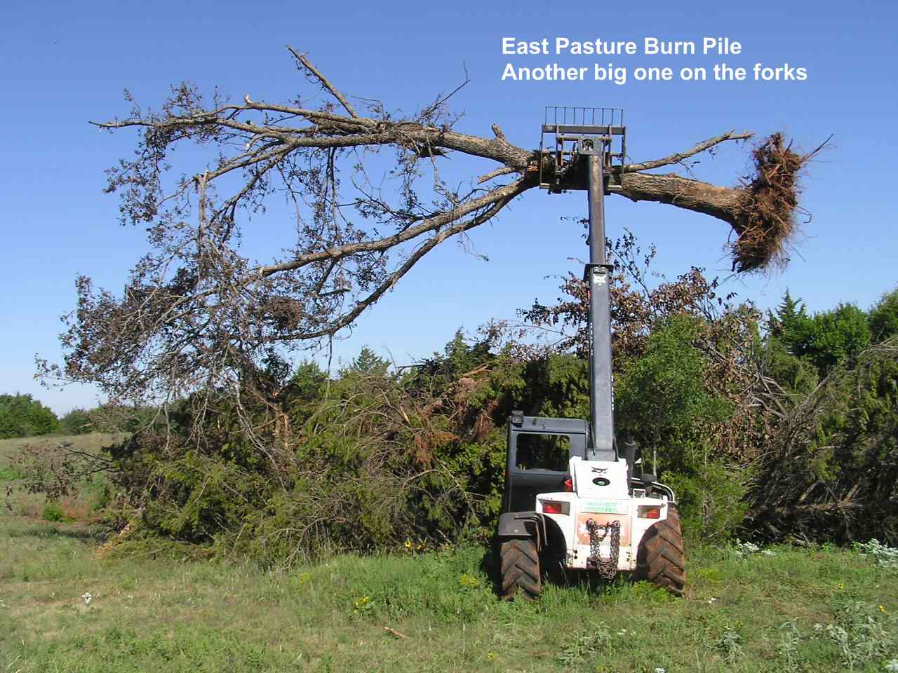

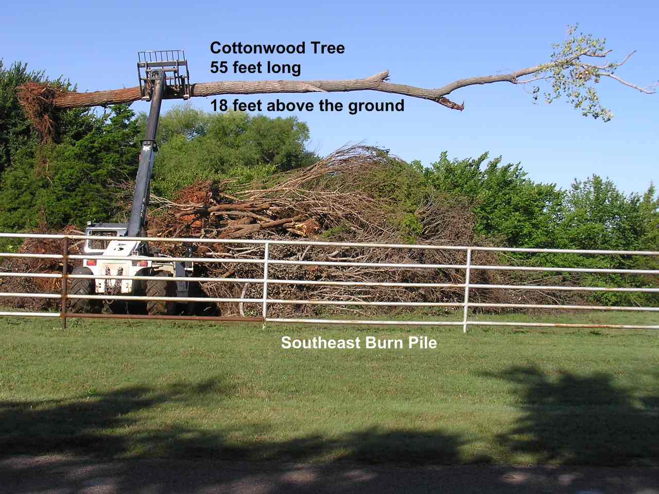

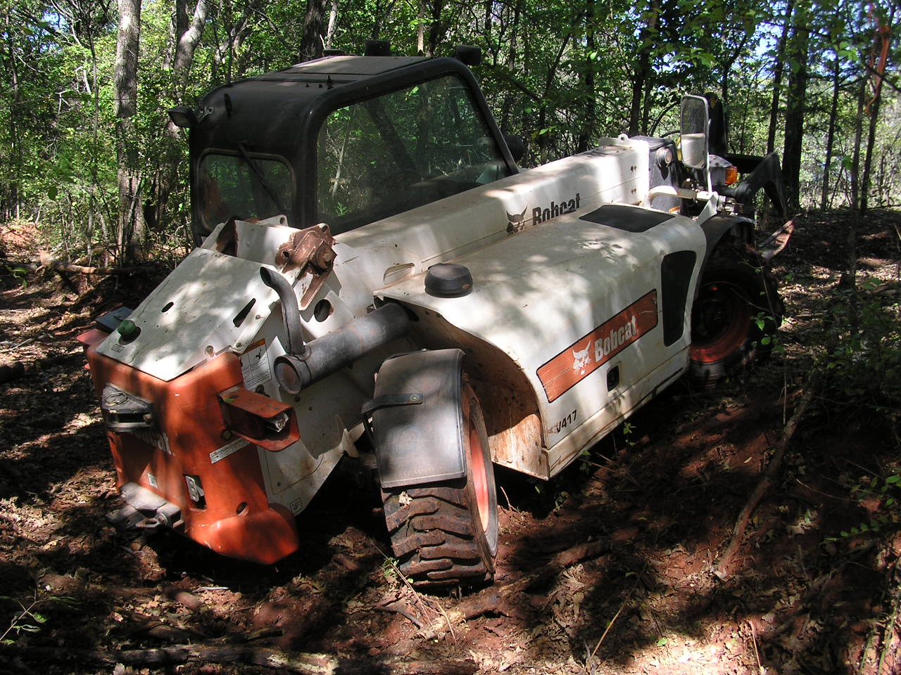

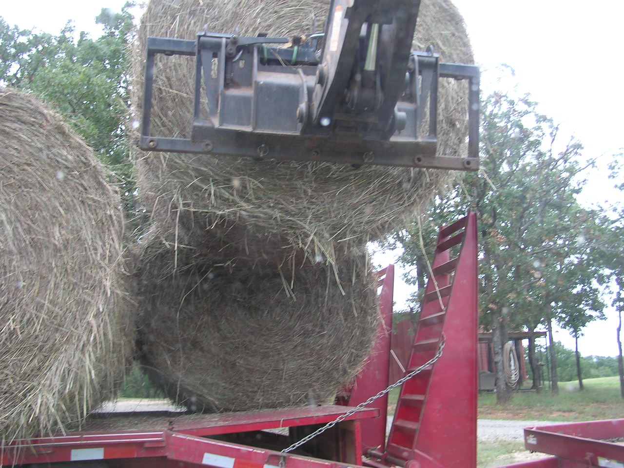

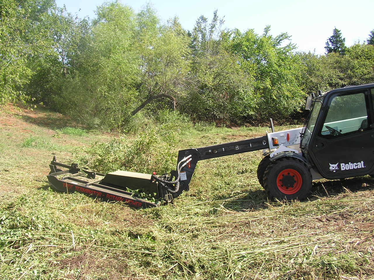

Get a compact telehandler with SSQA: https://www.tractorbynet.com/forums...pact-telehandler-post3243370.html#post3243370
Unloading 5x6 bales from a 12 foot long trailer:
View from the seat, it can unload all bales from one side of the deckover trailer:
The 7 foot brush hog:
4x4 and 4 wheel steer let it get around in the woods:
Moving dirt with the 6 foot wide 1 cubic yard bucket:

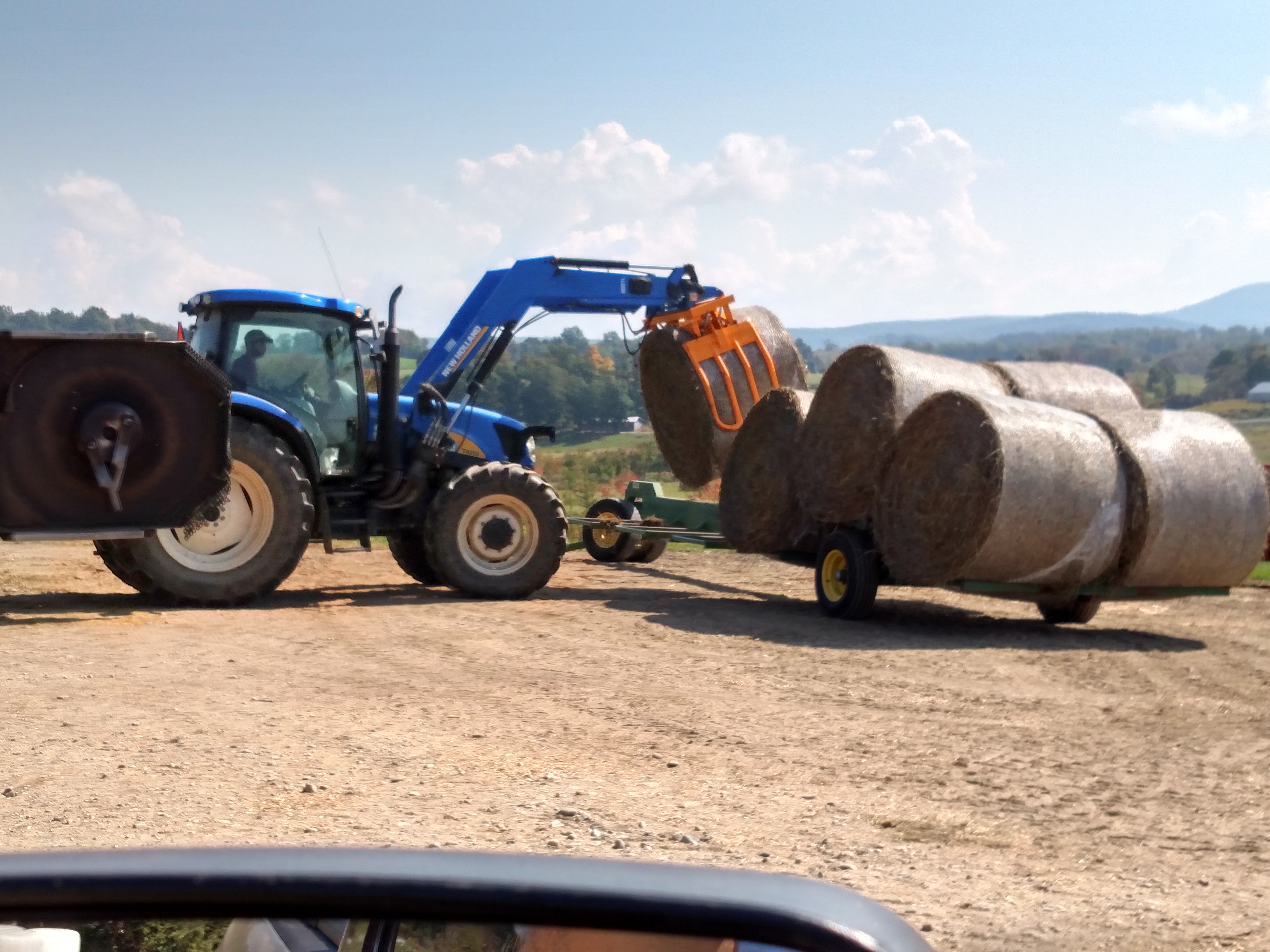

We use a squeeze bale grapple to handle our round bales,
many of ours are silage bales which can get quite heavy and if you pierce a hole in the wrapping you just wasted that time and expense and the cost of that bale.
It also allows us to set a bale in a feeder or feed wagon
That is 125 hp tractor handling bales,
can it be done with less?, yes it can and has been done with less.
Throw in mud and ruts a few side hills, maybe hurrying for weather or just to get done.
Then if stacking 2 or 3 high the larger the easier and safer most of the time.
