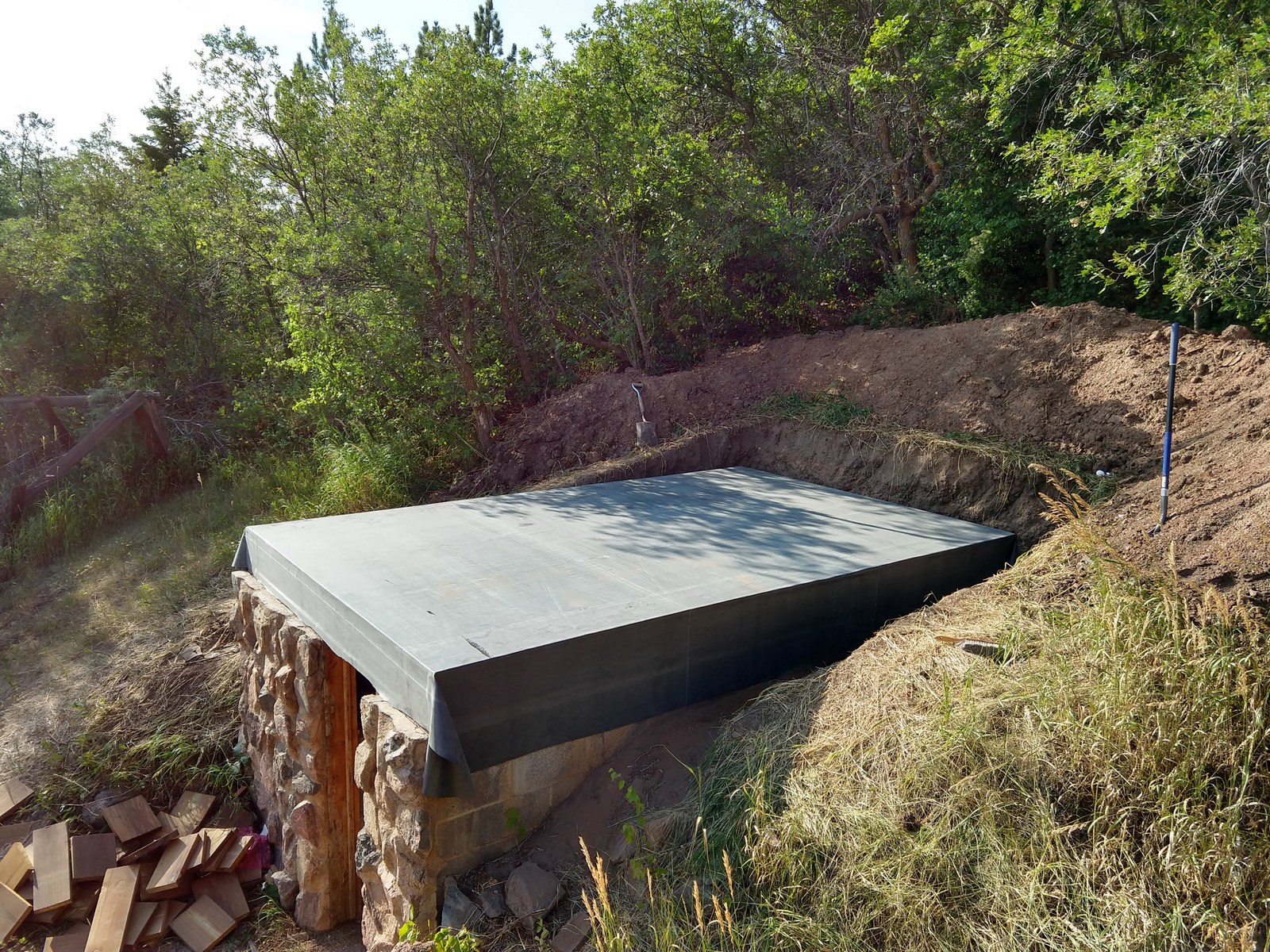

No idea on the size of roofing rubber you ordered but hopefully its large enough to go down the sides a bit past the wood beams.

I overlapped the EPDM below the wood structure by about a foot

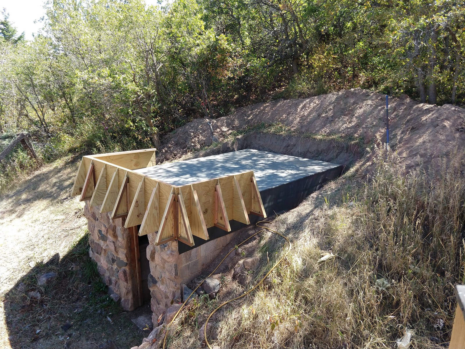

Building out the roof structure.

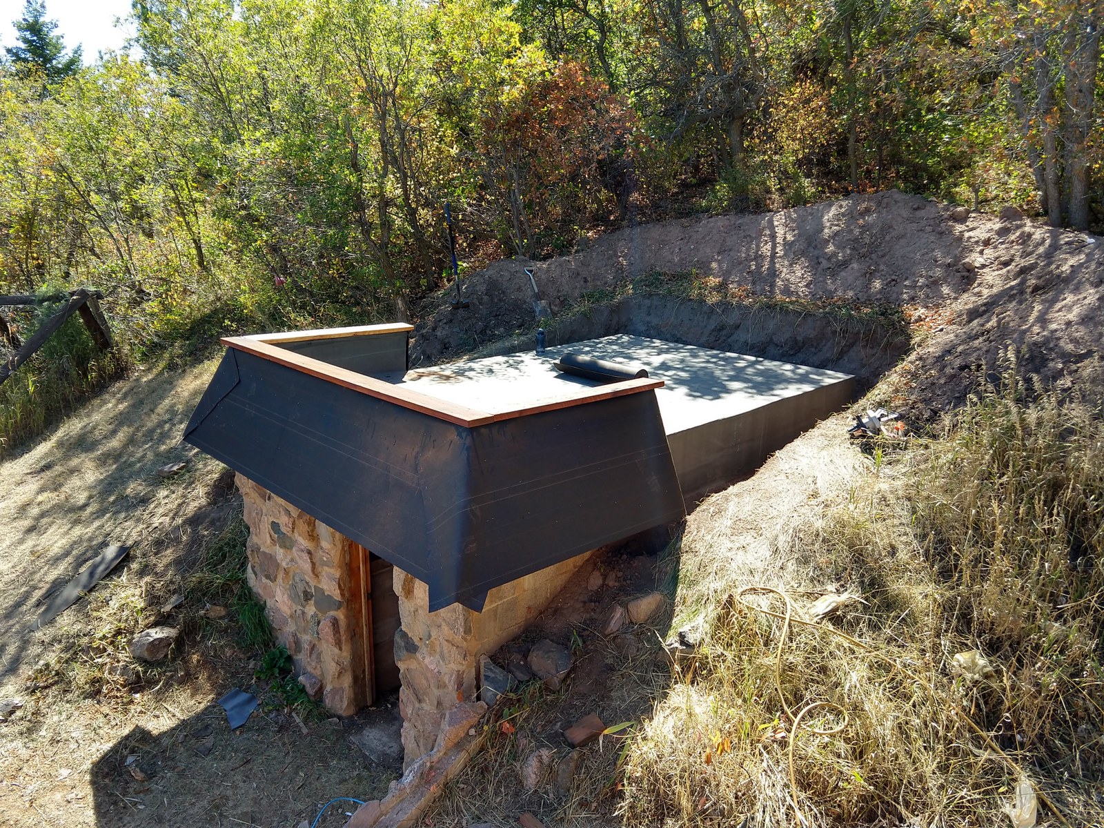

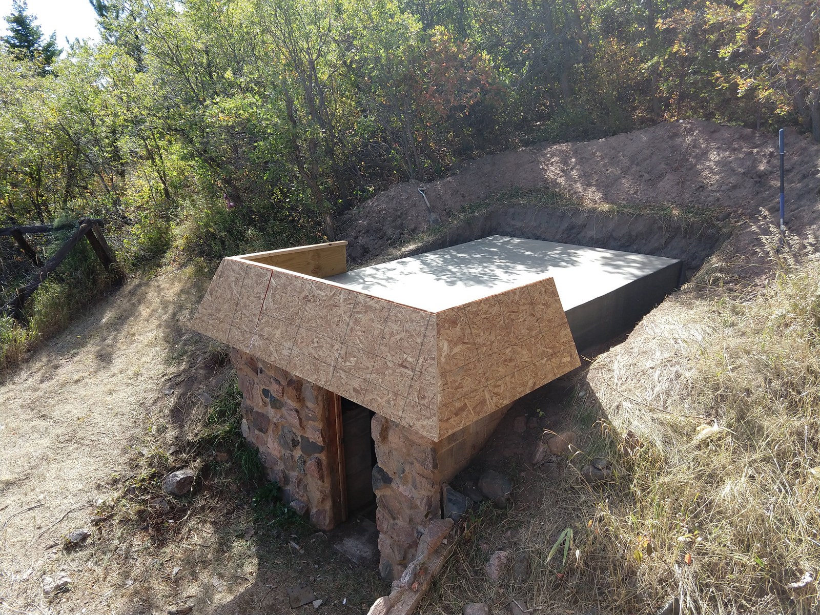

I wrapped the inside of the roof structure with leftover EPDM, the front was wrapped in tar paper. The top is a hunk of redwood I recycled when I repaired my deck a few years ago.

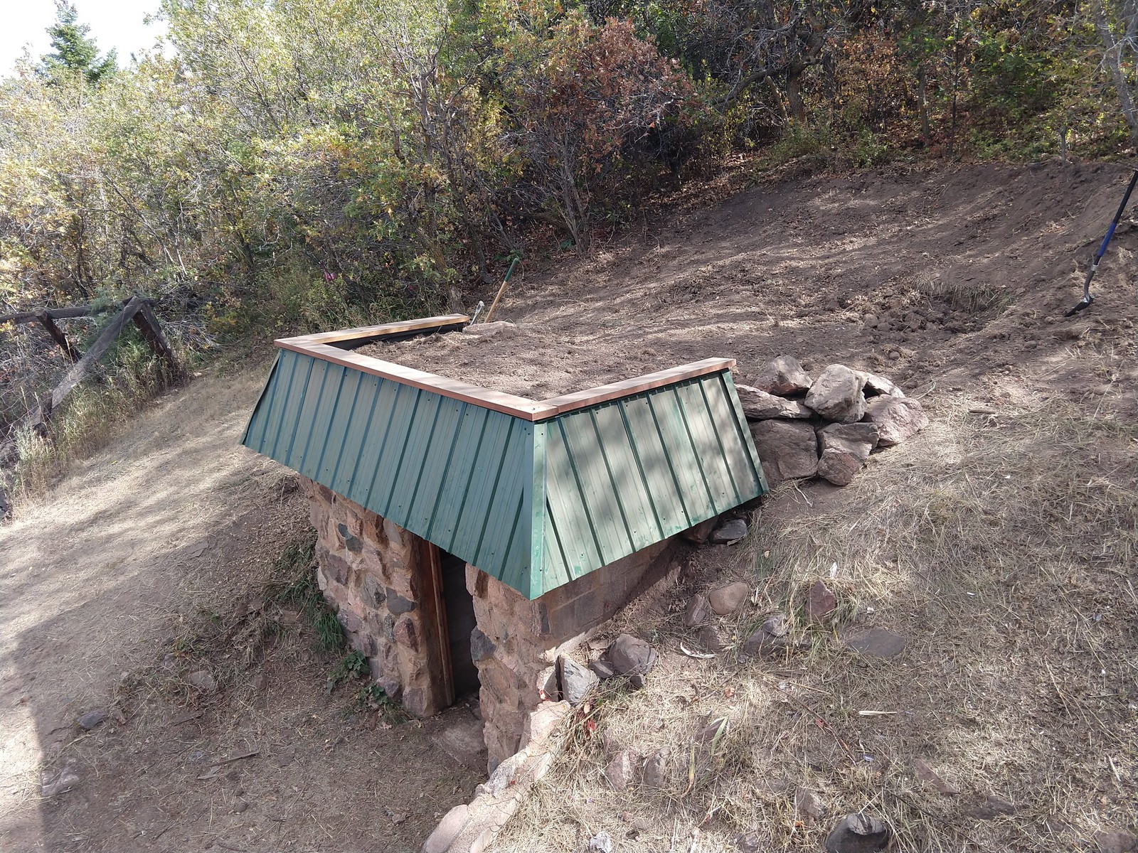

Almost done putting the dirt back on, my back is sore. I originally wanted cedar shingles but they were a stupid price so I just went with metal.

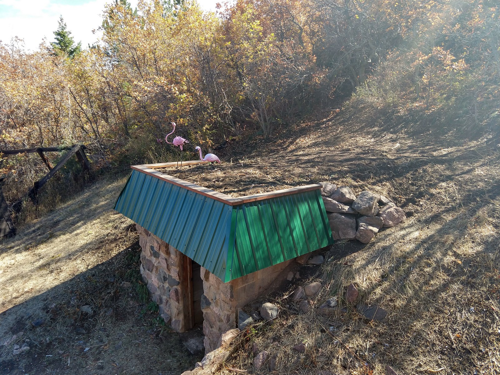

The flamingos are back where they belong, all is right with the world.

Herlig - you finished that project up very nicely. Once the grass reestablishes itself - lawn chairs - and fine homemade wine.
BTW - that very bottom picture - - be certain you close the door. Local wildlife might enjoy the new digs also.
