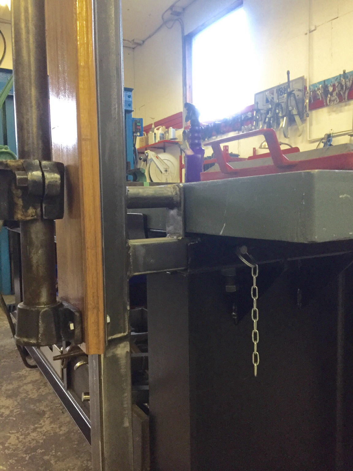

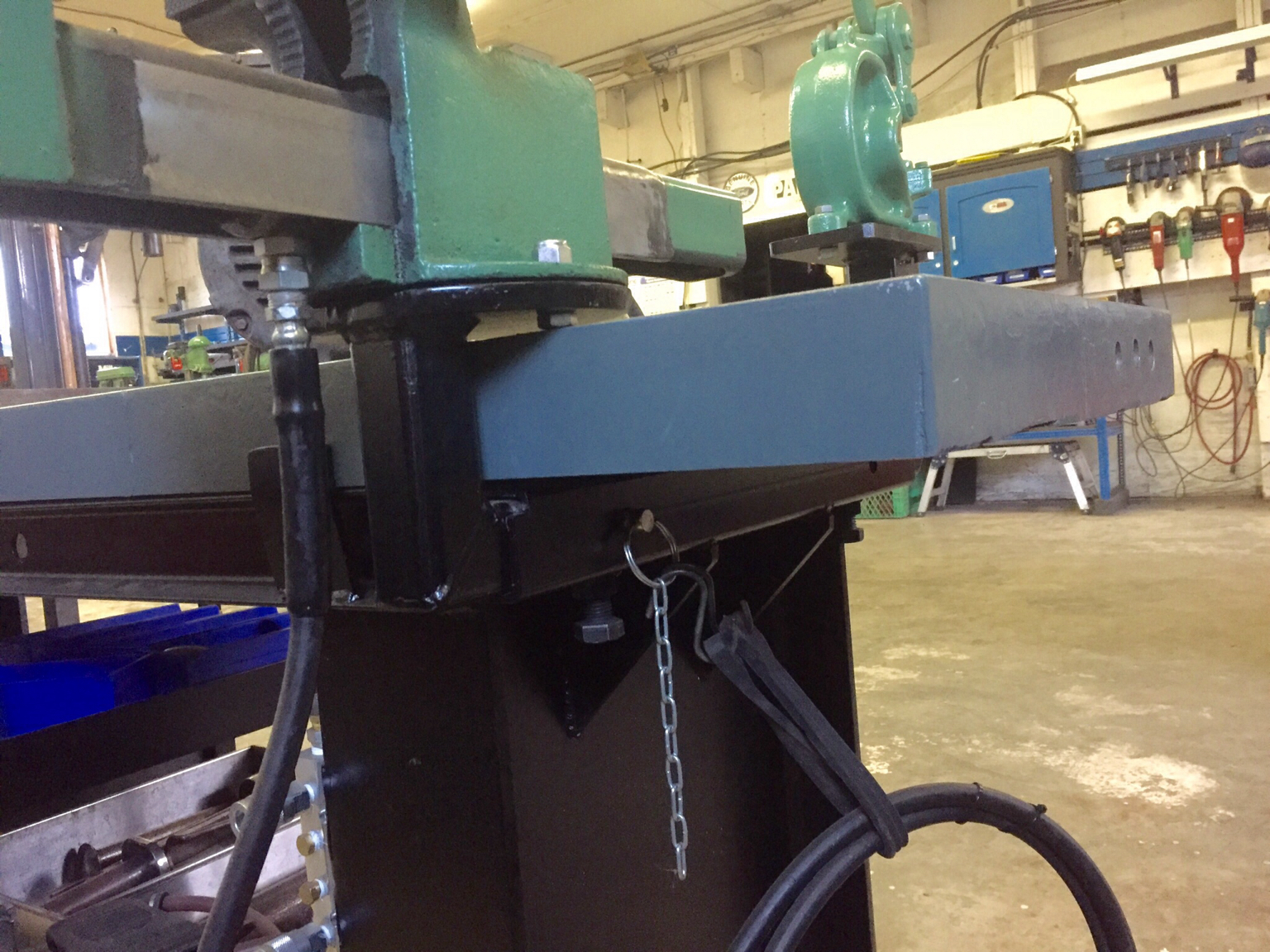

Not certain how your table is configured, but if possible, it may be better to weld your receiver tube(s) to the table frame or legs. This would eliminate any heat distortion to your table top.
Here's 24" lengths of receiver tube welded to my BASE. BukitCase could possibly provide details on "notching" the tops of your receivers to make insertion of your tools easier.
Terry

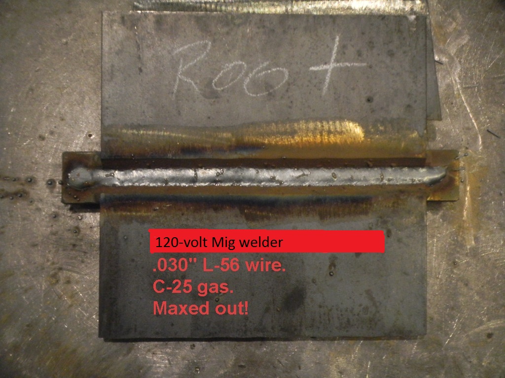

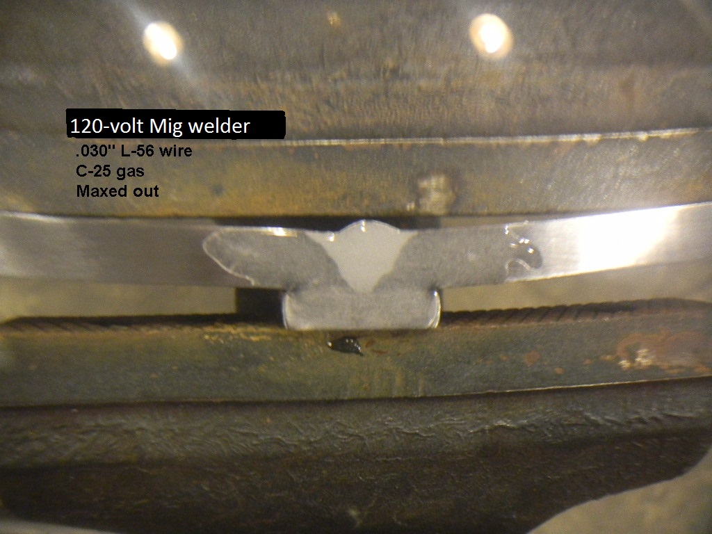

I wouldn't weld hitches with a 120-volt welder! :thumbdown::thumbdown:
