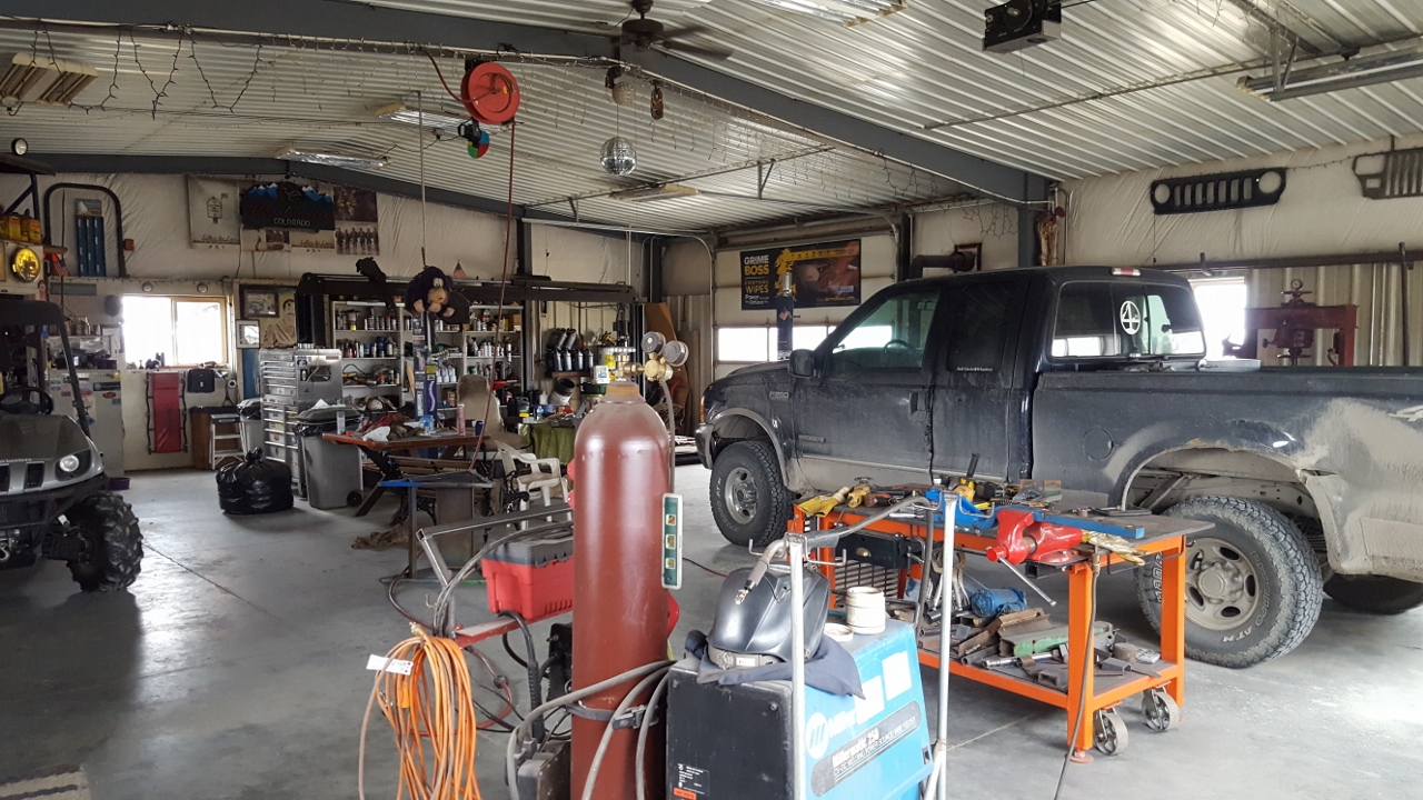

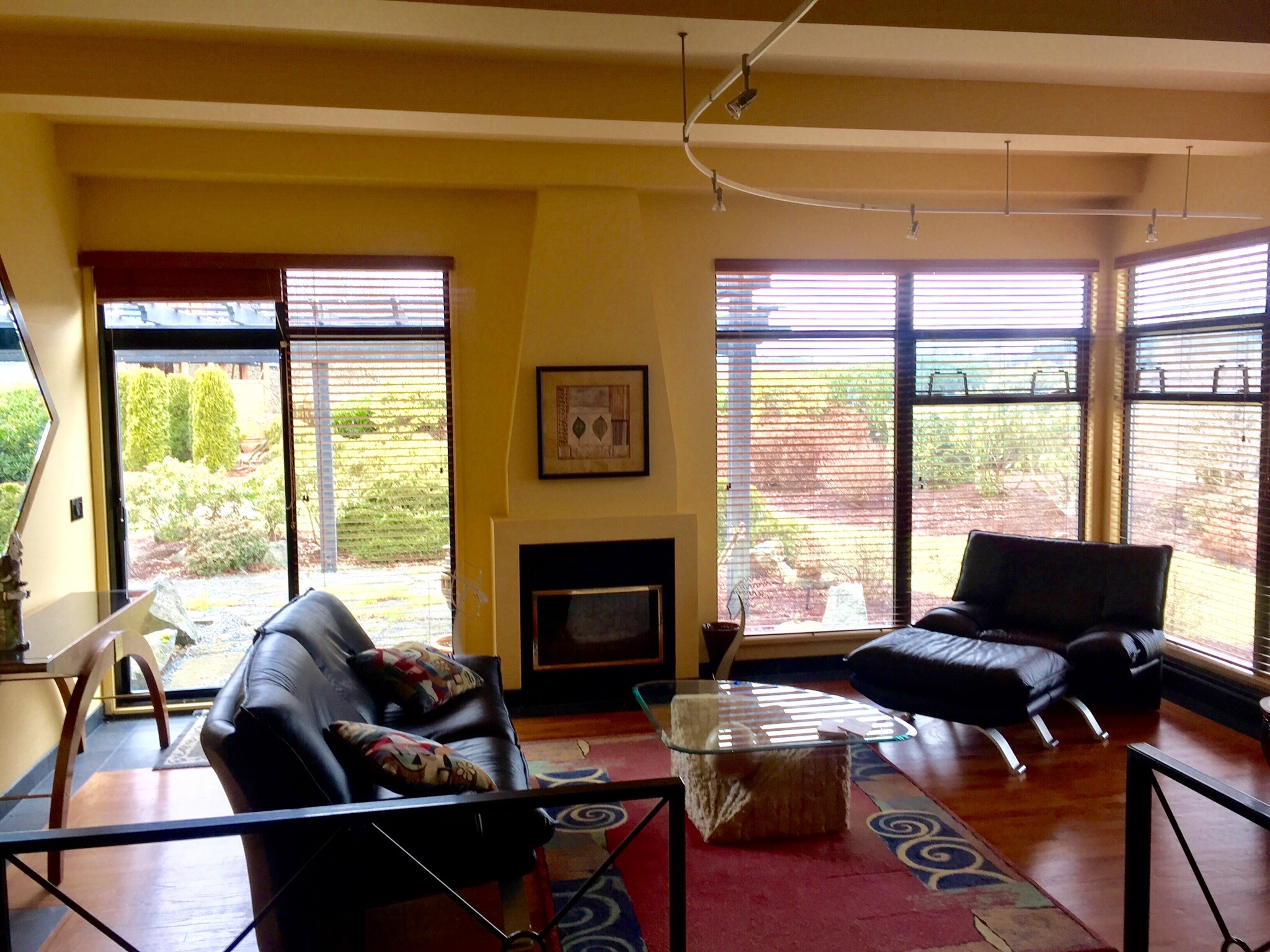

I am "heat" conscious to have no use for skylights anywhere. That's why I mentioned windows, windows, windows. Good quality double glass insulated windows to minimize heat loss.
Here's a pic I just took at 11:30 a.m. on a very cloudy Missouri day with lights off.
Here's a pic I just took of my North facing shop office. Noon, gloomy March day, lights OFF.
