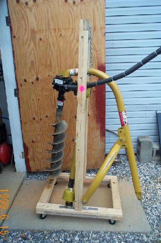

All 2x4's Not counting the wheels its 6 feet tall and 3 feet wide. I made it 30in deep. I used the metal braces on the corners to make it stronger. The wheels are cheep ones that
I got at Home Depot. The back two are fixed and the front ones swivel. It makes it easier to push that way.
I can put on / take off the PHD in less than 5 min. with this. Also, its nice to wheel the PHD back ito its corner out of the way when I am not using it.
It was a good use for some scrap lumber.
Ken

View from the side

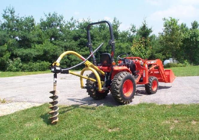

On the B2410

You do nice work Ken! /forums/images/graemlins/wink.gif I never thought about using 2 x 4's but the way you staggered the lengths to get them together looks strong! Nice last name too! /forums/images/graemlins/smile.gif
   / What's the best way to store a Post Hole Digger???
#35
Re: What\'s the best way to store a Post Hole Digge
Ken, thanks very much for the extra shots.... they will come in hand on my next dolly project. I appreciate it.
